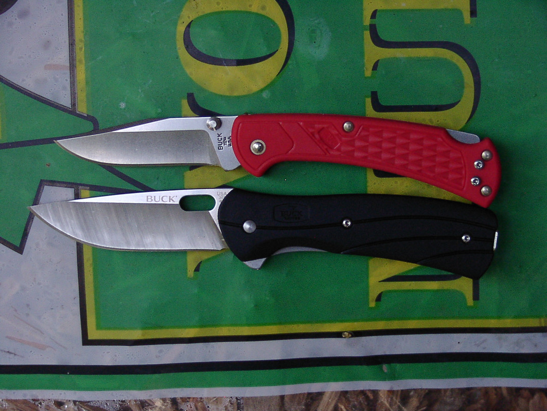

I had the great idea recently to swap the liners of my Large Vantage in 20CV to an older screwed set (rather than pinned). The 20CV blade has 2 washers and is easier to re-assemble with screed liners. And I just prefer them.
Not possible. I tried with an older set of liners. The lock would not engage. Then I tried another set. Nope. Then I tired a modern set of liners. Still won't work. The lock face on the 20CV blade is larger than on the others. Seems odd that Buck would change the machining for the blade and the liners for a small run of knives.
20CV blade is in the middle. FYI, from left to right the blades are S35VN, S30V, 20CV, 13C26, and 420HC.
Nice photo showing the machining differences. As is required during factory assembly, fine tuning the lock interface might be needed. By the sounds of it, the liner is not able to travel onto the tang at all. So you might need to file the blade tang slowly and evenly to achieve the proper lockup. But, by doing so you probably won't be able to put that blade back in its original liner. It would surely have too much travel and late lockup.
Interesting - you're thinking it's a tuning issue. I honestly had not considered that. This is far enough off from the other blades I assumed it was intentionally machined differently. I'd be a little surprised if their manufacturing allowed this much variation.
But if so I could see them having liners with different lock bar lengths to allow for machining differences in the blades (like a small, medium, large situation). I used to work at a tool maker and I get that things change as your tooling gets worn and parts can go out of spec or get to the acceptable margin. Given this was a small run maybe they used older tooling that has some wear? Wild guess on my part.

We made an across the board change to the way we cut our lock surfaces a couple years back. This resulted in a much better lock strength and more consistency in where the liner falls on the lock. Every run is set up to the model we are making to account for variances in materials and blade sizing. There would be a good chance that new lock style would be swappable with new lock styles, but old vs new is a slim chance.

Thanks for the reply and explanation, Jeff. Most of my other Vantages are certainly more than 2 years old, so this all makes sense.

Not sure why the reliefs on the non-420 version. I believe it had to do with not hitting the corner of the wheel that makes the lock surface, but not sure. That doesn't explain why the 420 version does not have it. I think the 2 reliefs on the blades were material marks that never got removed/updated when we changed how we ID the material on raw blades. ymmv

The vantage has divots on the back just above the lock face to id the metal. The holes are in the 110 blade as the back of the 110 is the slip surface for the back spring lock.
