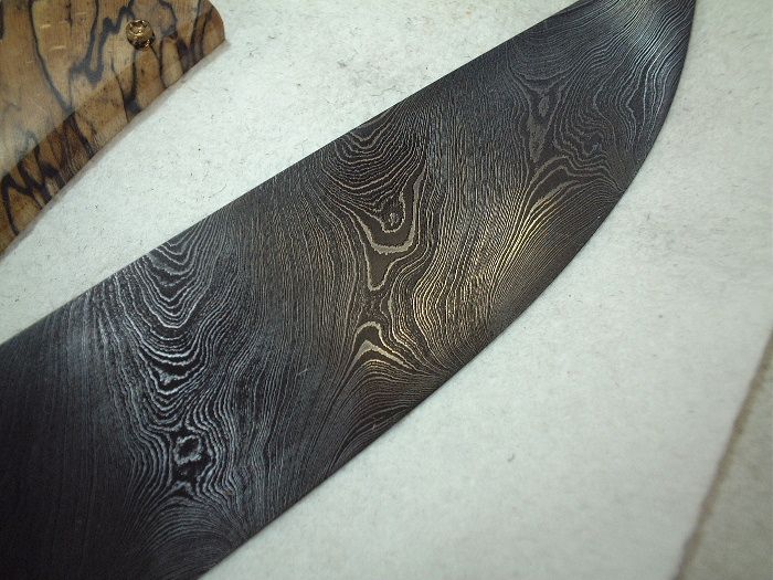

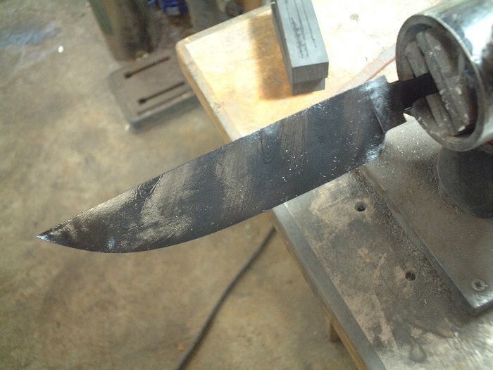

The 7" 1095/15N20 single twist blade out of the hot-bluing tank:
After some 3000 grit sanding to remove the bluing from the 15N20:
The blade with some of Larry's spalted maple:

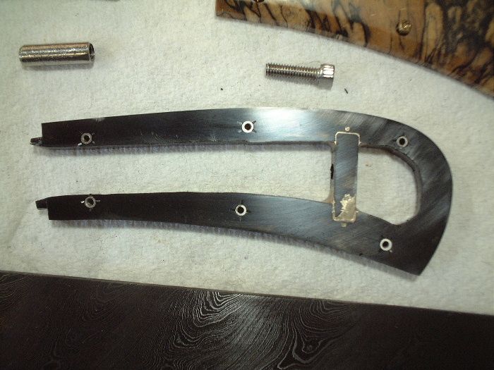

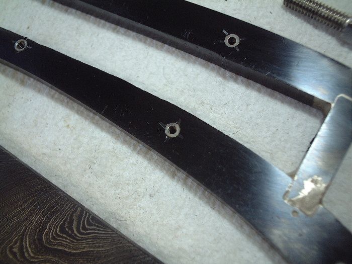

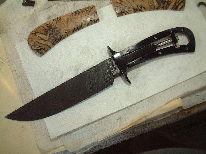

Here's the blued frame showing the threaded 416 inserts I made for the screws. I did NOT want a broken tap in a hole in the frame, so I made these to "key" into the frame:
The entire frame:

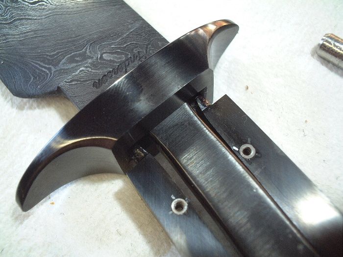

How it locks into the guard - thanks to Bruce Bumps WIP:

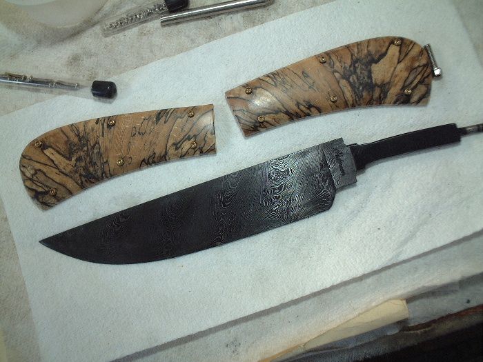

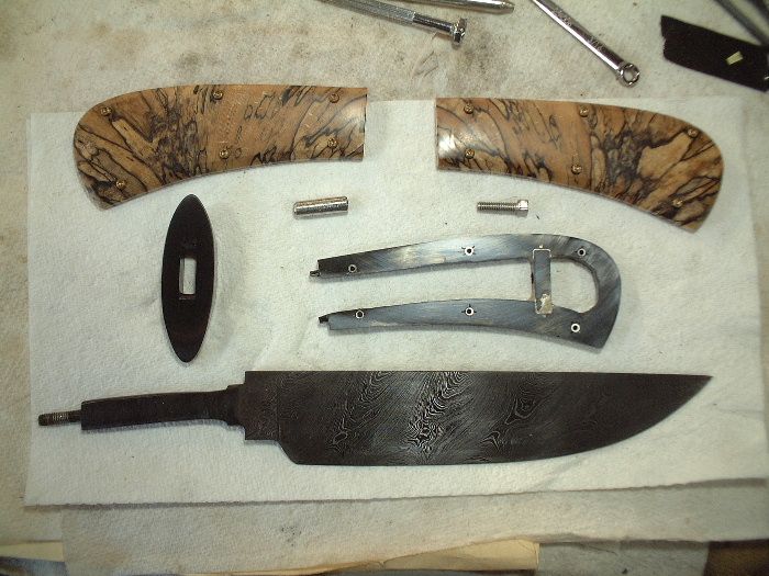

All of the components:
Assembly showing the "Andersen Bridge" silver brazed into place doing what it does.

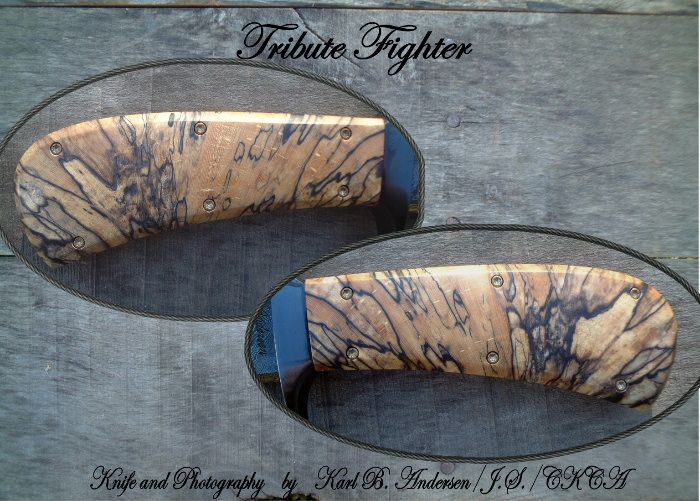

And finally, the knife, with what is the next to last piece of Spalted Maple I have from Larry.
