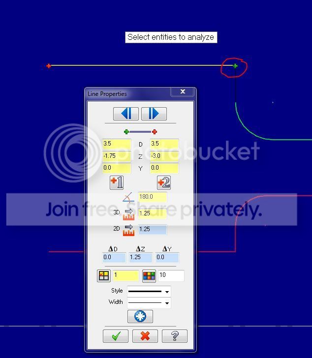

Here is an example in MasterCAM - analyze geometry, you would read the values with a high decimal resolution of. It doesn't matter how much you zoom in, if they are off, they are off.
It could be that your native CorelDraw geometry is not as clean as it should be? Do you have a chained contiguous geometry profile in Corel Draw before you export?
