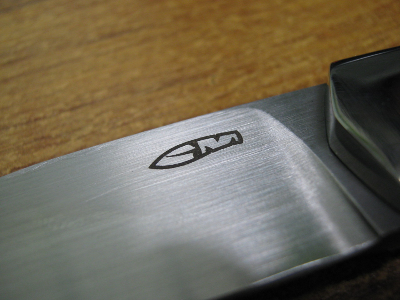

I've had the opportunity to use a laser engraving machine on some of my knives. I really love the result. I've found many advantages:
- The size of the mark can be adjusted to the surface you have
- You can adjust the depth of engraving with the same precision
- The thickness of the spot is arround 0.04mm if I remember well so you can have very sharp forms on you mark.
- You can mark any material (as far as I know.) (except translucent materials witch need CO2)
On the exemple below the overall length of the mark is 9mm
