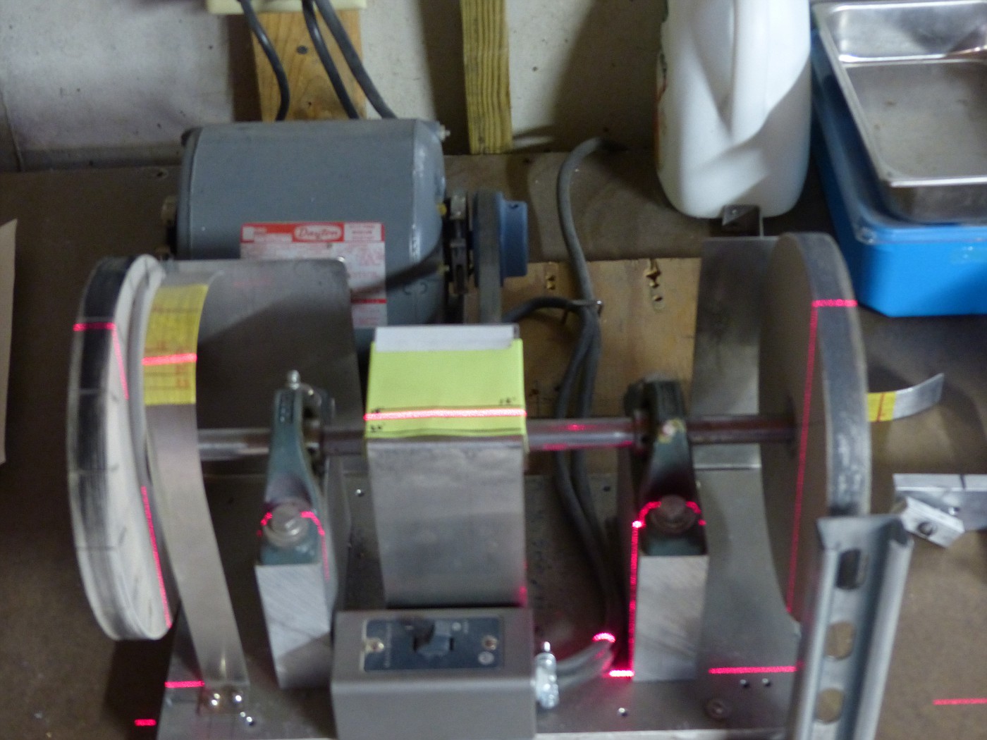

I use a laser on my belt grinder to provide a reference line for grinding. It is mounted on a camera tripod with a level for setting accuracy. I will try to post a picture later. The laser hits the wheel at an angle and that angle is reflected if it hits the blade.

He is a set up I made about 4 years ago. I have since added the laser. The guard over the belt has the degrees marked for the laser. Just rotate the laser to what angle you want. It takes seconds. You can adjust the speed by the pulley sizes you install.

What laser are you using here. Brand and model?

Looks like mine... It's a Black and Decker BDL220S
I am obviously missing something here. This laser shoots a straight line like you can see in the pictures below. Aiming it down like in the picture above (using it with the grinder) would seem to produce a dot on top of the grinder. Seems that to get a line spanning across the grinder the laser would need to be mounted to the side? What am I missing?
Point the laser down and turn it 90 degrees.... it's now a line running across. ( If it's not against a wall it goes both ways).
