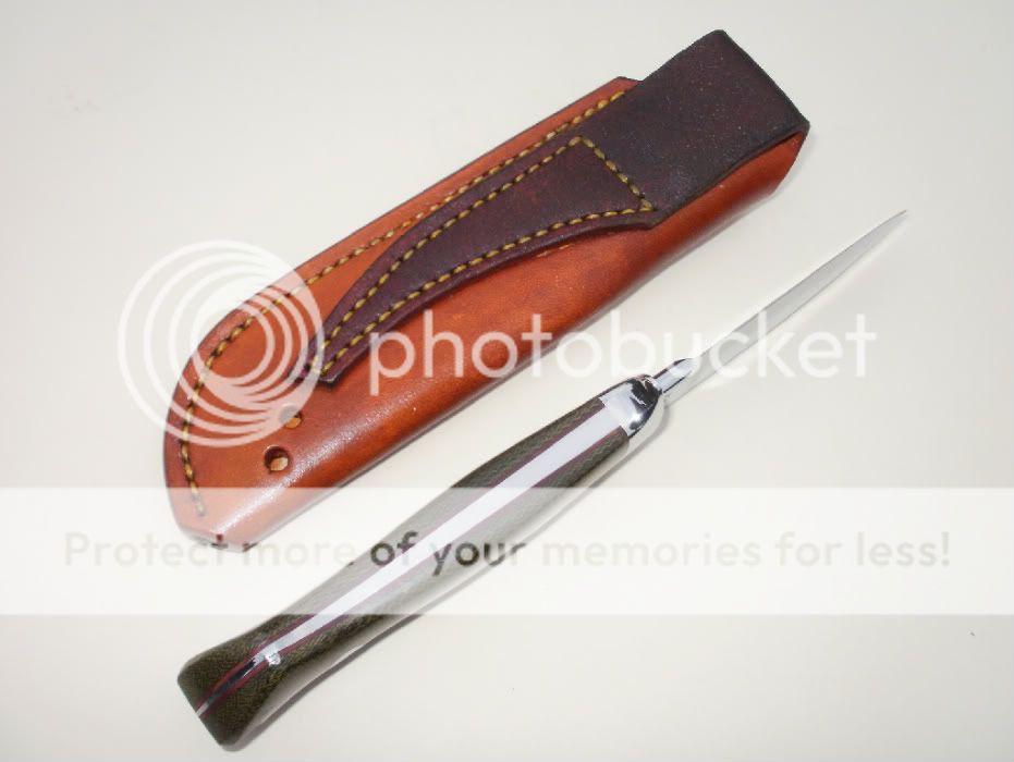

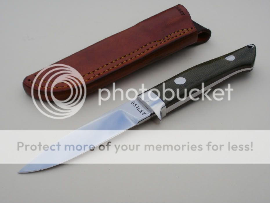

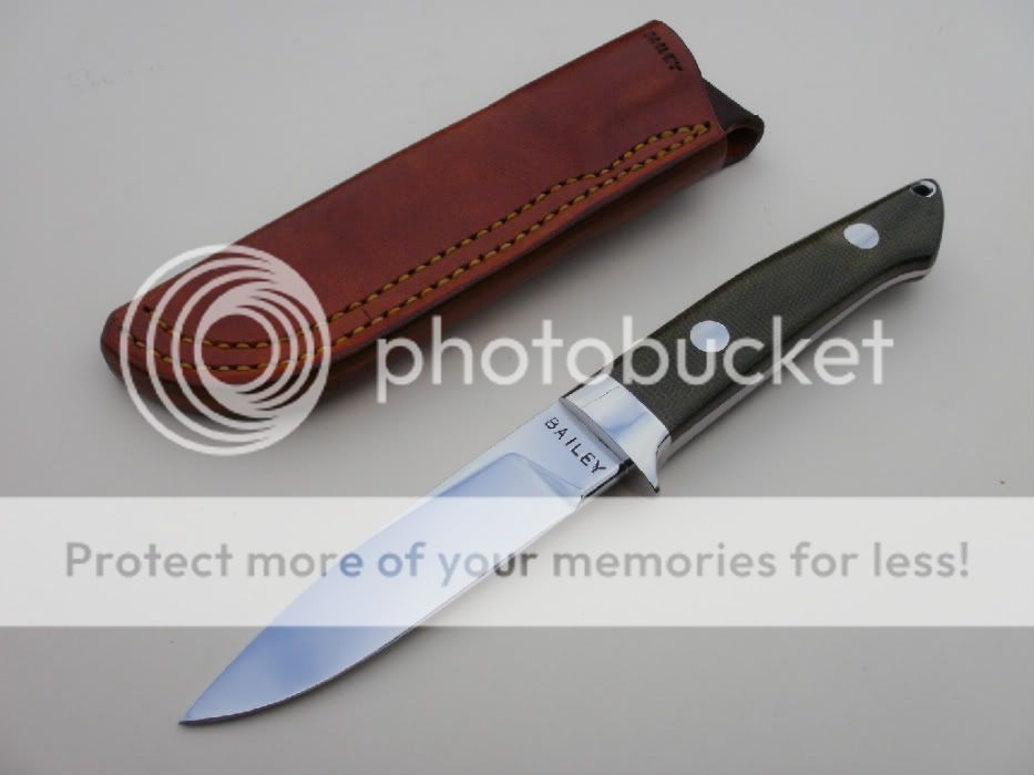

Thought I'd share with you one of my last knives of 2010.
It's a slimmed down dropped hunter, with a 3 3/4" 1095 blade, green canvas Micarta handle and red fibre liners on a tapered tang. Fittings are 303 stainless.
I also decided to make the sheath nearer to the original Loveless design...not sure why, I guess I just fancied a change!
As always, all comments, good and bad are welcome.:)
Thanks for looking.
Ian
That looks great, nice job. I like a bolster on a knife, just puts a nice finished polish on it.
What, not specific to your knife, is the concept of a tapered tang? Is it a balance thing or just cosmetic?
Thanks for taking time to look and comment, it's very much appreciated.:thumbup:
Kingsqueak, as you rightly said, the tapered tang is there to reduce weight..although I like them just as much purely from an asthetic point of view. I think it makes the knife look more interesting than a parallel tang.

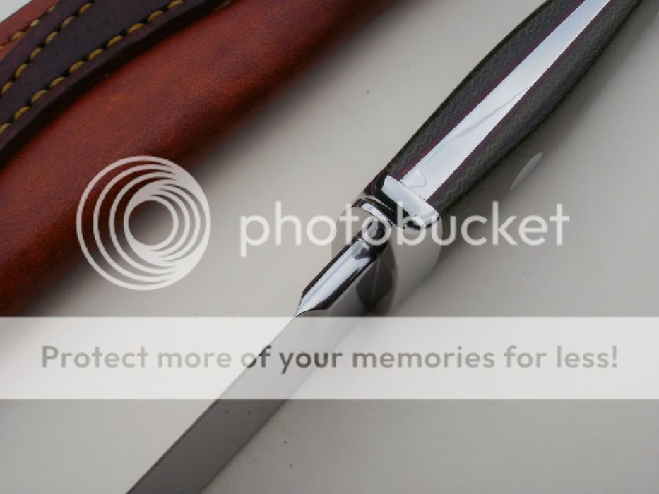

Both your grinds (nice plunge lines) and the leatherwork are getting better with each knife. :)

Handle swell looking very nice as is your tapered tang/liners.
Besides that taper tang reducing weight do it because it looks right and
even more that you can do it right. ;)
