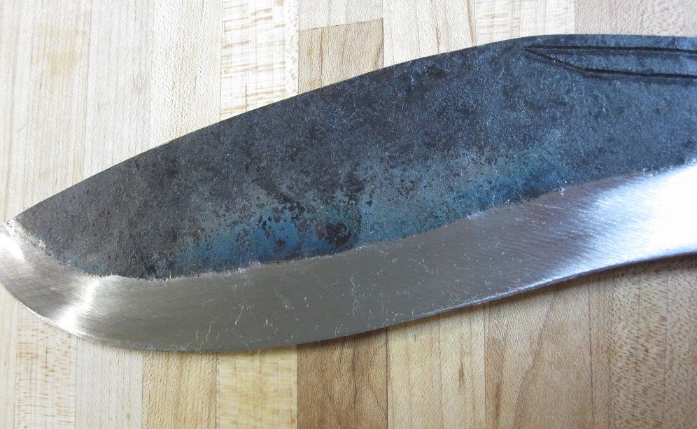

I just finished cleaning up my KLVUK a bit and noticed the craziest thing. There is a greenish blue tint under the forge scale on one side of the blade. I can't get a very good photo but here is the best I could do. No color filter trickery here. It is wild in person.

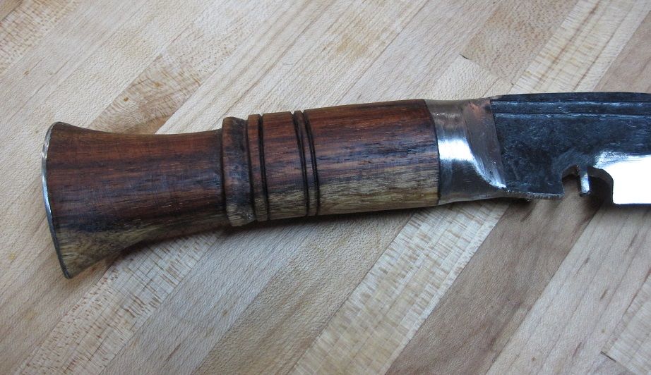

Also worked on the handle a bit. A very light sanding at 220 grit, several coats of pure tung oil and lots of hand polishing. I wanted to keep some of the "rough" look to it.
Its likely just the color of steel reflecting the differential hardening. Carbon steel will be blue to purple color when tempered to spring characteristics. The harder straw yellow color will be near the edge which is ground off so that seems to make sense to me. Its just a surface oxidation. Some of them expert knifemakers could probably tell ya more but thats what makes sense to me. Looks good! How did ya remove the scale? Acid?
Just like ndoghouse said steel is very amazing when tempered, you can get it to be blood red or purple, blue etc. it's quite amazing what forging it can do. I've heard that if you ruin the temper on a knife there will be blue oxidation on the steel meaning the temper is ruined because you heated it up too much, but in this case it's probably just it's unique heat treat.
I didn't remove any of the scale, though I cleaned it up with some Rem-Oil gun cleaner.
Its not ruined so to speak unless you heat the edge to that color. You want the spine and the tang of the knife to be around that color which give it the spring character. If too brittle (towards the yellow) then the knife may break. What you want is the edge to be harder and the spine to be more flexible. There is a logical progression to the colors your seeing. You might have noticed the purple/blue band on a file tang. Thats because they heat it to spring temper so it don't break off in your hand. The rest of the file remains hard. As you heat the steel you will see black to very dark green/purple and progressively as the temp of the steel rises it will go through different stages of color like purple to blue to orange to yellow etc. I believe what the Kamis are doing is they heat the knife to above all these colors and use the water to cool it back down quickly starting at the edge making the edge harder (more brittle). They could then use the stored heat in the blade mass at the spine to flow towards the edge as they control it with water poured over the edge area. They watch the colors to ensure the proper color is in the proper place which tells them the steel has the right spring or hardness in the places they want it. This is what they refer to as differential hardening.
Another way to get the same characteristics is heat the knife as they do and totally submerge it in oil or water (quench) you will make the entire blade very hard and is not desirable as an end product. The edges will chip. It may even break if it is dropped. To solve this problem you can heat the blade from the spine area and watch the colors progress as they move towards the edge and when the right colors are there then stop the heating process. This is what they call differential tempering and is not the way the Kamis do it. Basically you can do the same job using cooling or heating. Just depends on...well.I cant answer that one. There may be benefits to each but I would think differential hardening would be preferable where minimal resources are available. Easier to use available water in a pitcher than to have to have torches and compressed gasses. 150 years ago the latter was not an option. Someone correct me if Im wrong. Im newbie and just learning this myself:foot:
