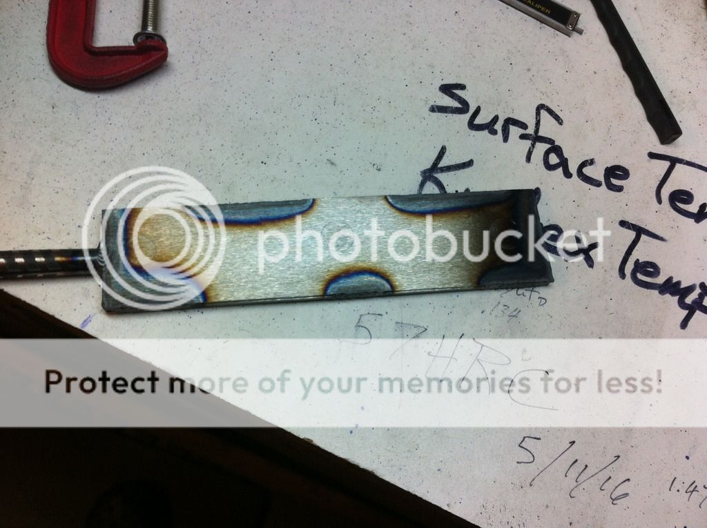

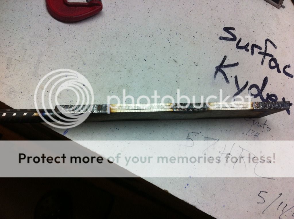

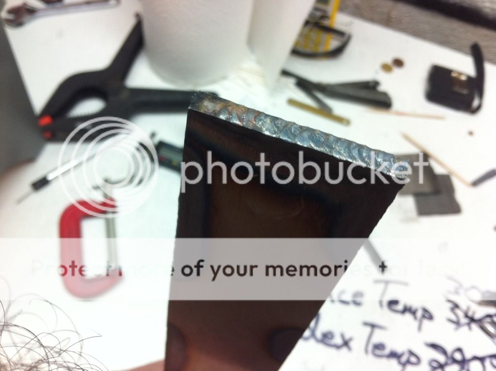

I got my billet welded today. Not too bad for not having welded in 16yrs:
BTW, it's nice to have a good friend who's a professional welder. ;)

Welds look fine, but without welding completely around the edges, you'll have to use flux of some type. If you simply weld it completely shut, you won't, and IMO, it's a pretty sure thing as long as you hit your temps. It's what we typically refer to as a "dry weld".
Oh well. All I need to do to flux with kerosene is soak it a bit before sticking it in the forge, right? If so, It's not a big deal.
I asked him to weld it all the way around but I think there was a communication breakdown somewhere along the line and this is how it came out. In the future, when I'm doing it, I'll probably just weld entirely around it.
Yeah, just "soak" it in kerosene for a bit. The only reason to soak of course, being to make sure it thoroughly coats the inside, obviously the metal doesn't absorb the kerosene.
If you've welded the billet closed, then you are dry welding. If only tack welding the billet, dip it in kerosene. No need to "soak", it just takes a second. If using kerosene, stick it in the forge and don't move it until it's orange, pull it out and set the welds. It really is that easy, and the Atlas does a fine job of small san-mai.
DO NOT POUR KEROSENE ON HOT METAL!!!
