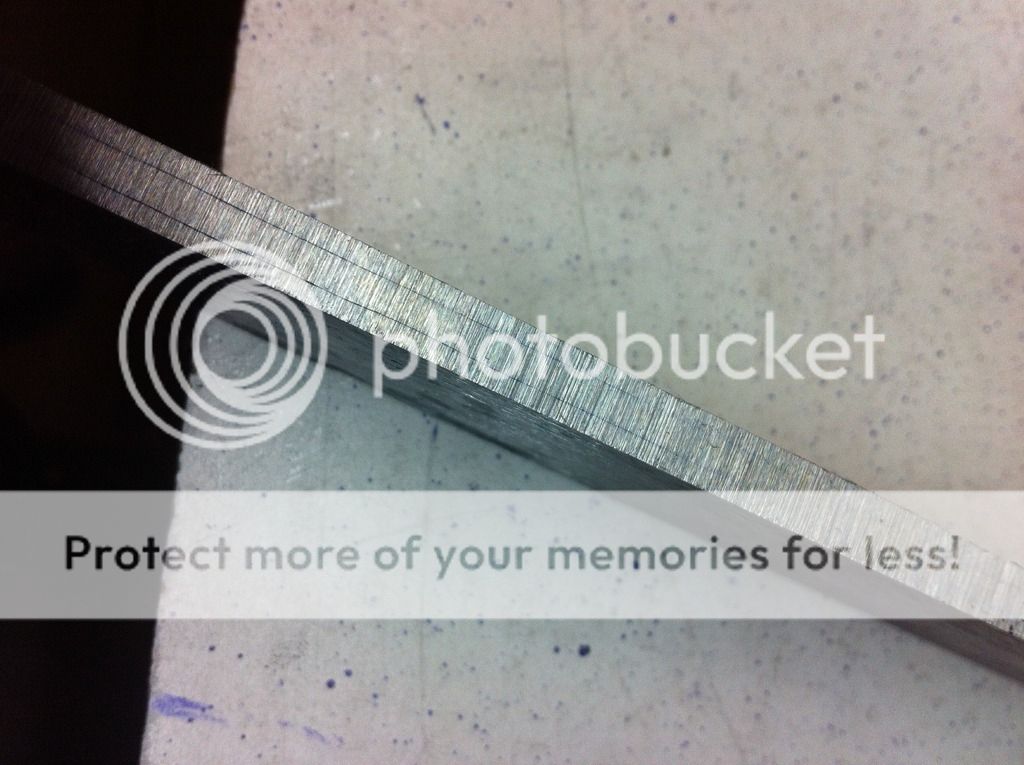

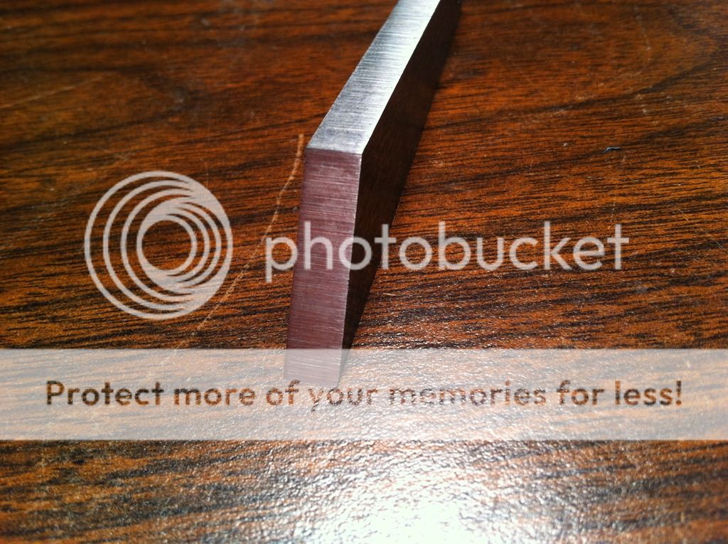

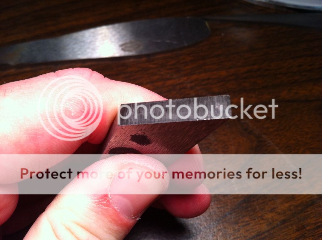

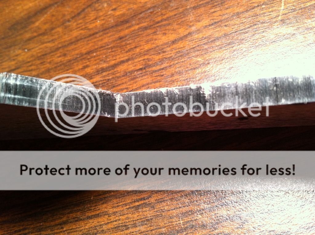

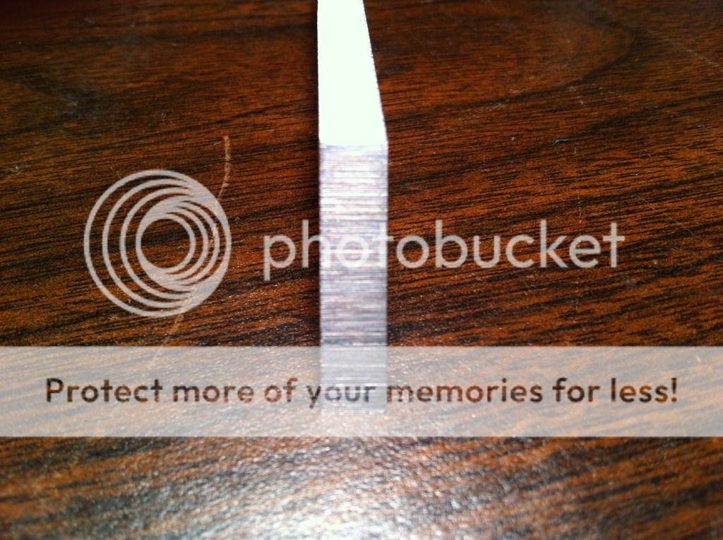

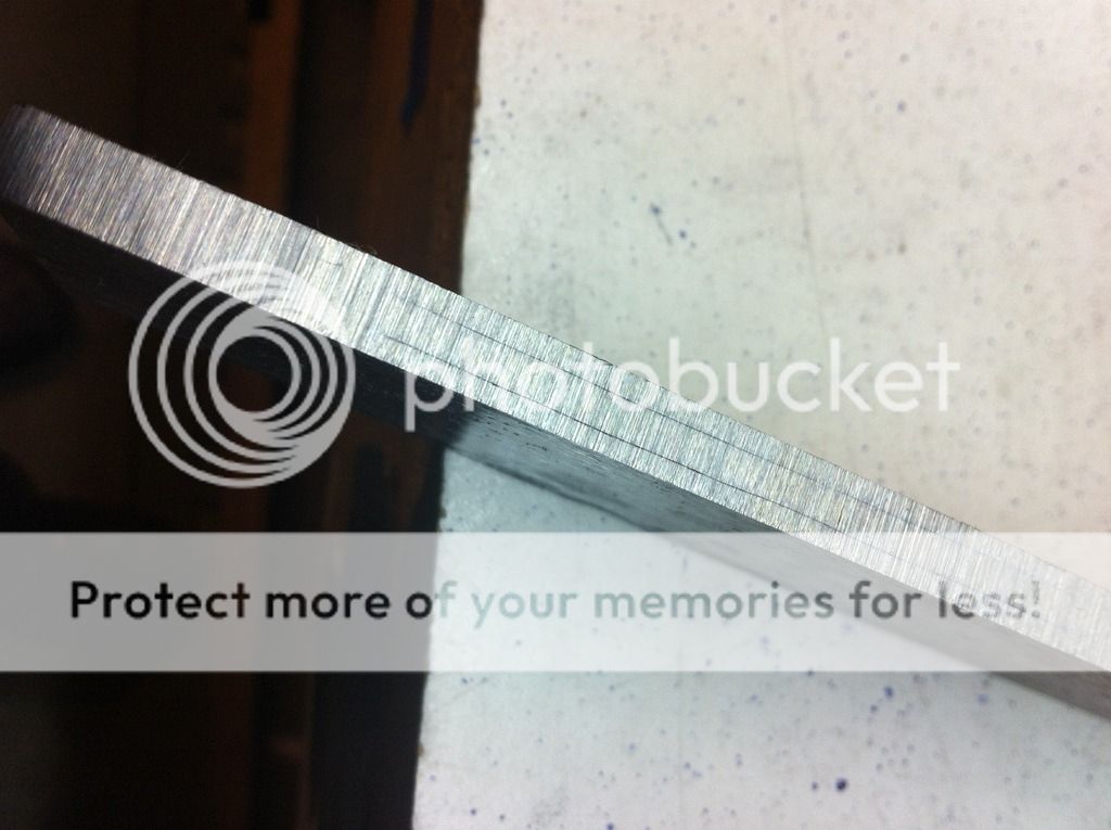

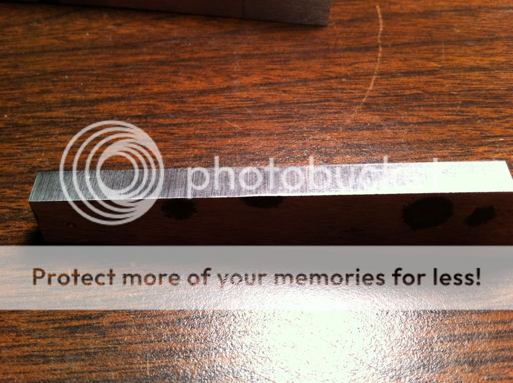

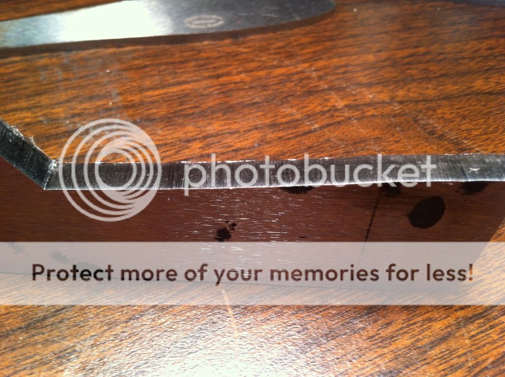

Like I said, I worked on the billet last night and think I did an okay job. That being said, I could have screwed it up in any number of ways and not even be aware of it lol. I did take some pictures though. I soaked it in kerosene for a few while the forge was coming up to temp and then stuck it in. I didn't move it at all until I brought it out to set the weld. I brought it out and hammered quickly with medium-light blows until it dropped below working temp. I stuck it back in and brought it back up to working temp and did this again. Probably 4-5 heats. Now this is where I might have screwed up because in my head I was thinking of the things I read "set the weld all in one go after fluxing with kerosene," and "flux with kerosene and set as much as possible in the first heat, then flux with borax on following heats." I didn't flux with borax though. So who the hell know, it could be scrapped, maybe not. Either way it was a learning experience. Next time I will do a dry weld/have it welded all the way around.
I cleaned it up but some of the weld is still on the sides, which will show in the pics. The parts where the lines between the pieces don't show is where there's still some tig weld left on it. I think I'll cut out a small kiridashi later tonight and see how things turned out.

Are the lines between the pieces supposed to be visible, or is that delamination?
The billet was .305 before forging/welding and it's .250 after forging/welding and surface grinding.
That looks like delam to me. You can try rewelding with a borax flux, but those dark lines are almost assuredly oxide which will prevent you from rewelding it without flux. You can also just try to grind deeper into the billet. It is possible you just missed a bit of the edges. My guess though is that it will take a reweld with some borax flux. No biggie.

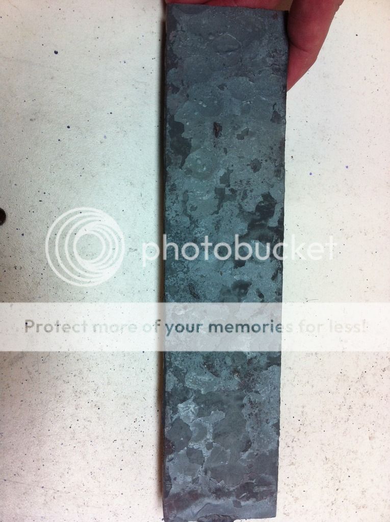

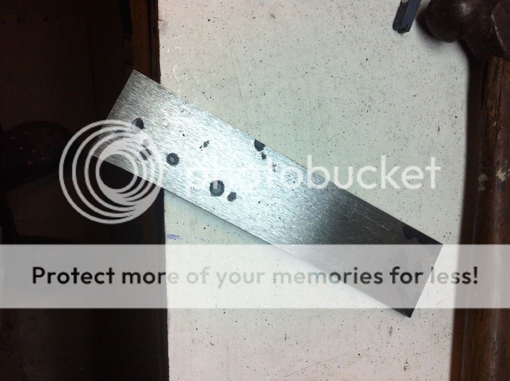

I think you're right. I cut a small kiridashi out of the billet and on the inside of the billet it looks like one solid piece of steel.
You should not see any "line" so to speak when grinding the edges. You will see the layers when grinding but it's more of a steel color difference not a line where the weld is. Looking at your pictures above that's not welded, perhaps it's welded further in but until you cut into it you won't know. Another way to test is grind like you did and then soak in feric chloride. Then remove the steel and just wipe the surface gently. And non welded area will still be holding the acid and when left to sit will make a rust line. Let's see the inside of that billet.
Keep grinding, it's not unusual to have some bad area on the sides of welds that aren't done in a "can" type dry weld setup.
If you look at your own pictures, you can clearly see where the line disappears in some sections, that's what it looks like when you're into the welded area. You did fine.
In his pictures where the line disappears is where the billet was tack welded together. Waiting for a pic of the knife he profiled out of this billet.

Here some pics of the inside of the billet. It's exactly how a couple of you said. A little delamination about 1/4in from the edges and the inside looks like one solid piece.
Could I just flux with borax and set the weld again on the outside? Would I just heat up to welding temp and then sprinkle on borax and let it sit, then brush it off? Then bring back up to welding temp(2300 ish) and tap the weld closed on the outside?

Heat it to the bright red/orange range, sprinkle flux along the seams, reheat to forge welding temp. Light taps to start off, then heavier blows on subsequent heats. It may work. Borax will help remove the oxidation layer between the pieces, but there are no guarantees.

If your billet is good on the inside then your golden. Only thing I would do different next time is after you dry weld go back and reheat and sprinkle some flux on around the edges and then put back in the forge and let it bubble and clean out the scale. Then remove from the forge and gently tap around the edge. This should give you a solid weld right to the edge.
You'll lose less on the edges with practice, but I doubt you'll be able to fix the edges on the current billet.
