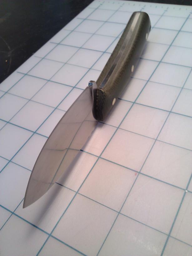

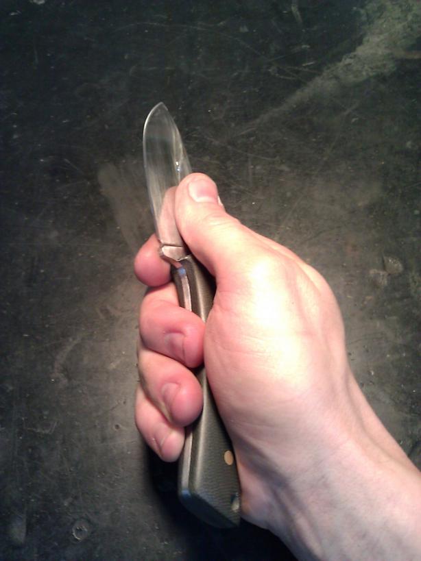

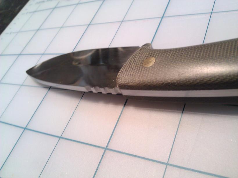

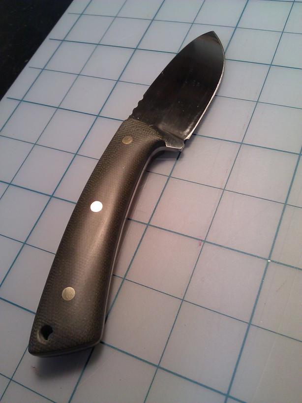

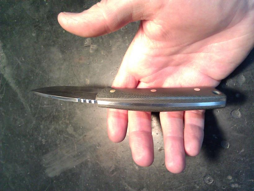

Below are some pix of my latest, just completed this evening.
It's something of a milestone as it is the first complete 3" knife to my original spec, 90% of the work my own (my friend thinned my bevels just a touch, for which I am grateful). This IS my hunting knife, the end product a year of cogitation and 6 months of grinding under patient tutelage. Each knife is built upon the last, and this one meets 100% of my original spec. It was sitting around waiting for handles etc. while I finshed 3 others in which I didn't have as much emotional investment. Fortunately those intervening three taught me a great deal more about shaping and fitting handles, and that was the final missing element. The kydex gave me fits tonight - too hot and and cut too small. Putting that piece aside and starting over solved the problem.

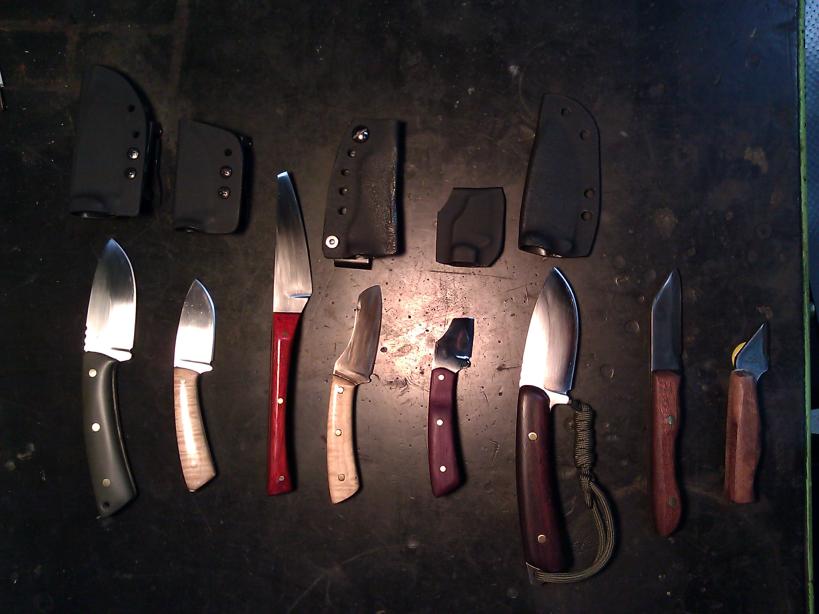

Reaching this milestone is a siginificant event (family pix at the end), but this is definitely not the end, there are 3 or 4 more in some rough state, and lots more steel stock on hand.
As always, thanks for looking and your constructive feedback.
Steel: 1/8" O1
Blade Length: 2.95", tip to handles (3" max legal in my state)
OAL: 7.125" (juuust enough handle, not too much)
Scales: OD green micarta with 3/16" brass pins & lanyard hole

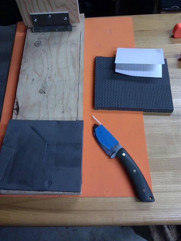

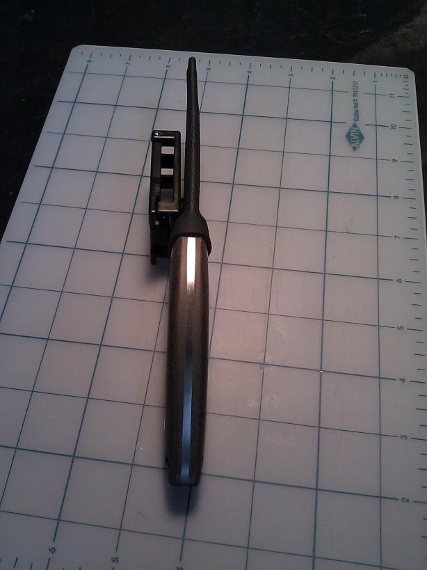

Sheath: kydex with mini tek-lock & drain hole
In approximate order of completion from right to left (duh):
RIP the three that didn't survive heat-treat (two big 'uns and a rigging knife). :-/

That looks just about right! Good work! Great size and shape to have handy at all times.
-Xander
ahhh, a labor of love......... :D
just something about your own......
good job man:thumbup:
what problems were you having with your kydex??
The kydex was getting too hot and shrinking unevenly. I hadn't realized it would shrink at all, and that caused some confusion at first. After 3 attempts with the same piece I gave up on it and cut a new rectangle. My supply on hand is limited, but being too miserly with the first piece caused more waste in the long run. A nearly universal lesson.
Hm, I just realized there are two others missing from the family pic.
Maybe two pics are necesssary: "actual knives" and "nearly knives". Heh.
Very nice work. That latest hunter looks like a very smart design - I notice you used relatively thin stock and ground it nice and keen :thumbup:. Keep at it, you're doing great!
The pieces with emotional investment are often the best, despite the headaches along the way. Great job on that hunter! I like the lines and it should serve you for many years! Keep 'em coming.
