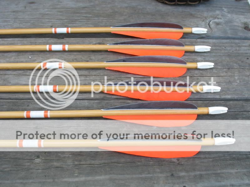

latest batch of arrows.
mtnfolk mike
Mar 21, 2006
10,040
hey folks..

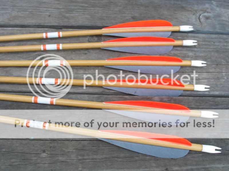

we have another weekend long, 3-D traditional archery shoot coming up in a few weeks.. i was checking my arrows and they were looking pretty ragged, so i figgured i was about due to make another dozen..
i have slowly but surely been working on these for the past week or so.. we have been super busy lately and i have just been squeezing in an hour here and there at my workbench... it is a long tedious process.. i ran into a few hicups along the way (think, don't rush), but they turned out okay.. i finally just put on the last fletch last night..
here you go.. they are Port orford cedar shafts, spined @ 45-50#, they're cut to 29 in. long to accomidate my draw length.. i stained them with a light honey maple wood stain, crested them and them gave them 4 coats/dips in laquer.. hence the shinyness...:D

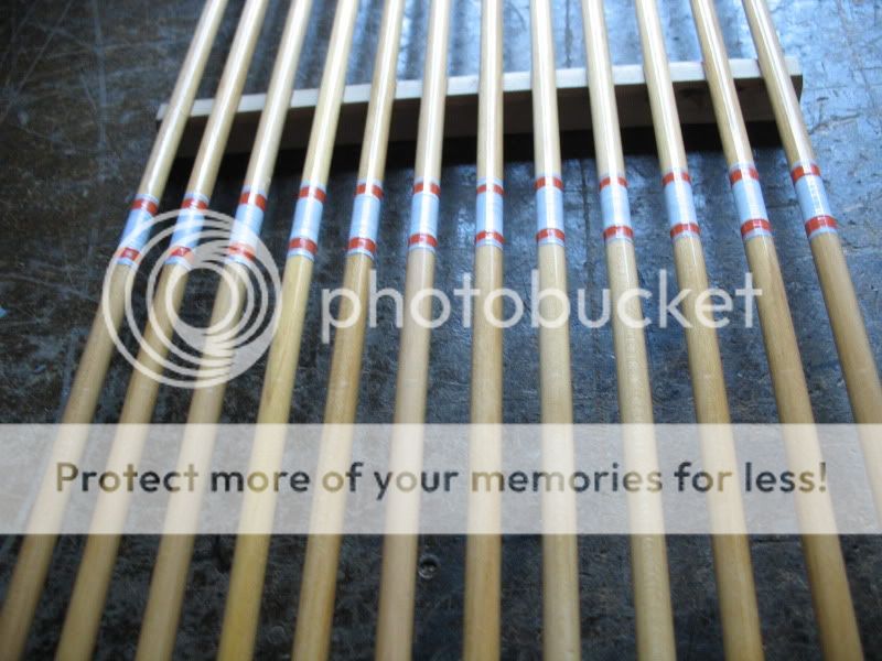

in process.. before nocks, laquer, points and fletches.. i wish i would have taken more pics while i was working..
cheers.. Mike

awesome, what equipment and how much money do you need to get into making traditional arrows? I have a Howard Hill and a Martin Hunter in the closet... using Easton Gamegetters just doesn't do them justice
like most crafts, it'll take a little $$ to buy supplies and get started... but they're are ways of doing it on the chaeper side... shooting aluminums out of trad. bows just doesn't seem right..
i taught my father in law (who is a perfectionist) how to make arrows, and now his stuff blows mine away...:o here is a tutorial he did a while back.. seeing how he and I share our supplies, it is pretty much exactly how i make arrows... we have upgraded our cresting machine and now it is much better and more effecient..
