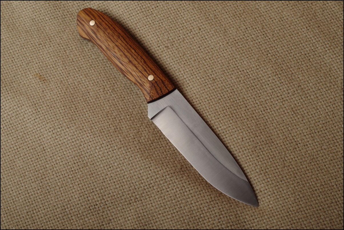

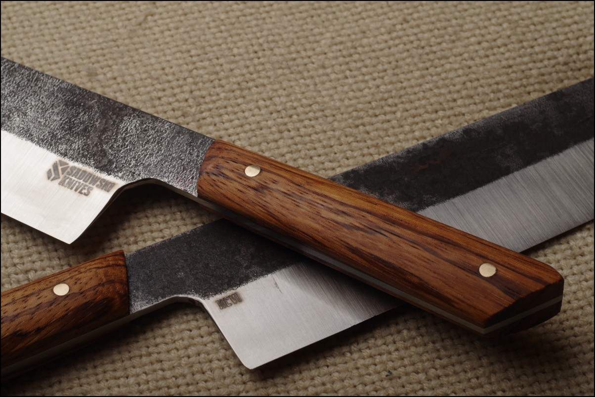

Manticore
Cutting Edge: 120mm
OAL: 250mm
Bevel Height: 20mm
Handle: 120mm
Steel: NC4 3mm - ~62HRC http://zknives.com/knives/steels/nc4.shtml
Scales:Zebrano + brass pins

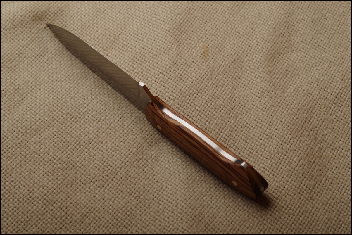

Bushcraft
Cutting Edge: 115mm
OAL: 240mm
Bevel Height: 20mm
Handle: 115mm
Scales: Zebrano + brass pins

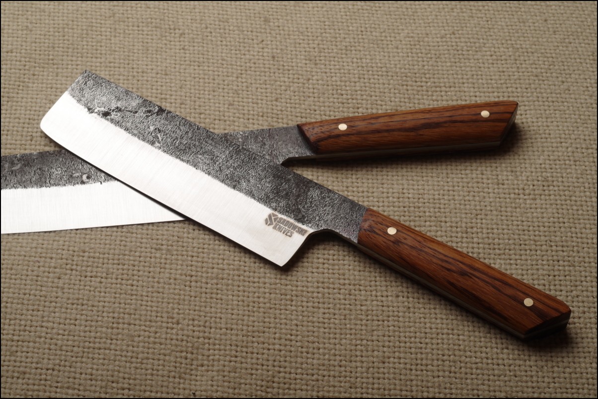

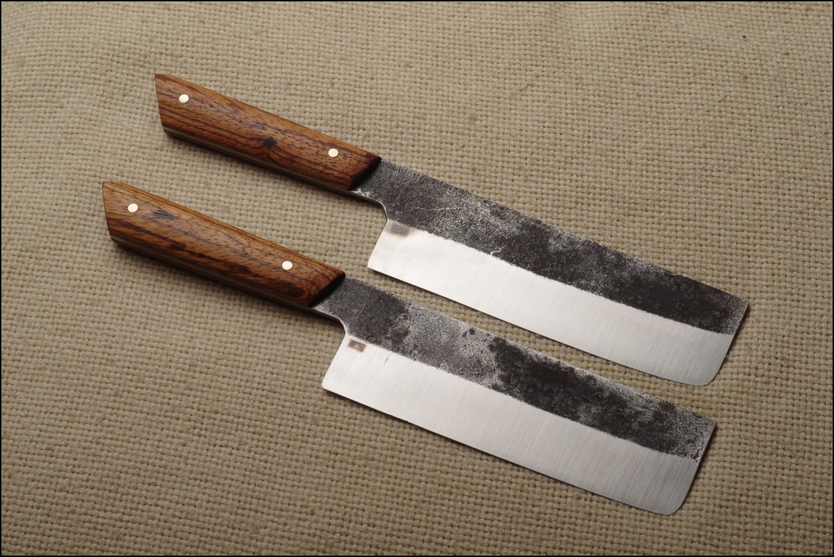

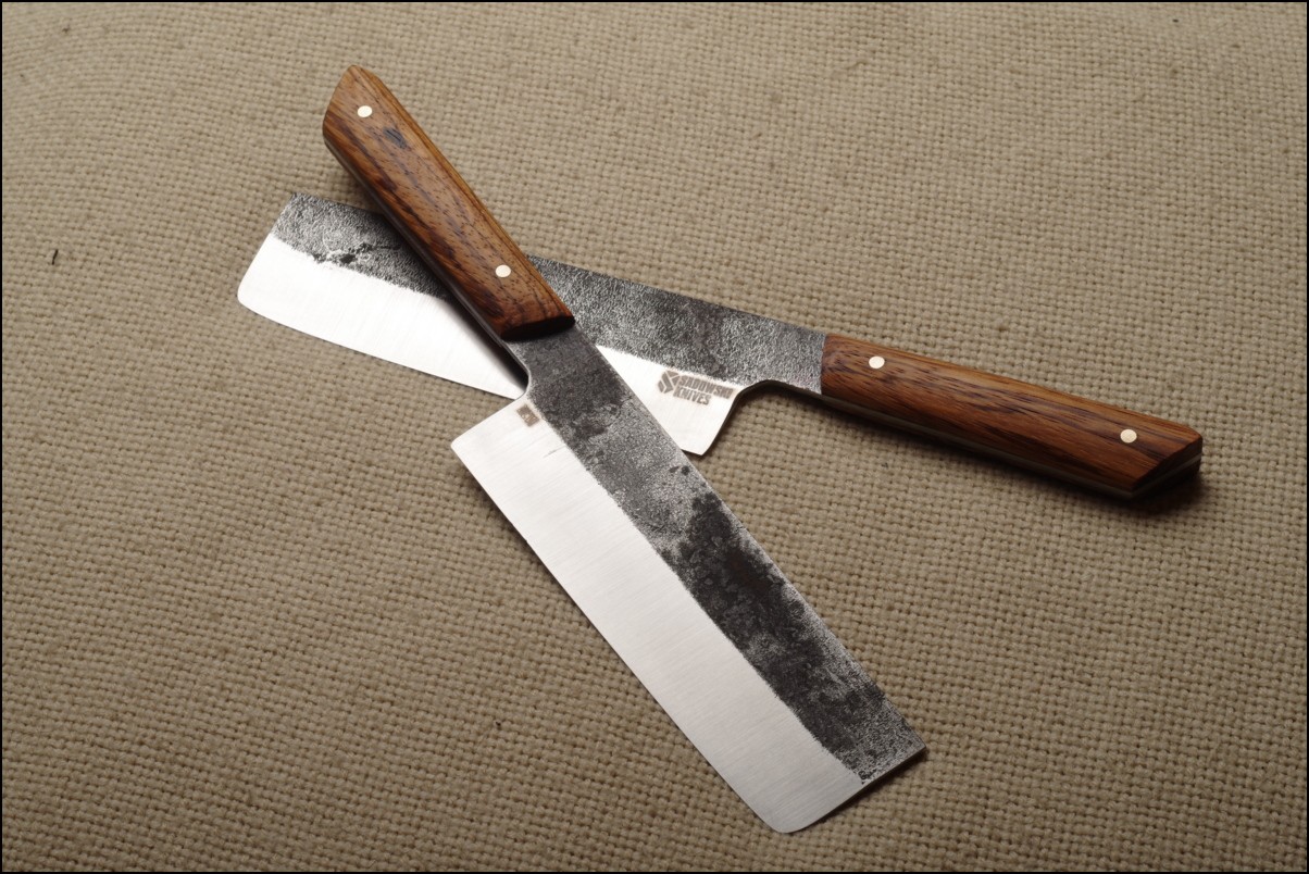

Nakiri
Cutting Edge: 145mm
OAL: 255mm
Bevel Height: 25mm
Knife height: 45mm
Handle: ~110mm
Steel: NCV1 ( 80CrV2) 2,6mm
Scales: Zebrano wood, Brass pins, G/Flex epoxied
Finish: A65 + ScotchBrite VF machine satin
Hardness: 62HRC

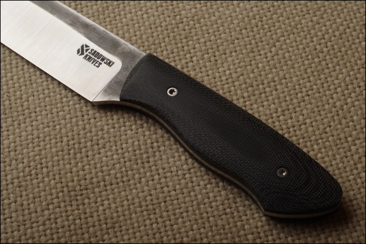

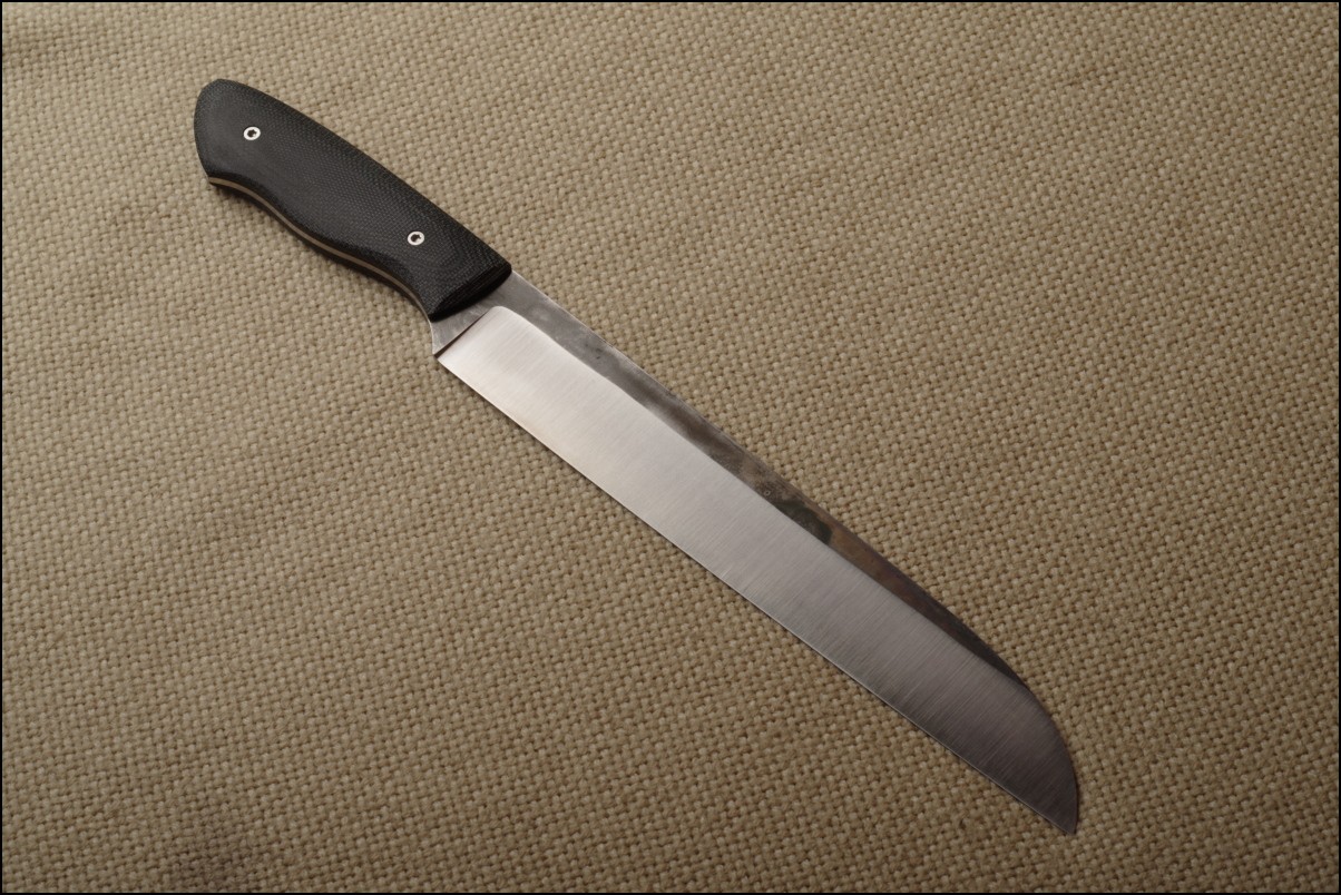

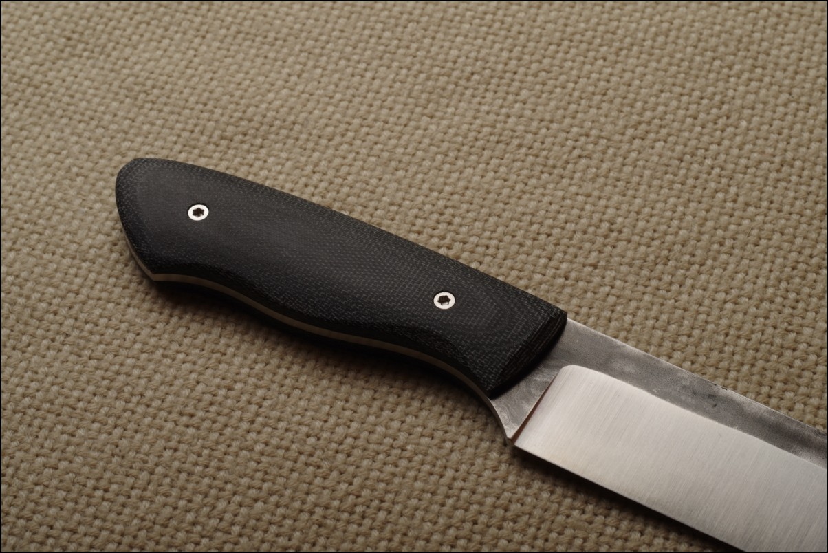

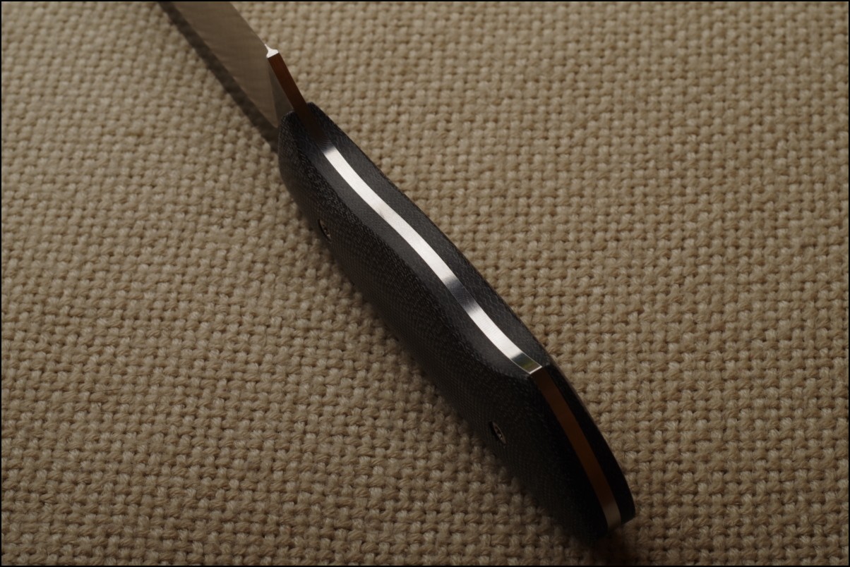

Kitchen Knife AEB-L
Cutting Edge: 230mm
OAL: ~355mm
Bevel Height: 26mm
Handle: 120mm
Steel: AEB-L 3mm - 60HRC
Scales:Black Canvas micarta on M3 fasteners with Torx screws.
