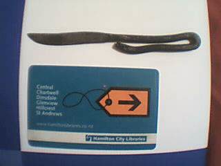

Wasn't sure if this can even be called a knife, so stuck with the term Sharp implement. :rolleyes:
This is made for one purpose only, to sit in the rear storage compartment of the 4wd farm bike so theres always a sharp object handy when out the back of the farm and need something to cut with, but Murphy intervened and ensured the EDC pocketknife or the genera purpose farm knife has been left in the shed or on the table several Km away up and down hills and through muddy bogholes. :jerkit: Murphy can be a real asshole sometimes.
made from a length of chainsaw sharpening file (mystery metal) which had the handle spike snap off, heated in the wood fire, normalised once then brought back up to temp till the shadows in the steel settled down and dissapeared, then water quenched in 30 gallons of cold chilly rainwater. tempered by sticking it in the oven at 350*F as dinner and some bread cooked. It's probable that it's almost untempered, being low temper temps for less than an hour and a half.
Some more info now it's been cleaned up and sharpened.
Blade 2" long, overall length 4.5" Blade thickness 1/16" blade depth 5/16"
Made from Sthil 3/16" round file, the library card size reference in the above picture is the same size as a standard credit card.
I'm thinking of using a 5/16" Sachs/Dolmar round file from the previous chainsaw to make a filleting knife now, another mystery metal but still good fun hammering on hot metal. :D

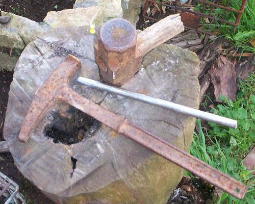

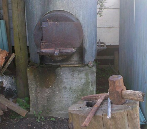

Heres a couple of pictures of my "forge" and "anvil" setup.
The fire is a wood burning Marshall heater with a 1" hollow water skin around the firebox, and the fire cavity extending into the water storage cylinder, the chimney runs up the middle of the water cylinder and exits up the top. We can heat the water enough that it boils out the relief valve. More than hot enough to run straight out a tap and through a hose in the window to scald and scrape a pig hung outside. :D
The Anvil is an old hammer head slotted home in a socket carved and drilled in the end of a log of kanuka firewood, the hammer is an old geologists spike hammer with the spike ground and rounded to a peen, and the other end refaced to a even slightly convex face.
the bar between the hammer and the anvil is a length of 12" x 1/2" high tensile carbon steel bolt I ground the galvanising, thread and head off to form a 9.5" x 1/2". formerly a high-stress house piling structural bolt that was part of the foundations of this house when it was 70 miles away :D this farm was bare land, so we shifted the house here to have somewhere to live in :P

Anyhow, i managed to get my latest plaything up to the point at which it just needs drilling for pins, HT'ing, finishing work and a handle installed. But before oing the HT i decided to flatten out and quench a scrap bit of the bolt shaft to see how well it responds to HT. Using an angle grinder supplies sparks nice and fat like 5160 does, but the water quenched scrap acted like tempered spring steel rather than brittle untempered high carbon steel.
I'd suspect from the reading that the steel is between 20 and 40 points carbon, too low to harden sufficiently for making a blade... so now I have a nice bit of mild steel. Good practice hammering it out of 1/2" round bar, and theres another unfiled blade blank from the same bolt shaft...
All that work and fun and no knife to show for it. I'll just have to scrounge a JD control shaft and start flattening that :D
