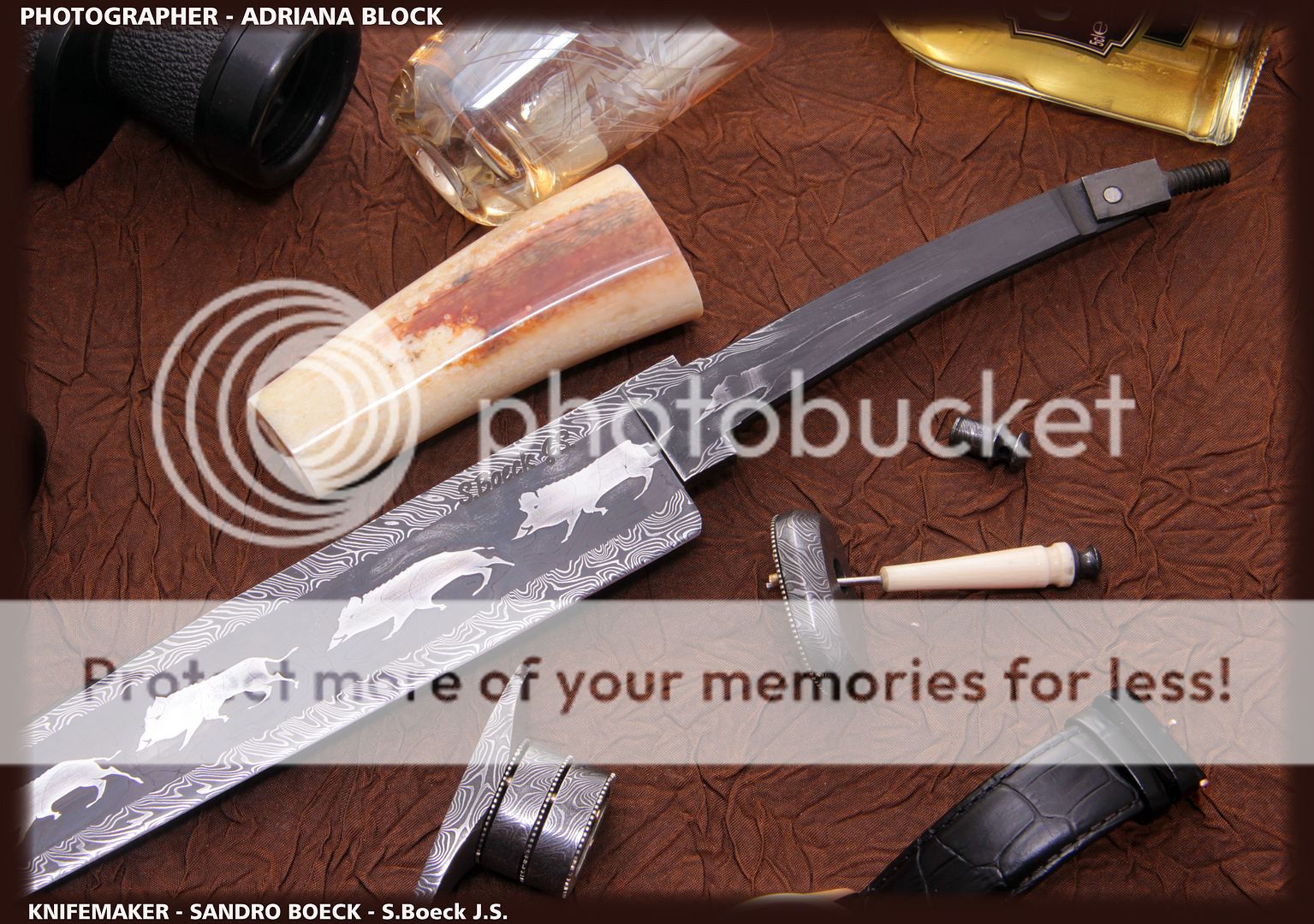

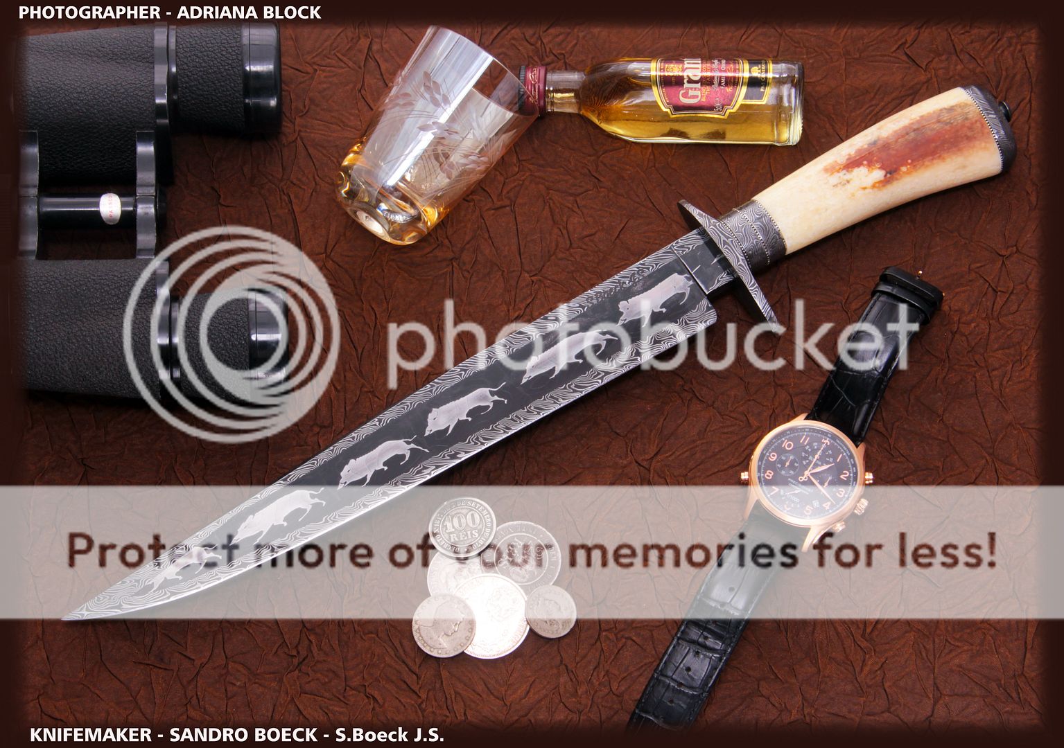

Hello friends I have been presenting this Bowie Knife Model I did for a client.
This knife has a different job, because I had to use a different technique, it is mounted sheets 15N20 and 1070 laser cut and clad forming core of the knife,

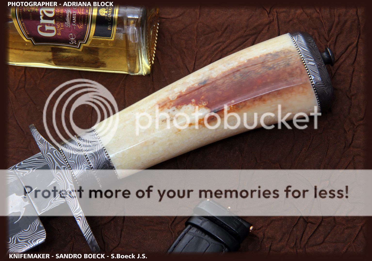

The edges have a twisted damask 25 layers, as well as at the end of safety pin assembly, guard bone spacers in a triple twisted 25 layers each bar.
Cable fossil walrus ivory, spacers in alpaca with Piquet, demountable.

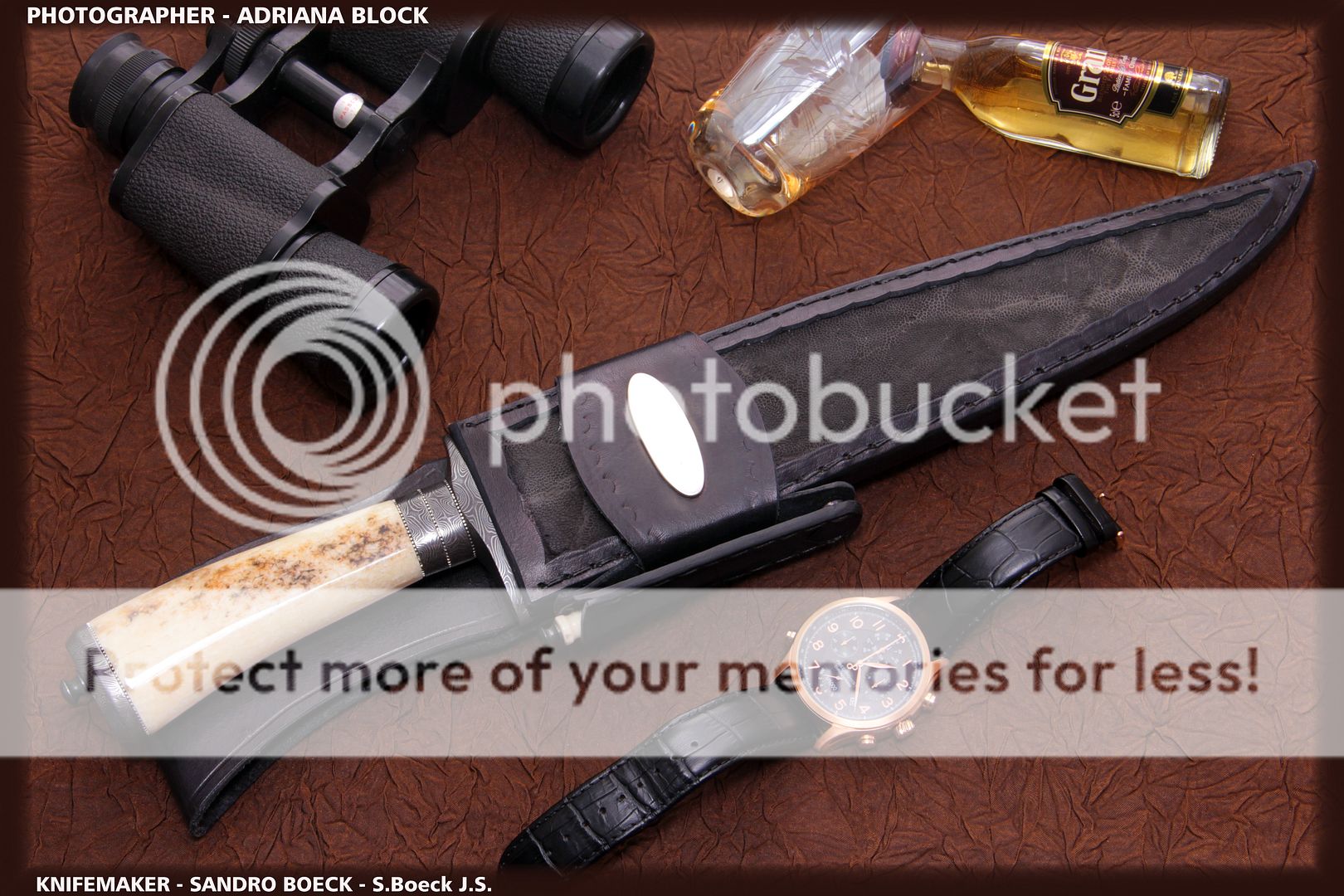

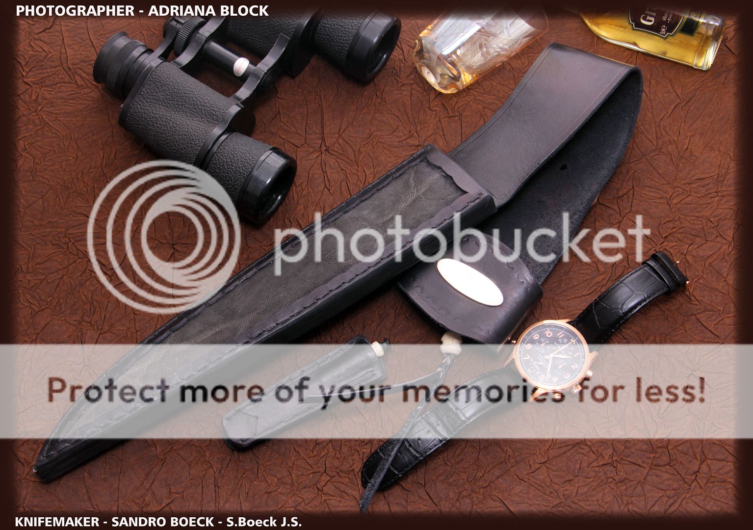

Leather sheath with apply in elephant skin, shell silver for recording the name of the owner.
Thank you for looking
I saw this earlier on my phone, and waited till I got home to look at it again on the computer to see full sized pics.
Very nice!
One thing that jumped out at me, was the front board that got cut in half at the tip. I wonder if it would be possible to omit one of the laser cut outs to avoid that in the future. (I know that is very easy for a non knife maker, layman like my self to comment on, and likely much harder when forging hot steel!).
All in all, it is a very striking knife, and I'd be tickled pink to ever have one as nice!
