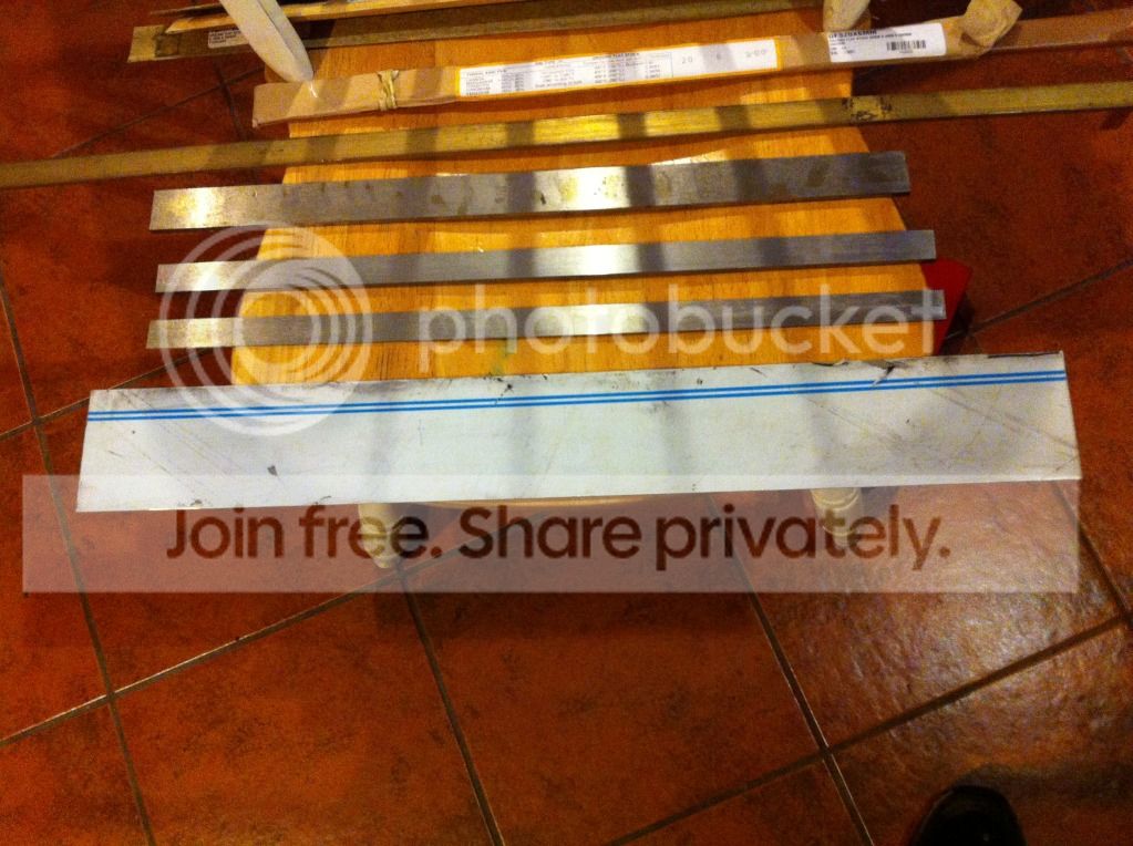

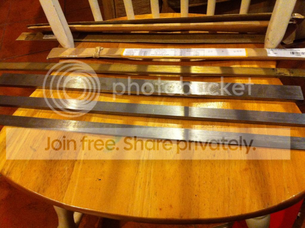

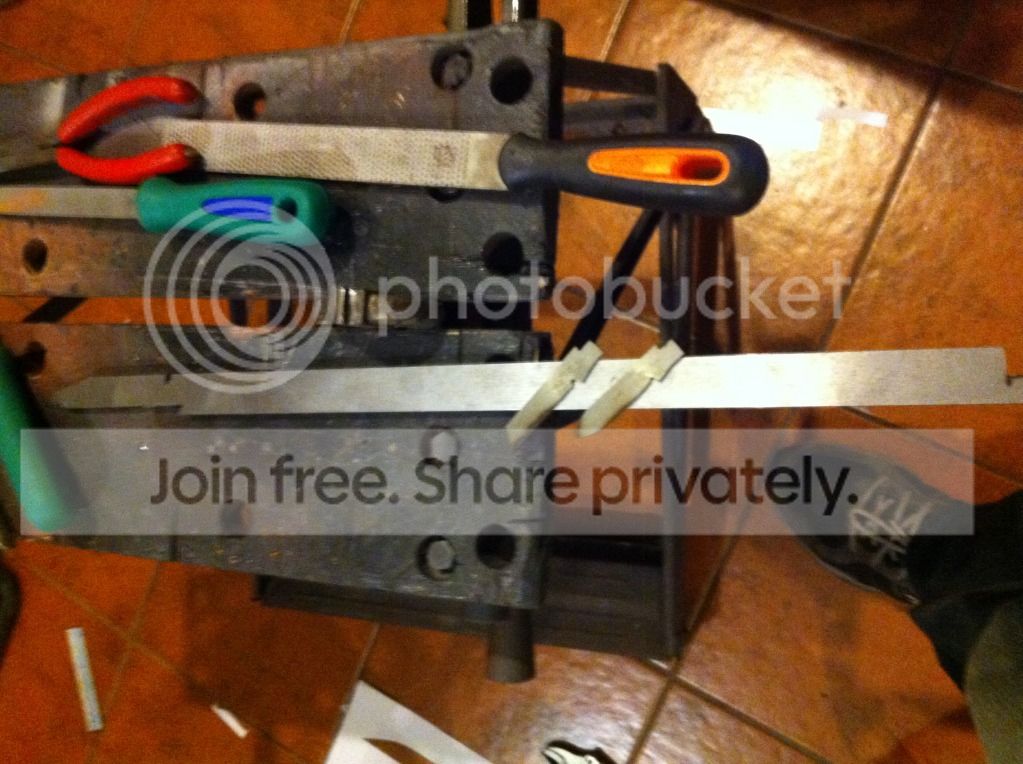

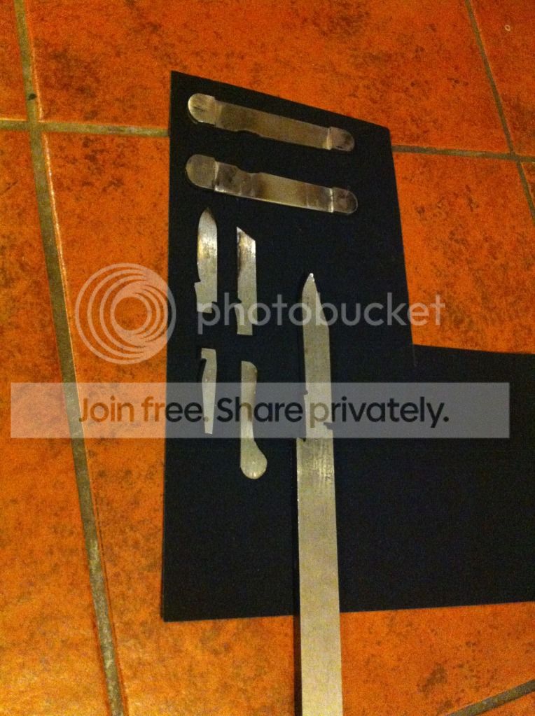

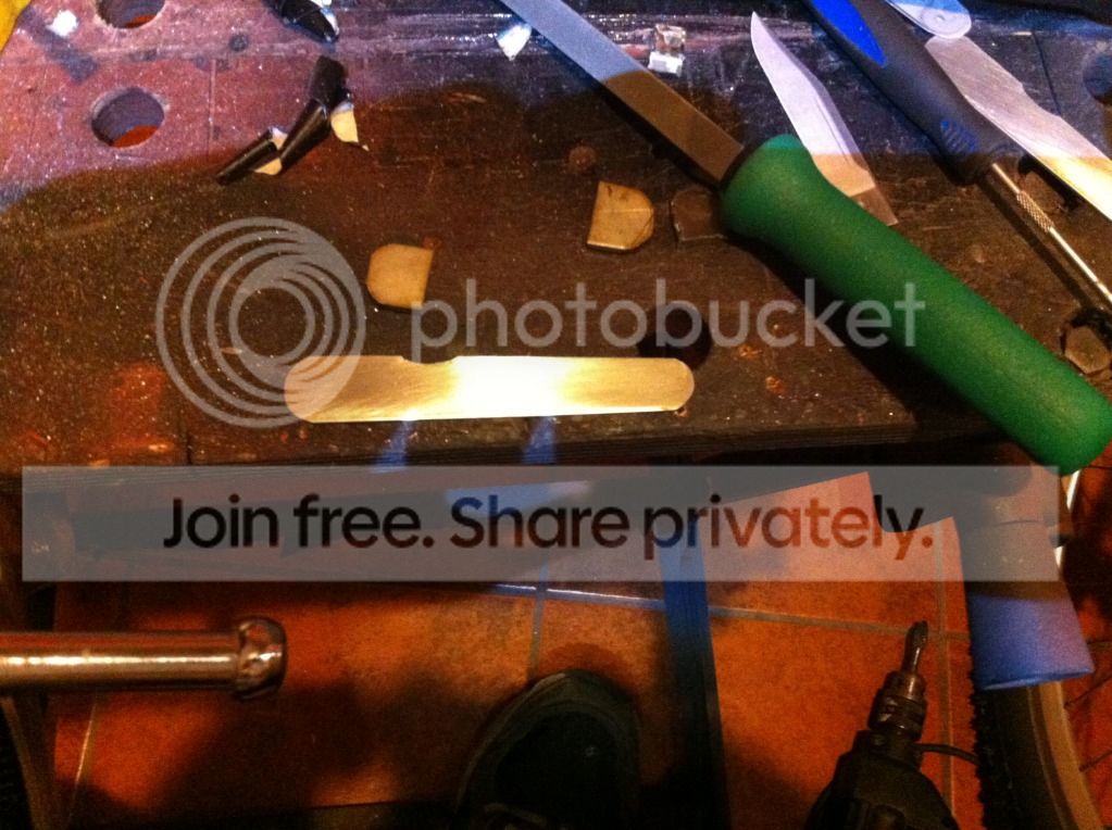

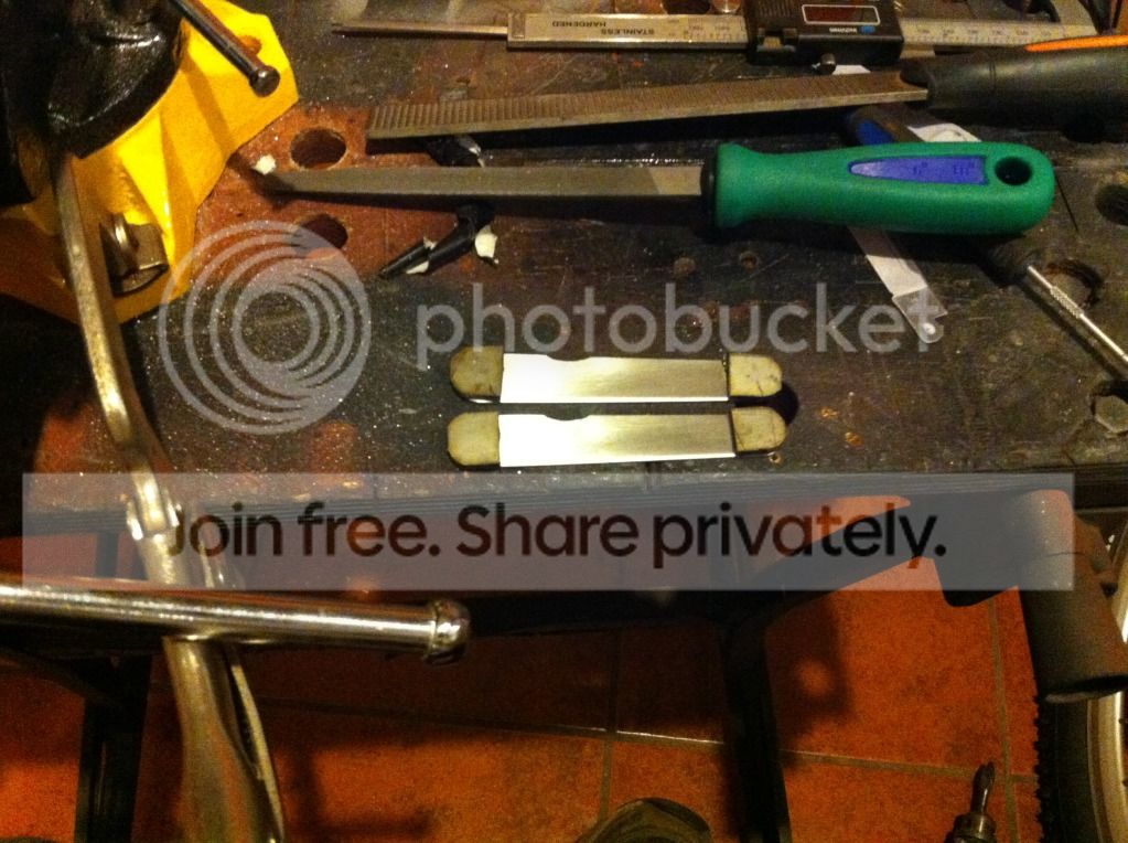

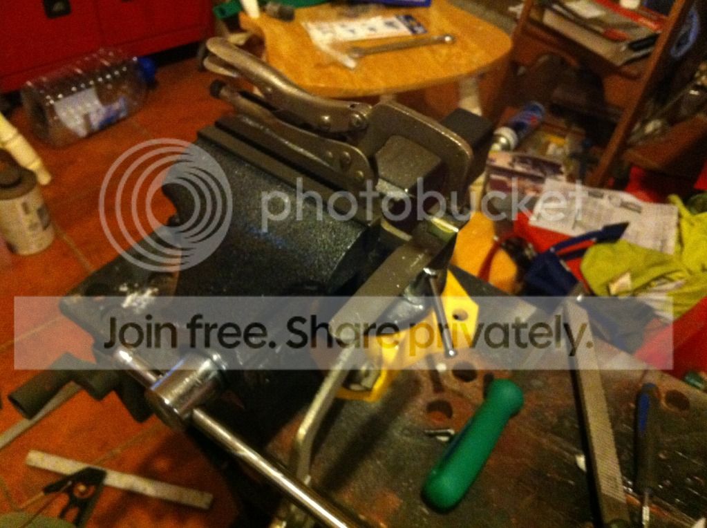

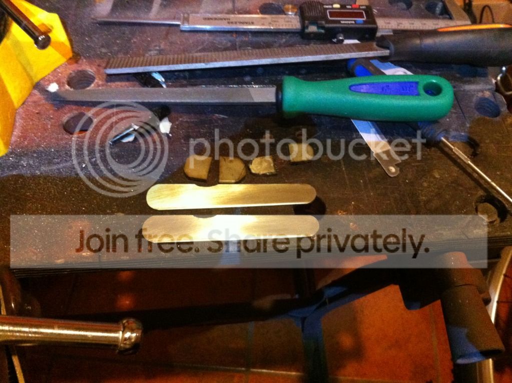

well today I bought some high carbon steel ground stock in various thickness for my build, I also bought some brass stock for the bolsters if I feel that way inclined.
Ill have to decide on what handle material I will use but I suppose these are the fun bits in building your own knife, I must bet brass bar stock for the bushings,and malleable brass for the rivits
and the stainless for the bolsters
im sure ill mess up and have to start all over again but I still enjoy the peace in making this
Looks like a good start to me but then again I dont do folders yet. Maybe one of these days. They are more challenging in some aspects.
