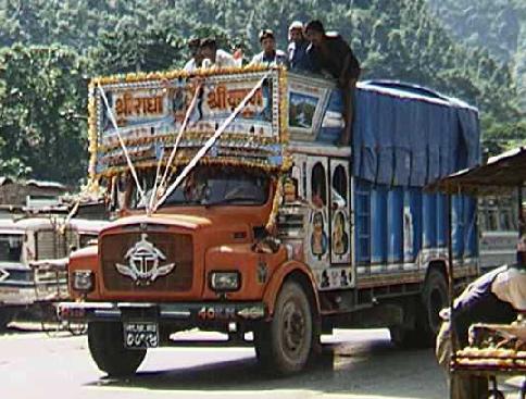

Wait, what? The mercedes trucks in Nepal/India aren't 4-6 person double cabs - they're true workhorse TRUCKS (closer to semis) - generally old stuff from the 60s and 70s. The people over there are very poor and no one owns a car/truck capable of only carrying 4-6 people and a bit of cargo. It just isn't practical nor affordable. They take large trucks and retrofit them for transporting a lot of people or goods... if you're going to get from small town A to large city B, you're either going to be hitching a ride with 30-40 other people or hitching a ride with a whole bunch of livestock/goods (unless you're rich).
Simply put, we don't have kukris made of VW leafsprings because they didn't really have those over there... at least not the ones you're talking about.
