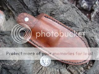

For you leather guys out there. I made a sheath for my little JK Pocket Kephart and want to try something new to finish it. I use Tandy Carnauba Cream as a finish for things like this but I have been wanting to use something else, like beeswax or ...well anything. I want to try something new, fairly simple, and not extremely messy. Suggestions? Thanks
