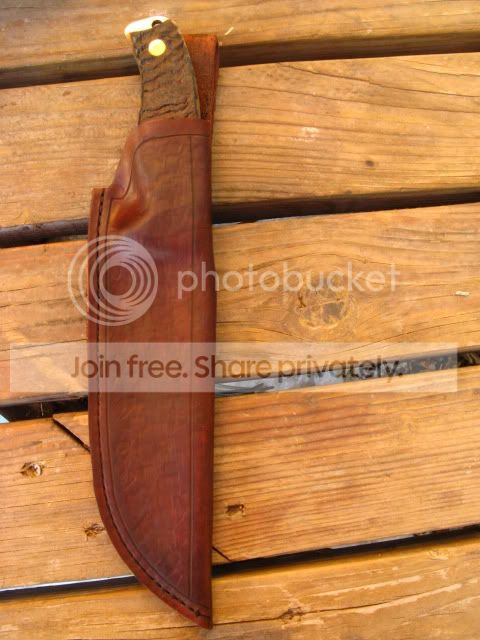

Here's a BRKT Highland in 7-8oz. THe Highland is about the same size as the Moras, albeit a little heavier.

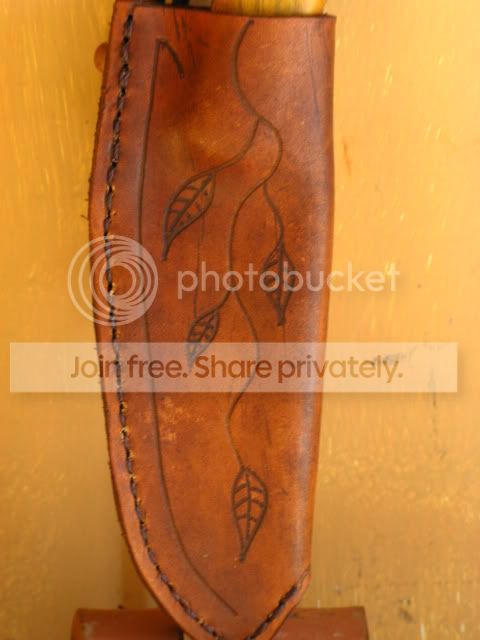

I dig the tooling on that sheath. Nice work. I did these with 8-9oz. veg-tanned.

Excellent work on yours too! I'm going to have to learn how to make the decorative thin lines like the first one pictured...I see that alot and I like it. I imagine I could do it with a stitch groover.
How did you finish those? Post your method. I love that color and sheen. :thumbup:
My tooling was done with the but end of some small toenail clippers :D
I followed the "veins" I could faintly see in the damp leather until they became invisible, then I just free-handed it. I recently made another one for that same knife with a rivet on the back for the strap. It's sewed and riveted. Inside, the leather is cut out for the rivet and thread, and also inset deep enough for a 2oz piece of deerskin to protect everything. I used the same tooling technique but it didn;t come out as nice as I wanted. Oil finish with Fiebings mahogany dye.

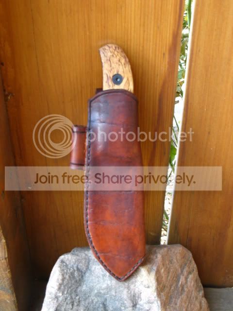

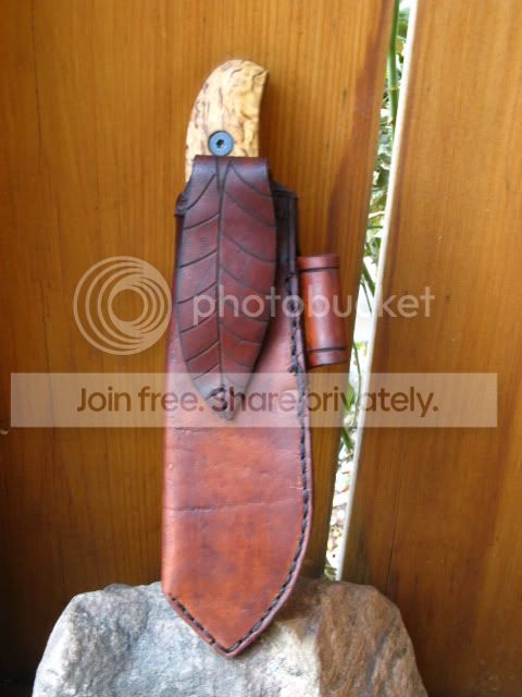

I use the adjustable groover and freehand groover for the lines.
I dye them with dark brown Fiebings diluted with Absolut Peppar vodka and peppermint schnapps. It was the only alcohol I had for diluting dye. I like to go over several times versus one heavy coat. I just treat them with neetsfoot oil.
