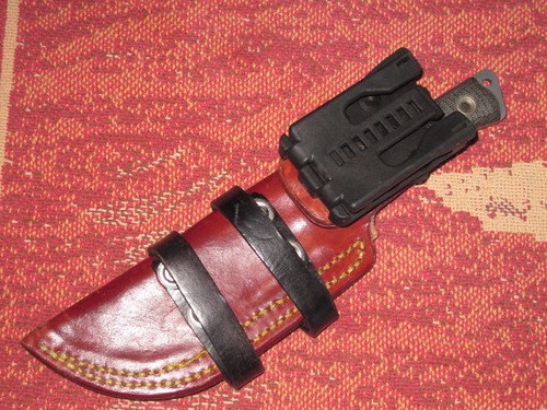

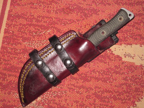

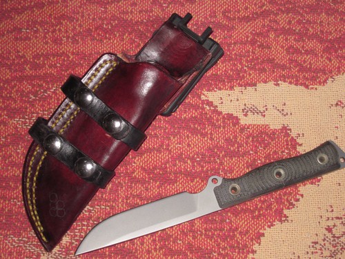

This is Kydex between the calf skin lining and the leather outer (very thin, i think it was .028 or thereabouts). I slapped the tec-loc on after the fact, but it worked with eyelets through the leather.
I'm just a DIY'er, but the nice part about that is, i can do it the way i want it... it's just never quite as good as the pros, and it always takes me 2 to 3 tries to get it even close to what i saw in my head. Alas. If it weren't such a good stress reliever for me, i wouldn't do it. :)
The kydex is nice for keeping it stiff, but it added some interesting complexity to the process. Especially around the lip. I ended up leaving about 1/4 of the calfskin liner on top, and then folding it over the kydex, and under the leather and gluing. Don't know how long that will hold up, but it seems to be working so far.
And Grandsuave... i love that idea! But my thinking is the sheaths will smell better! At least for awhile. ;-)
