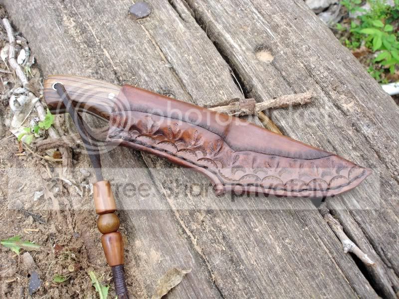

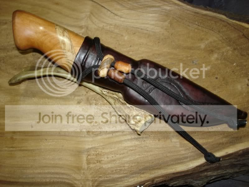

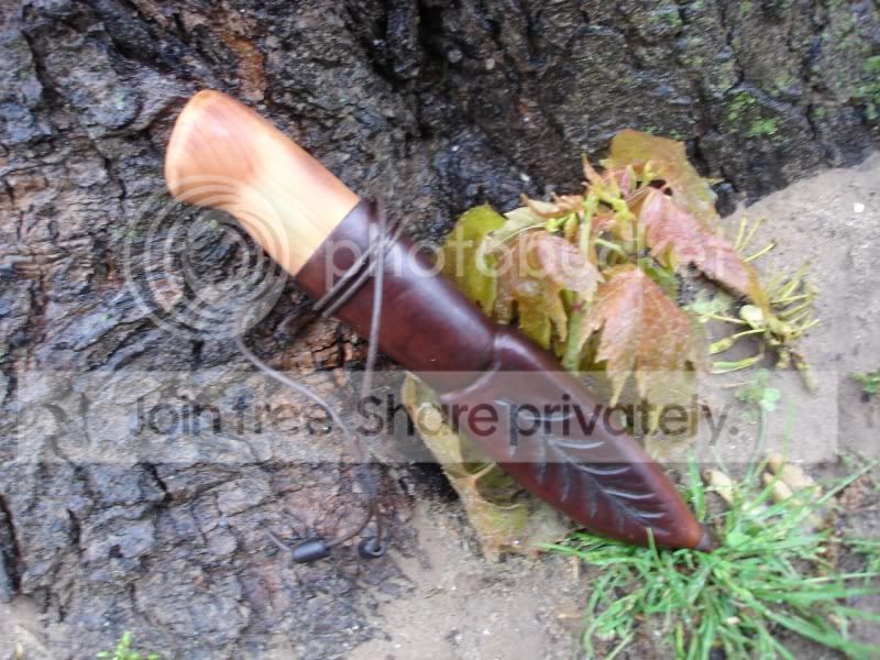

I use 6oz. leather quite a bit for smaller knives. Usually it's wet sewn around a wooden liner for scandies, but occasionally I'll use it for other sheaths.
All of these are 6oz. The pocket sheath does have a welt made from an 8oz. scrap though.
