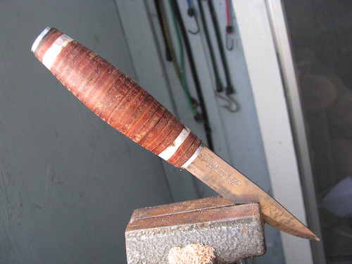

Because some of you requested it, here is that leather re-handle that I was working on.
Not the prettiest knife I've seen, but it's functional I guess, and my wife likes it enough that she already claimed it, lol.
My biggest downfall on this one, is that the antler pieces I used were too small, so I had to kinda go with the shape of the antler pieces, without much room to shape it the way I wanted without making it too small.
Blade: Frosts 3.5" plain carbon
Handle: 4"; Leather and whitetail antler
Bolster & Pommel: I used what I thought was a solid brass door hinge, but it turned out to not be solid, so it's a mystery metal.

I don't think I'm going to work this one too hard, probably just give it to my wife since she likes it, and she doesn't use knives too much. Since the blade is such thin stock there is quite a bit of flex in the handle. That also might be due to the fact that I may not have compressed the leather as much as I thought. I enjoy the feel of this knife though, so when I start making my own blades, I think I will try a leather handle again, but with 1/8" stock, and a double/split full tang.

are these stacked together without epoxy or glued together as they are stacked? I really never gave much thought into how this process is done.

jawilder: These are epoxied together as I stack them, then I peened over the end of the tang to keep the handle compressed, and so it doesn't come apart. You could probably get away with not using glue or epoxy, but the epoxy also helps so the disks don't rotate over time and make the handle all out of whack.

Did you soak the handle or treat it with anything? I have heard of soaking them in melted wax until they soak up the wax and seal it.

Yes. First I soaked it in my wood finish. I wasn't planning on it, but did it out of habit.:rolleyes: The wood finish is linseed oil and pine sap. When I took it out of the soak, I wiped it down then rubbed in some "sno-seal". I used a generous amount and rubbed it in with my fingers hard. Let it set up for 30 min. then wiped off the excess with a rag and sanded with 1000 grit. I did this a few more times, letting it sit longer periods of time, then the last time I let it sit overnight, and didn't sand it. It actually gave it a really nice finish if I don't say so myself.
The pictures were taken after the soak and before the sno-seal.
P.S. 'sno-seal' is a beeswax based waterproofer and leather protector. It is the absolute best for waterproofing your boots(1000 times better than the sprays), and it turned out to be a nice leather handle finish as well.
