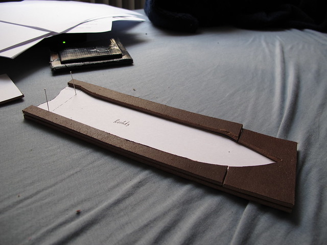

The layout of the sheath was already drawn up on a piece of paper, copied a few times and cut out so that I had a template for every piece of leather i wanted to cut out. I learned that it is very important to fasten the templates to the leather, i just used a few pins that i stole from my girlfriend :D
This first picture shows the two biggest pieces which are the "top and bottom" of the sheath.

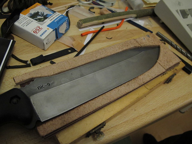

Here I have the pieces just put together to check the fit.

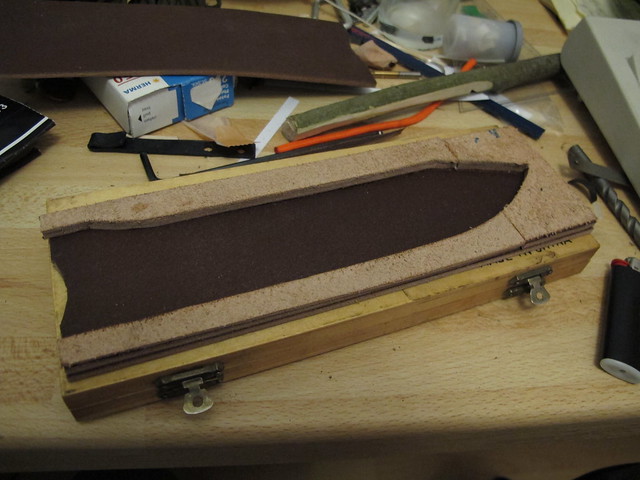

Since the knife is thicker than one, but thinner than two layers of my 8oz, I had to cut some thinner leather to size. Here are the pieces put together, ready to be glued to each other and then the bottom layer.
Everything put together, putting the blade in for the first time to check the fit. Looks great so far. Well, great is probably a little bit exaggerated, but it doesn't look too bad, at least to me. This is my first leather sheath after all.

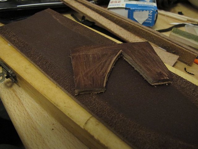

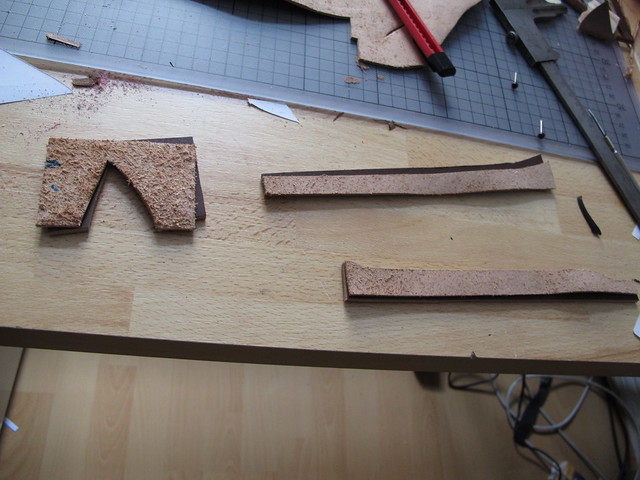

This picture shows how I prepare the pieces to be glued together. The glue I use (Pattex Kraftkleber) needs rough surfaces to bond them together real good. So I scratch the areas of the leather that will have glue on them with the spine of my Stanley knife.

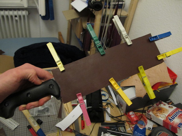

Disregard those ugly clothespins, they just had the job to hold the top piece in place while I try if the knife slides in and out nicely.

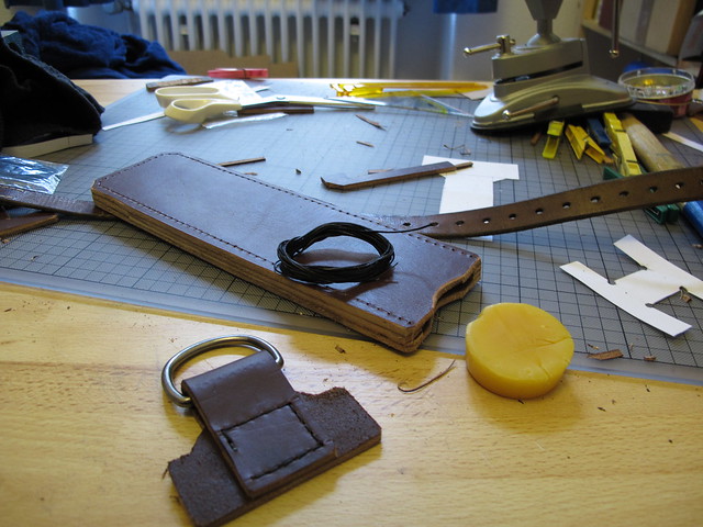

As the title said - I'm more or less finished. I stayed awake through the whole night tuesday to wednesday, because I just couldn't stop. That caused me to wander around like a zombie the whole wednesday, and now I am back to normal. Well, "normal"... let's say I'm not more insane or zombie-like than usual.
Soo...

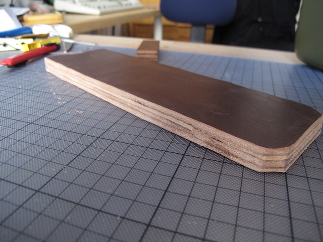

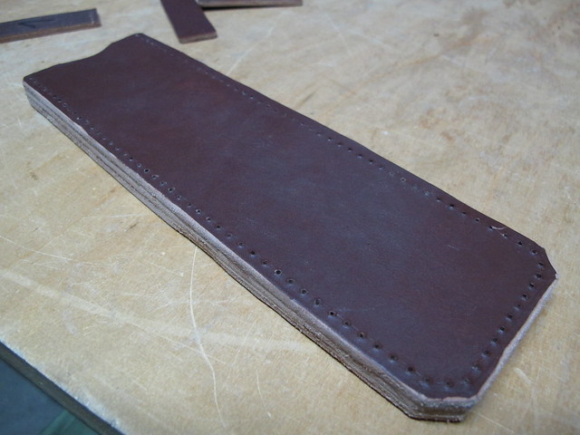

Here is what I started with out of the press. Huge hunk of leather, thicker than a .50 cal bullet :D
Here's the sheath after marking and drilling the holes. I used a ruler to mark a line roughly 5mm away from the edge of the sheath and a caliper to mark the holes. I just set the caliper to 6 mm and pushed the pointy ends into the leather, then move so one point sits in one of the holes, thus making a new hole, move... I marked 102 holes and drilled them using a Dremel drill press and a 1.5 mm drillbit. Drilling fast (about 10.000/min) and with very light pressure helps to keep the leather from burning. Use some scrap wood as a backstop to prevent it from fraying.

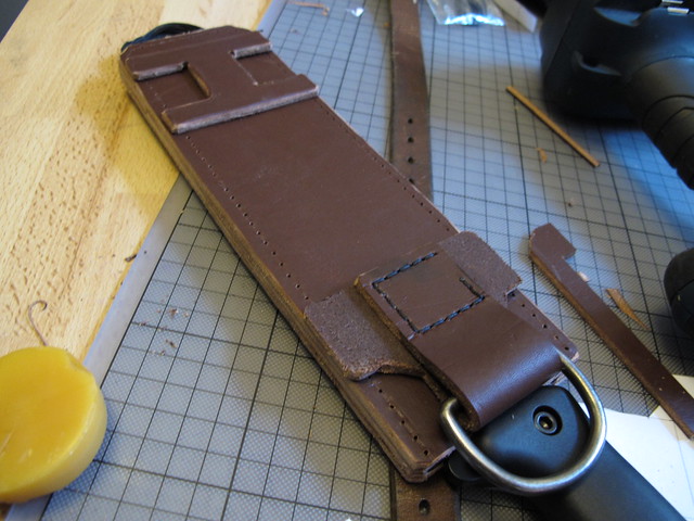

The next picture shows my new idea for an attachment system for the dangler loop and the leg strap. The original idea was to put 3 straps across the back of the sheath and thread another strap with a dangler loop and leg strap on it through them. I ditched that, because it's a bad idea.
I know this could have been done simpler, but the idea came up after I had glued everything together, and I like it that way. I think the less stitching you have, the fewer stitches can break. This sheath is bulletproof :D
Here you can see the twine I used, it is black trout twine which I waxed with a piece of beeswax. My fingers still smell like it.
I didn't take any photos during the stitching, I don't know how long it took me. I like to watch old action movies, preferably straightforward, total no-brainers with Aaah-Nold or Steven Seagull while doing boring, repetitive work, so these movies are my only means of measuring time. It took me Predator and Under Siege to sew the sheath. There you go, you do the math.

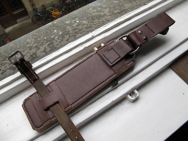

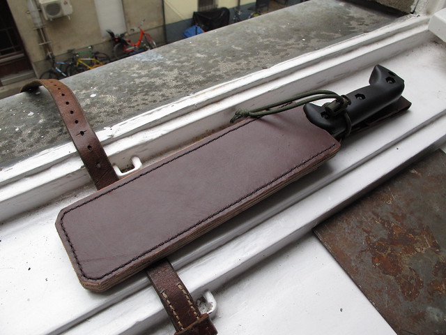

A little bit of porn of the finished sheath.
Front:
Back:

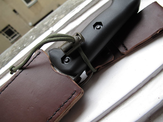

Close-up of the retention... paracord. This is kinda cheap, but it works and doesn't keep the dangler loop from danglin'.

What should I use to burnish the edge? I don't have a boner but I think about getting one. That would probably work, right?
Can I use the beeswax to stain the edges? If i just rub it on it will create a very sticky surface. (Oh god, those ambiguous statements get worse and worse.) Can I melt it and brush it on or something? I've got sunflower and olive oil in the kitchen, but I've made bad experiences with using that for leather.

I just measured the sheath, and the caliper shows a staggering 22 Millimeters:eek: at the thickest point which is where the loop that holds the D-ring is sewn together.

That's a great job man. Your first leather project turned out a hell of a lot better than mine. For a burnisher I took the nylon wheel from a cheap pulley, used a bolt for a mandrel and chucked it in a drill press.
One thing about the Sheath ~~ I don't think you will have to worry about losing it or it coming apart on you.! Nice Sheath.*
