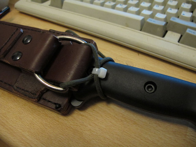

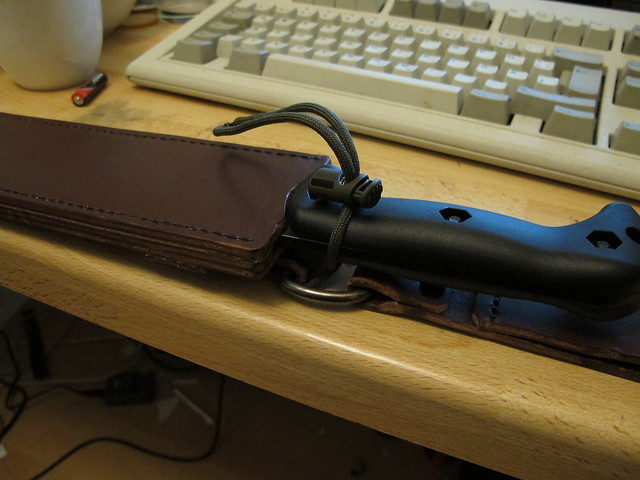

One thing: The pic that you have labeled as a close-up of your paracord retention is showing here as just a duplicate of the previous picture of the back of the sheath. Just FYI.

I also changed the retention paracord.
(The loop that the D-ring goes through is not riveted, those are chicago screws. I might have to take it off at some point. You never know, right?)
As you see, the belt loop is now absolutely free to dangle around. Great improvement. I have the knife strapped to my leg at this very moment, and I don't even feel it. Amazing for a knife that size.

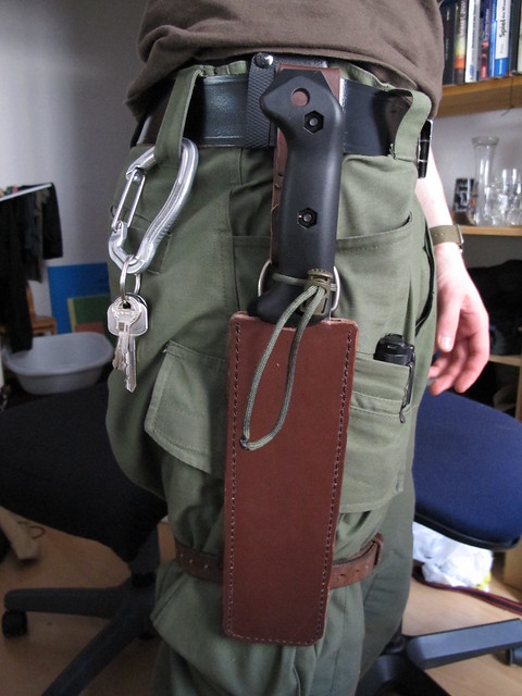

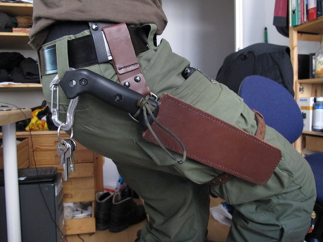

Here are the promised "on leg" pictures. The dangler loop and the leg strap really are a nice team. Very secure and very comfortable.
You can spot the following gear in this picture: Keys on climbing grade 'biner, BK14 in homebrewn kydex sheath (the IWB loop is just a little left from the belt loop on the BK9), a Fenix LD10 and a little random Fisher Space Pen. Aaaand of course the BK9 in its CRAZY SHEATH!

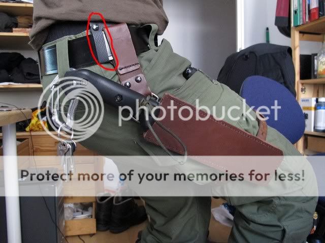

One question though; what is the keeper-looking loop on your belt right next to the sheath? Got it circled in the pic:
Wow. That is AWESOME! I am thinking I want something like this for my 9 in the future. I really like how you can bend your leg and such, the sheath looks really well done!
slapper, that's right. That's the IWB loop that holds my BK14 sheath. I don't carry it IWB (not very comfortable) but it rides between my belt and pants. Very secure and concealed, I hardly notice it myself. The ring was scrounged from an old belt. You know, that kind of belt with two D-rings. I looked at it and thought "that is just prefect."
Well, that's what I thought it looked like, another knife of some sort being carried concealed. But now I'm kind of confused, and wondering why you seemed surprised that I might carry my BK2 similarly in another thread where you asked:
But I'm thinking, is this something that you would really carry or are we talking about a "because I can" thing here? And do you really need to conceal your BK2 like this?
No biggie, I'm just curious why you'd ask if I "needed" to carry concealed (which I don't, and had said so prior to your question) when that's apparently how you carry your knife regularly from the way you just described it here.
