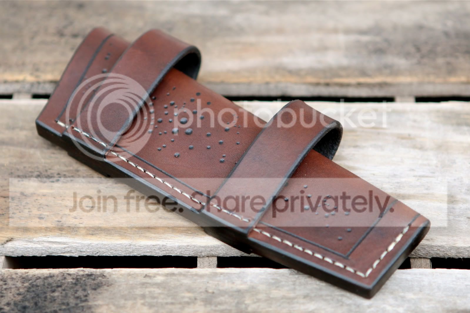

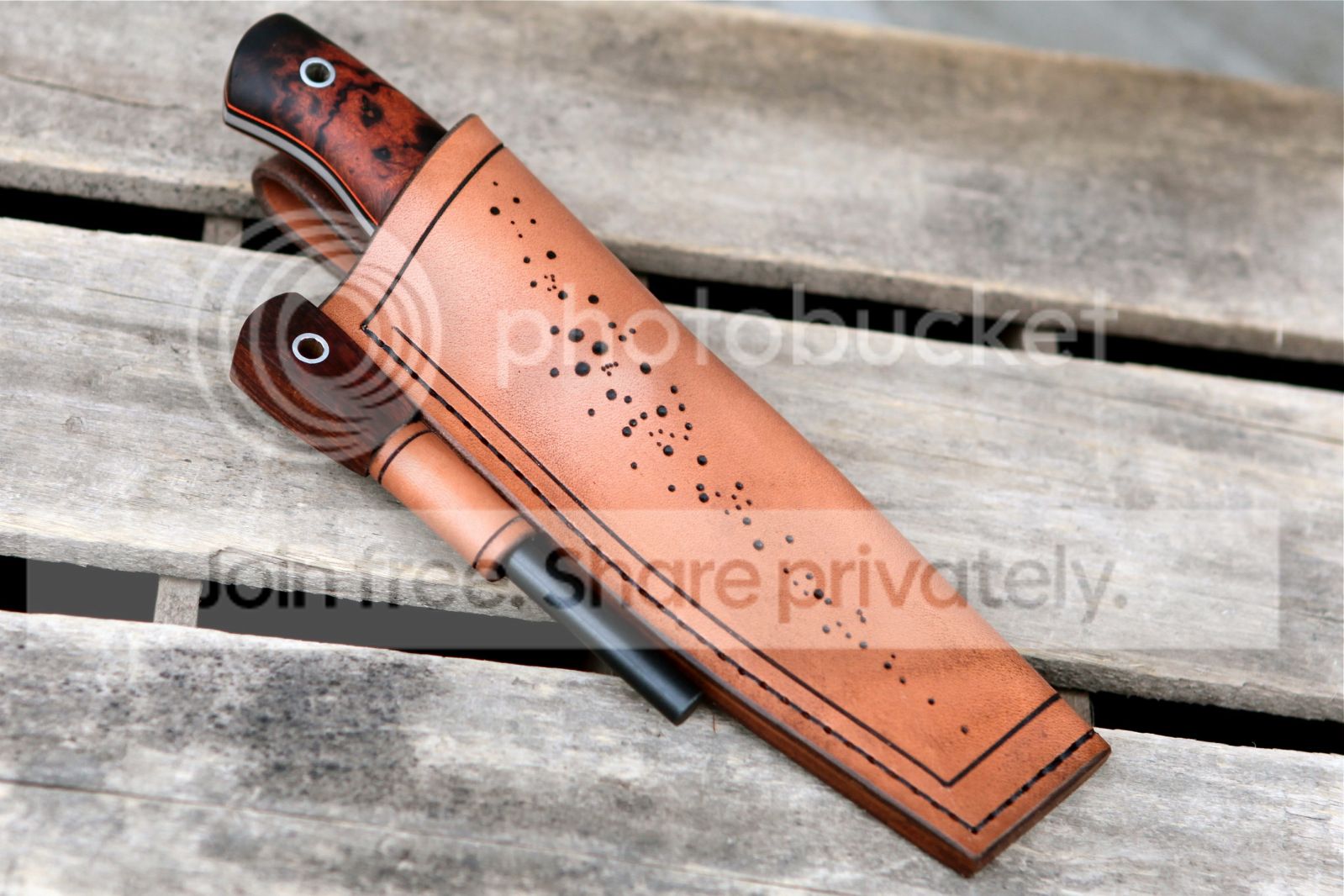

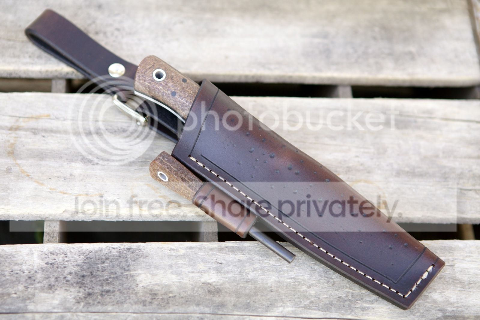

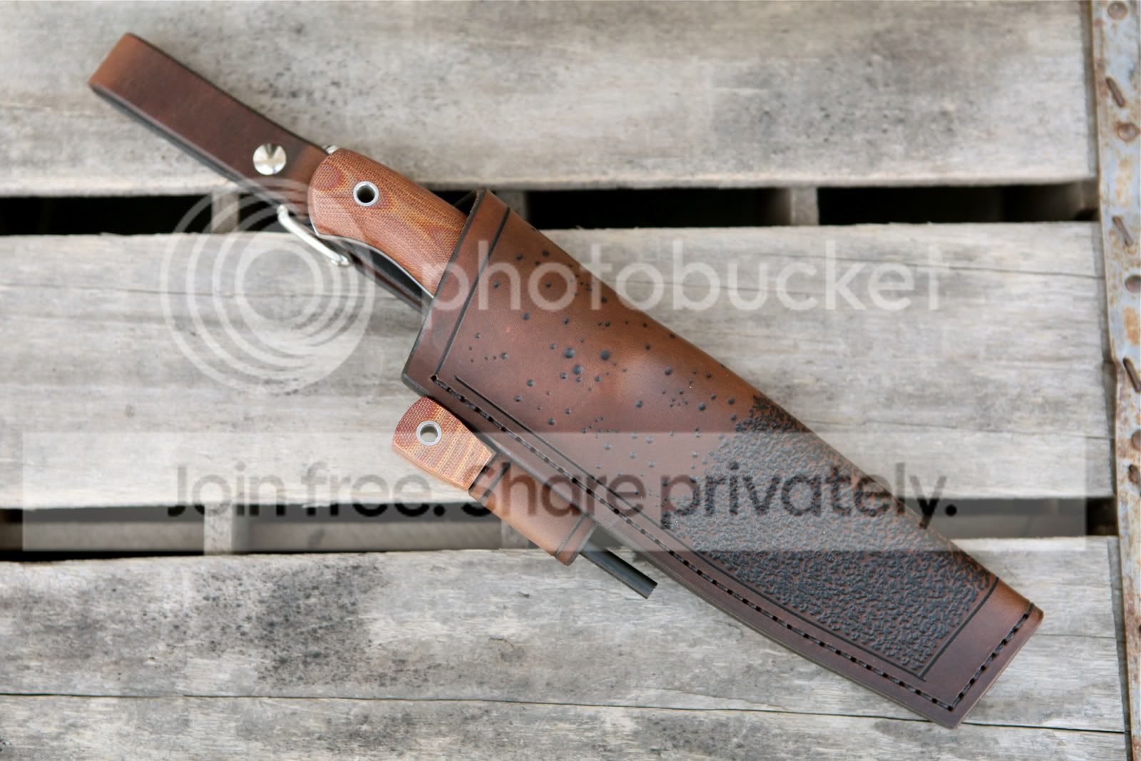

Here are a few pics.
This picture is hard to post because the whole setup was "lost" in the USPS system somewhere. I'm sure some slimeball is really enjoying his free knife.
