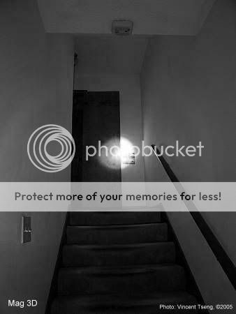

Not so long ago LED flashlights were regarded as efficient and frugal on batteries, but only "bright for what they were" and used only for close tasks and emergencies.
Since the advent of the Cree 7090 XR-E - LED flashlights have surpassed the brightness of the typical 2x lithium CR123A xenon light - like the fabulous SureFure 6P, G2 and Streamlight Scorpion (the one used most in CSI).
In fact even the single AA Fenix L1D-CE is rated brighter than these 2x CR123A xenons - this is simply incredible and unheard of just a few years ago.

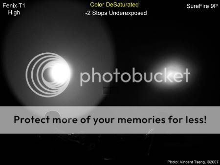

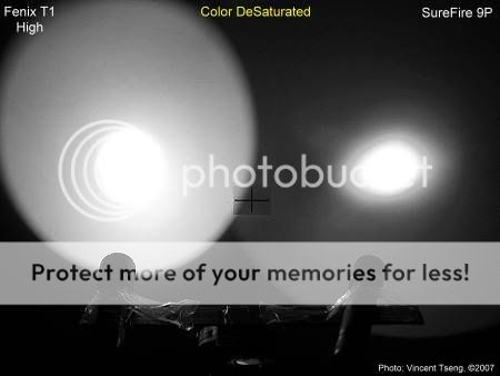

These comparison beamshots have had the color removed by deSaturation leaving only the luminance/brightness information - to remove any color bias/influence -
remember this is single AA battery light compared to a 2x CR123A lithium xenon light
- which is already brighter than a typical 3x D battery Kypton flashlight....
With the more premium Q-series Crees and LumiLEDs Rebels - and using more than 3 volts - we have now surpassed even the typical 3x lithium CR123A xenon lights - at one time regarded as the tops and "ridiculously" bright.

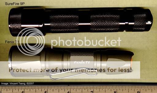

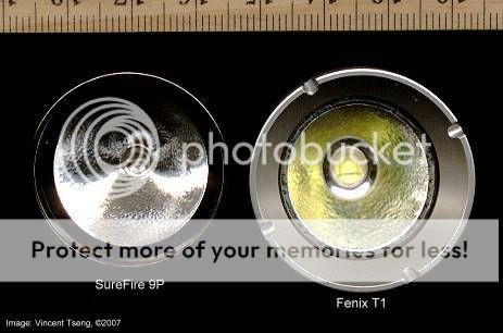

Of course one can see that just from the specs - the now legendary SureFire 9P (3x CR123 xenon) is rated at 105 lumens - the new Fenix T1 is rated at 225 lumens, that's a factor of 214% - so should easily be brighter, even allowing for inflated specs.
Even on the P91 ultra High Output lamp the SureFire 9P reaches 200 lumens - BUT runs for all of 20 minutes on 3x CR123 -
compared to the Fenix T1's 225 lumens, rated to run for 1.5 hours - similar brightness -
but 4.5x the runtime on 2/3 the batteries.......
In fact the specs of the Fenix P3D's are -
Q5 - 215 lumens 1.8 hrs;
Rebel100 200 lumens 1.8 hrs
Just to put matters to rest -

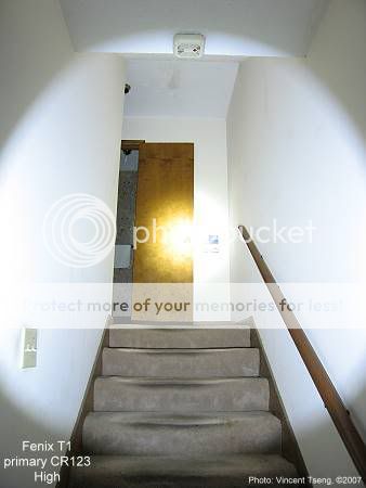

Fenix T1 vs. SureFire 9P (3x CR123 xenon - P90 standard lamp)
Still not convinced?
Practical stairway shots -
Color deSaturated -
That last shot is from a single AAA light - but using an AAA sized 3.7V Li-Ion rechargeable 10440 battery.
I think these shots speak volumes.....

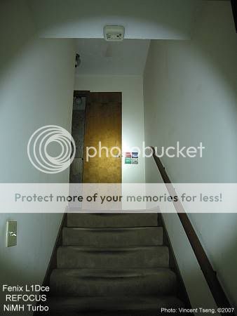

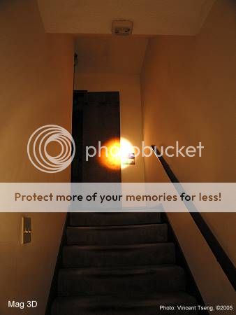

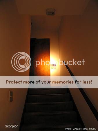

Here are the color versions of the same stairway shots -
~60-80 lumen lights
Fenix L1D-CE vs. Streamlight Scorpion vs. Mag 3D
Look specifically at the tiny test target to the right of the door knob -
especially where it's clear in the Scorpion shot for incand, and the L0Drb80 shot for LED....
This is the test target under balanced lighting conditions -
Not surprisingly the yellow bias in the test shots for incands is Huge.

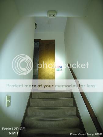

Fenix have their L2D series - the L2D-CE (Cree 135 lumens) and L2D-RB100 (LumiLEDs Rebel 100 - 175 lumens) - runs on 2x AA batteries -
Fenix P2Dce Comparison Review
Fenix L2D-RB100 Comparison Review
seems real close, but the RB100 has a larger overall beam circle so it is probably brighter in total output lumens.
I like both tints - perhaps with a slight preference for the Rebel. The RB100 has a much smoother beam - the CE betrays its notorious dark halo (this CE is an older version with smooth reflector, and the P4 Cree).
There is also the single AA Fenix L1Dce (and L1D-RB80) that's rated to reach 90 lumens on Turbo/max mode -
already mentioned in the opening post, and shown to be brighter than the 2x lithium CR123 xenon lights (like Streamlight Scorpion, SureFire 6P, G2), and Mag 3D
Fenix L1D-CE Comparison Review
I did my tests using NiMH rechargeable batteries......
