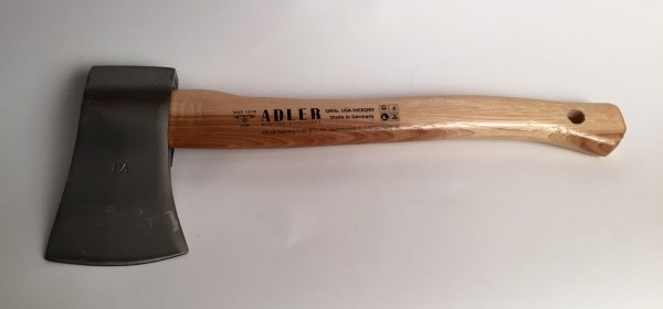

Here's the Adler:

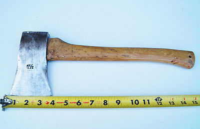

West German:
FortyTwoBlades - Were the Adler's you handled marked in any other way besides the weight?
There are obvious shape differences, of course. The Adler looks much more refined but they are new production.

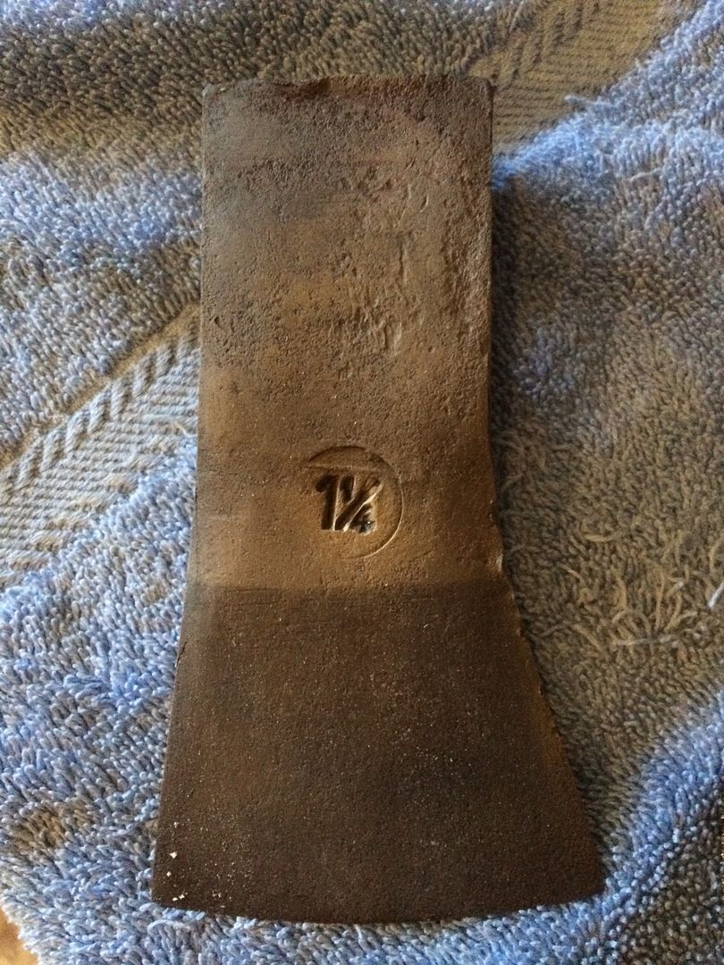

Since WECO was involved in imports from Japan and West Germany (as far as I know from my chair and the internet), I wonder if there is any reference to them dealing with Adler.
Your comment made me think of one I have:

Just pre-coffee rambling.
The only marking on the heads was the weight--nothing else. All other marks were on the handles. I still have a few of the samples I received from 'em, including a small Yankee.
