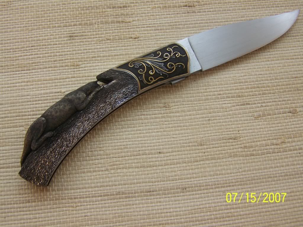

Here is one of my integraframe folders. One of my more ambitious engraving jobs, but more like this to come
The frame is 416ss, carved, inlaid and heat colored ( the leopard is heat colored a gold/straw tone). 22k gold inlays in the leopards eyes and on the scrolls and borders. The blade is S30V, Sawby lock mechanism.
