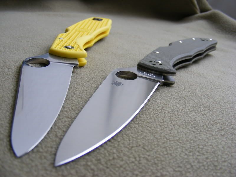

Then I remembered my Pacific Salt. Let me first say, pulling this knife back out makes me feel dumb. I've spent many hours looking at pictures and many hundreds of dollars trying out different Spyderco models. My favorites are the Police 3, CF Military, Stretch 2 and Manix. But the knife in my pocket right now is my Pacific Salt.
I recently owned a ZDP189 Endura, and I thought it to be the perfect EDC except for the ergonomics. The Pacific Salt's Endura 3 based handle works for me better than the Endura 4 handle, plus it's thinner, lighter and made of H1. I like the blade shape and length of the Millie better, I like the clip of the Police 3 better, I like the edge holding of the ZDP189 in the Stretch 2 and the Manix is still a little more ergonomic to me. But the Pacific Salt seems like the perfect EDC for me the more I think about it. *shrug* I digress.
I reprofiled the Pacific Salt free hand somewhere in between 15 and 20 degrees inclusive, no microbevel. I took the edge up to a 2000 grit polish, then tried carving some wood. It cut very deep and with little resistance. I spent less than an hour with the edge, which is much better than what it took to get my old ZDP189 Endura to the angle I wanted. The hollow saber grind means there is much less metal to remove than the flat saber grind of the FRN Endura 4. The H1 is also much easier to grind. I tried the new edge out on a variety of materials, including cardboard, thick plastics, food, more wood carving and opening blister packages. I noticed very light edge damage, just barely deep enough to be felt by my fingernail. This sharpened out in literally 2 swipes per side of 2000 grit sandpaper, but if it keeps up I might go with a 12 degree per side microbevel. This is the one draw back I've seen to H1, is that it doesn't like the ultra thin edges as much as ZDP189 and S30V seem to in my experience.
Since putting the new edge on my Pacific Salt I've lost interest in carrying my Millie, Police, Para, Manix etc. and have been sticking with it. It's so light and slim, and corrosion is no concern. It's less noticeable in the pocket than either the Police or my tip up Military (And the manix
). At it's pricepoint, I don't feel bad being tough on it, and if it gets dirty I can just take it in the shower with me. No concerns with water getting trapped between a G10 scale and steel liner and possibly causing rust or similar. A very worry free EDC. Did I mention how it sharpens very quickly, and takes a wonderful edge? Push cutting thin paper two or three inches from the point of hold after a sloppy sharpening? I've been cutting everything I can with it for the past few days, and I'm happy with the edge holding. This is always the case; that is after I reprofile and polish up any factory edge, the edge holding seems to improve. It's close to VG10. Not up to my super thinned out ZDP189 Caly Jr., but it takes and equally good edge in a fraction of the time. I have the SE Tasman Salt or sometimes the ZDP Caly clipless in my pocket for when I want something more abrasion resistant.
