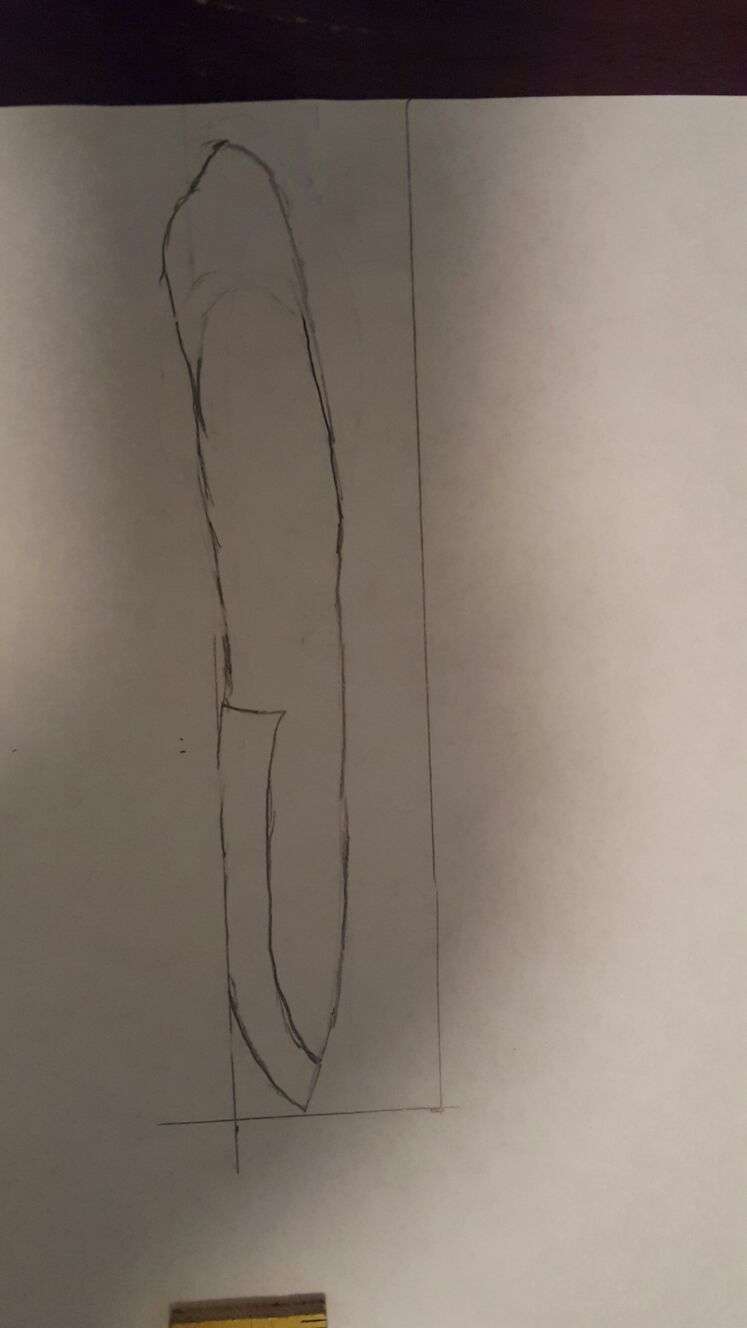

this is my design debating if I want to do wood handles or just wrap is in leather and epoxy.
I think your design lends itself more to handle scales than a wrap--so I would vote for wood--or perhaps Micarta or other synthetic..but definitely handle scales!

Your design is a bit too curvy.
Make a 7" straight line on some paper. Make a mark 1/4" above the center. Draw an arc from the ends through the mark. This will give you a slightly curved line.
Use that line for the spine of the knife (tip to handle butt). Now draw the blade edge, and lastly draw the handle bottom. You can make the blade spine straight, but have the handle curve down slightly.
Look at the Gallery and the Exchange for some photos of a drop point hunter. That dip you drew in the spine may seem cool to you, but is a poor feature. Keep the spine a straight line or a slight curve.

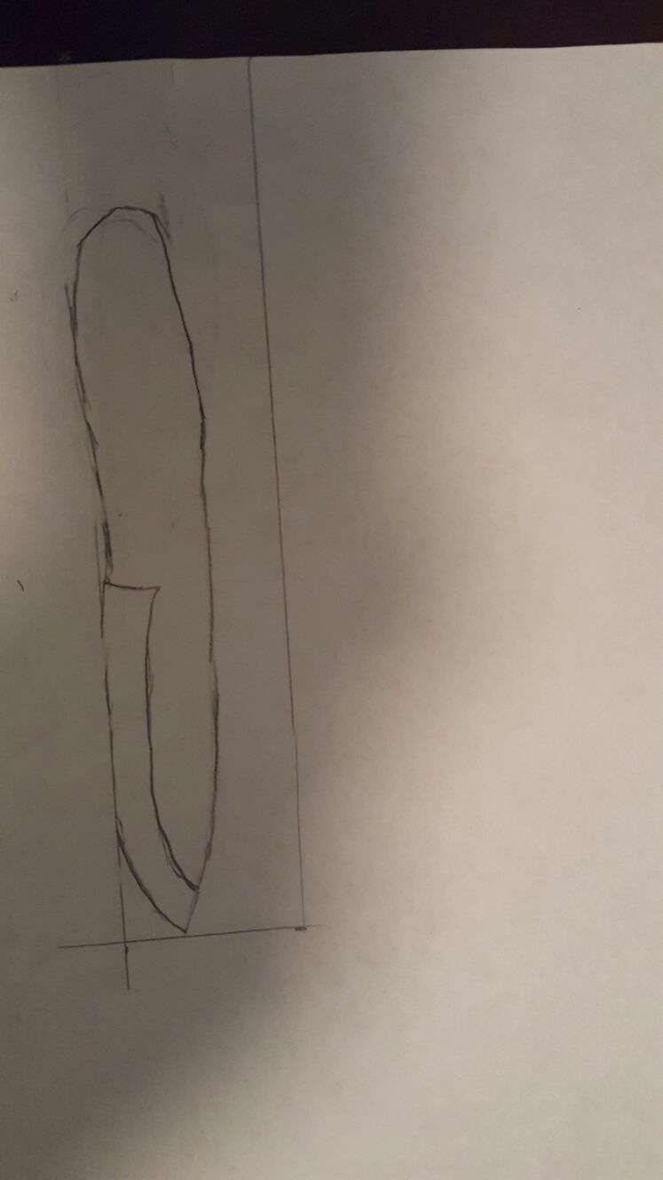

are these better

The first one looks OK. The second one looks better, but the handle is too long. If you moved the handle butt of that sketch up to where you erased an earlier try, it would be the one I would choose. Try drawing it that
