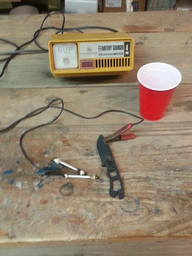

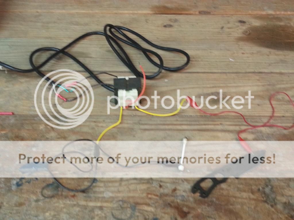

Well I did a relatively quick lunch break project. I etched in the logos deeper using the saltwater and electricity method. Here are the 2 rigs I used but will be working on a much more finished and device for the next units.
For the DC side I used an old manual 12V battery charger.
For the AC side I used a small 120/24V transformer and a couple test leads. The transformer does also have a center tap which puts out ~13V but I used the full voltage.
Now the etching is nice and deep, and I'm on to jimping and stripping. Debating on filing or electro etching the jimping.
