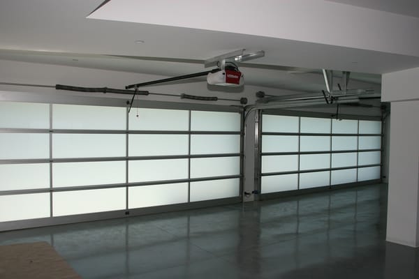

I think my vision is going dim as I get older and I can use all the light I get
I like Electric Fluorescent light daylight, but It's not the sun.
Even for "garage" vs "shop" use it's easier to see where you're going without having to turn the lights on.
As we know sunlight is the best light.
Plus I think it affects my mood, especially in the winter I should take in as much sunlight as I can get.
It has me thinking about renovations to the shop and what's possible
I've seen these garage doors made of transparent / translucent panels
They let light in, but you still can't see clearly through them
Plus they are more secure than glass, as they can't just be broken
I haven't found local or online info yet, I suppose I have to go for a drive and do some door knocking
and see of they want to talk about their doors
does anyone have any experience or anecdotes ? good or bad

Check the cost per sq.ft.of skylight versus windows that can be made with smooth frosty panel used in bathrooms that are easy to clean.. If the sun in winter hits a certain wall pickup a wall spot for a floor to ceiling glass block wall. The German made are superior for looks but the Japanese products look nearly as good and both will give a touch of air space for insulation. I work out of my garage and I just open the garage door for light if it is not freezing and when it is cold have a 4 x6 foot window and 12 for foot cool white flourescents to help as well as drafting lamps focused on my grinders. Call a glass company and ask for solutions and estimates. Skylights can really cheer up a shop. I use the same cool white bulbs that are in my kitchen and they aren't so stark and easy on the eyes if mixed with a little natural light.
Rust-oleum makes a "frosted glass" spray paint to use on windows you want light through...but don't want people looking through.

I have built a number of pole barns over the years with a 3' row of translucent fiberglass panels around the top and that lets in a surprising amount of light, probably not enough to work but you wont need to turn all your lights on
also I have installed a lot of these over the years and they also let in a surprising amount of light

Search for "lexan polycarbonate green house panels"
Light weight tuff and you can cut to shape, insulates too.
The light tunnels are made from a very thick plastic I doubt hail would be a factor, I have never heard back from any of the the home owners so I can only guess they hold up to UV reasonably well

I'm on my third shop built for my knife making. I put in the 4' fluorescents over the workbenchesand down the center where I also have operating equipment. They run end to end and about 4' apart on the width. This shop is entirely below ground but even on the last one with one very large window I had a goose neck lamp at every work station. I would suggest putting up a wall on the inside of the garage doors with a 6" layer of insulation. Which I did on the single garage door I had there. A gas or electric heater or two and an air conditioner will really work well. Your shop will invite you to go there winter or summer. Frank
I went with doors rated to R16. They were the best rating at that time. We have radiant floor heat in the garage and shop, and 2x8 walls with injucted insulation. Once at temp, if the doors don't open, we can maintain temp above 65f for about 4 days without any additional heat. :D Its a pretty efficient way to keep warm. The up front costs were pretty high though. It might be cheaper to go with the better insulated doors, and use only one row of Windows in the doors, and use a couple sola tubes. They collect light from all angles as long as it's light outside, quite different from a window which has limited direct light time comparatively.
