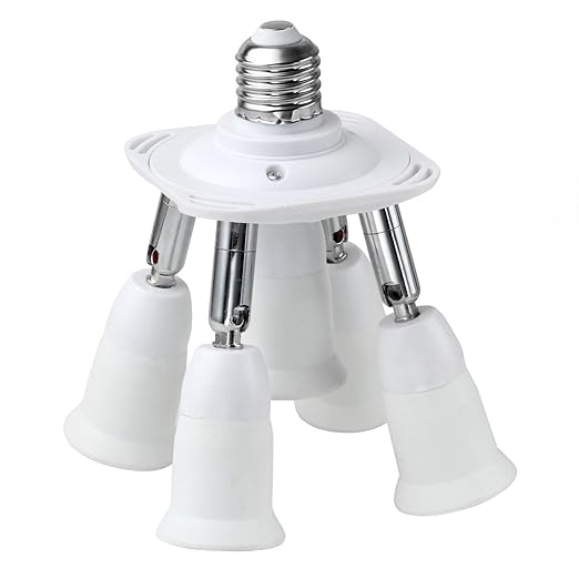

I'll probably get something like this for my overhead sockets, and fill them with 60w, 75w, or even 100w equivalent LEDs:
Should spread the light out a lot better than a single bulb, and with the directional sockets, I can dial it in to certain areas a little more precisely.
Nice Where do you get it ?
Home depot has a 2x1 Y splitter for five bucks ish.

I bought the direct wire bulbs from Amazon. 16 medium bi-pin 48" bulbs for $120 shipped. I believe the brand is Barrina, but I'm sure most of the Made in China bulbs are about the same. I have zero complaints so far. I've ordered stuff through work from sites like 1000bulbs.com, and they seem to have around the same prices.
The splitter I found on Amazon as well. They run about 11 or 12 bucks. I haven't ordered them yet, but I've seen a couple of guys on youtube that seemed to like them for somewhat of a quick and relatively low cost fix. Nothing to mount or wire, just screw in a few bulbs and go.
