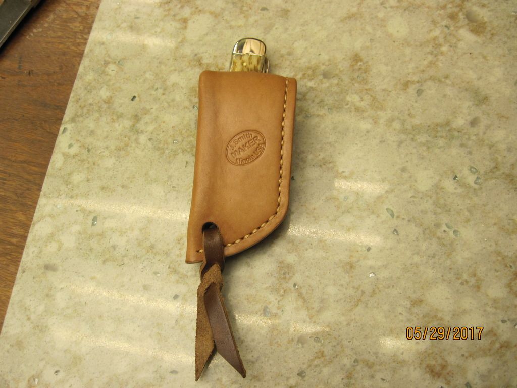

Its my second one Gary I sharpened the first one down to the nubbins, I'd used it so much. We make several things that have blood knots in them including Nichole's purses so we use it a lot. Also just about every knife I make has a blood knotted thong on it.

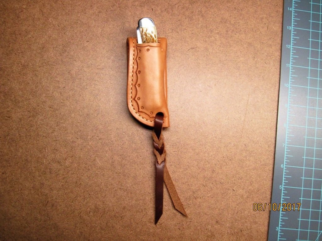

I finished this one up Dave. Do you think I should go a little deeper with the knife? It is tight enough in the sheath. I may redo the thong or I may make another sheath. Thanks for a fun project.

Looking good on that sheath darkmatter. yeah I'd say about another 1/2" or a smidgen more deeper. Lot of that becomes perception on the customers part. If it is in deeper it looks more secure. Nice job! Like your stamping pattern. The last slit on your bloodknot could be a hair longer. Thank the strings will lay flatter and underneath each other.

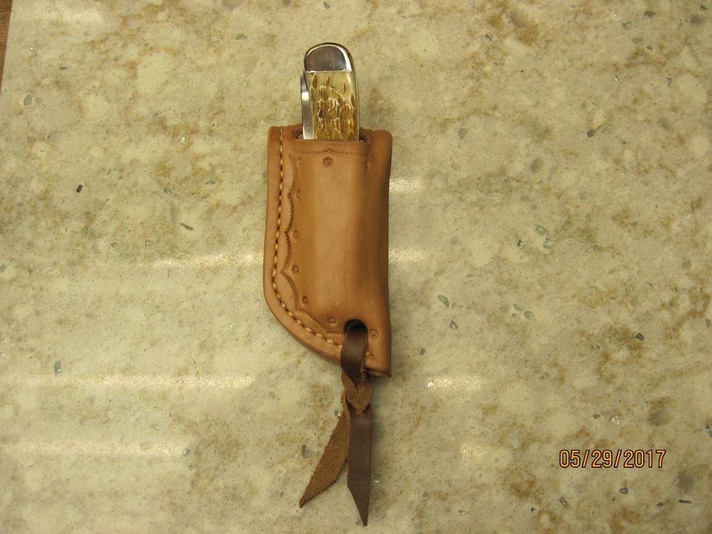

Here's my second try, came out better, a little tight but should loosen up with a little use. I like the type of sheath overall, it's sits nice on the belt, durable, and looks nice.
Thanks Dave.
That looks great John!! It really does, nice job. That extra smidgen of depth kinda helps doesn't it? Again kind of a perception thing in the eye of the user. Sorry late getting back been out of town at a wedding.
