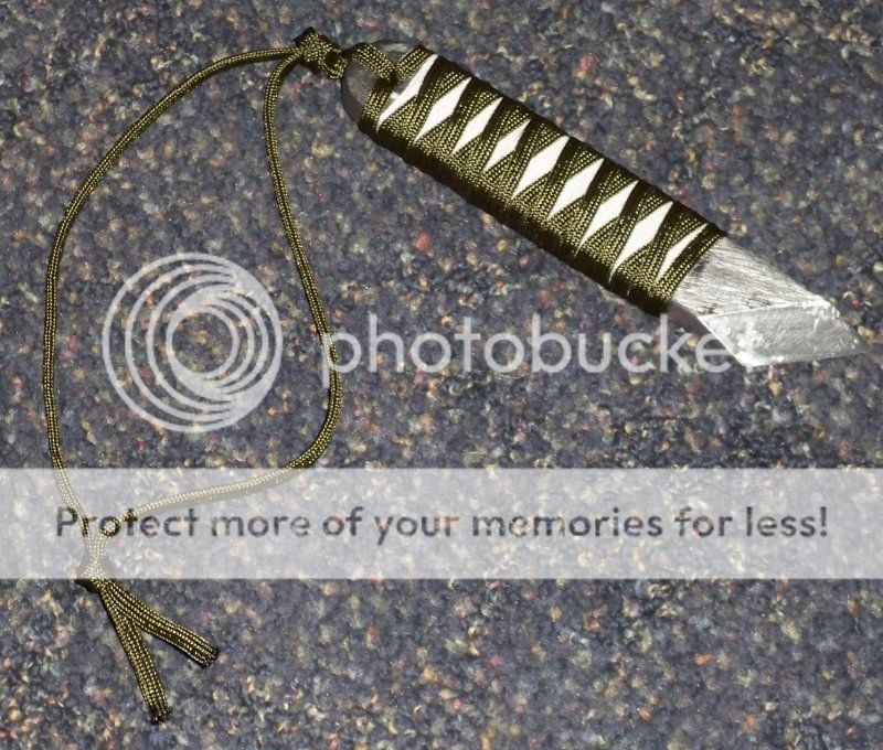

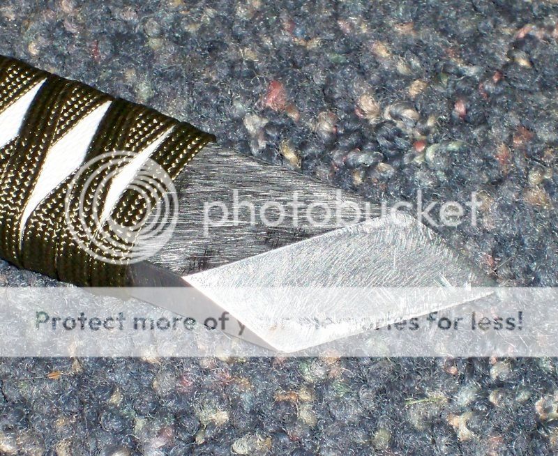

this is an idea that i had a mini kiradashi/ tool
dont worry though this is not the reason i startd this thread i have another kiradashi :D
material = 1/4 5160 steel
sheath = kydex
tools = scandi chisel ground edge, flat head, philips driver. or a bottle opener as you see in the pic.
Hardness = 60hrc

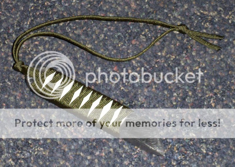

Daniel, I was hoping you'd post! I love your 'dashis, and also the pix of large batches of small knives at once. :)
Are your cord-wraps epoxied, then you squeeze the sheaths?
Thanks,that is very nice to hear!
I epoxy the wraps so they are solid and then mold the sheaths. Those sheaths were concealex, I recently switched to .060" Kydex and get an even better sheath.
