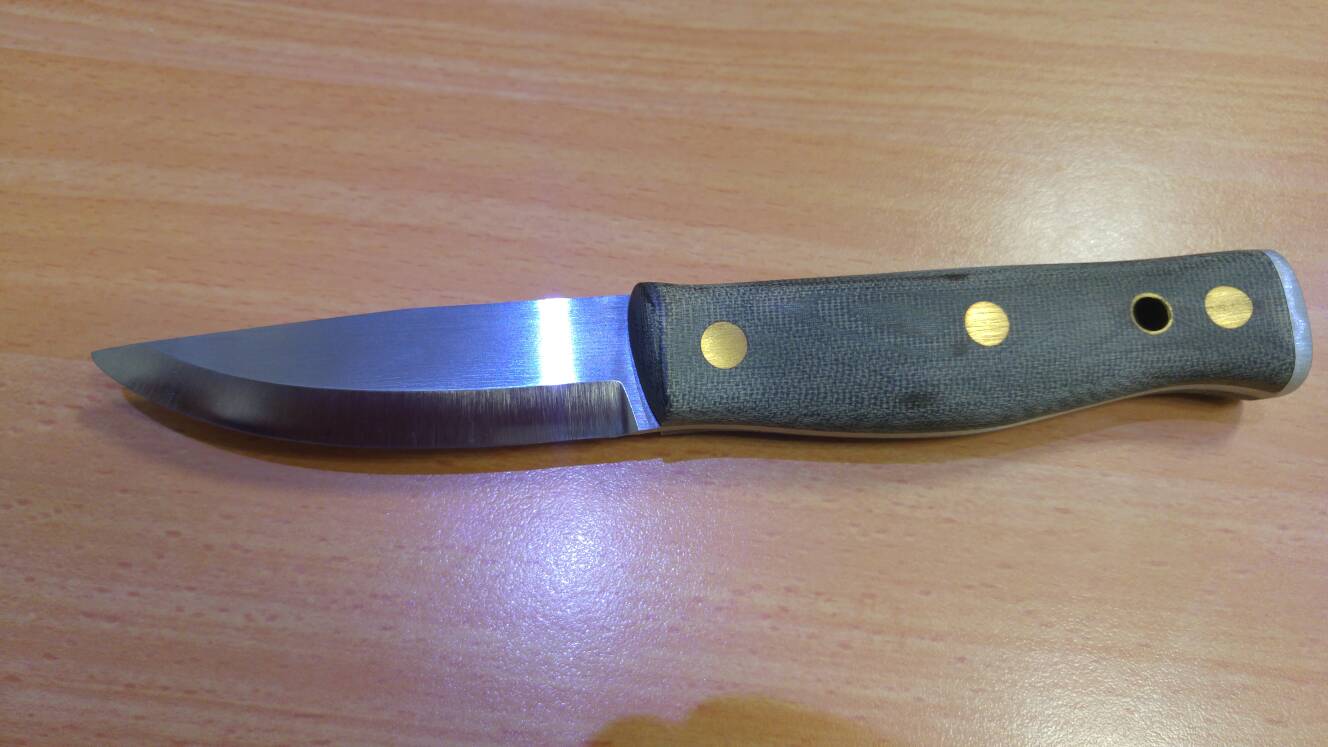

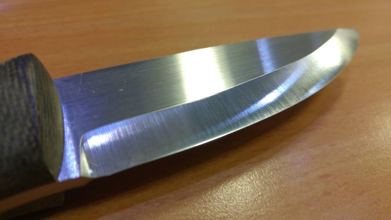

Did you replied to my post ? [emoji15]
I just got it 5hr ago from a member here, didn't cut nothing with it and didn't test it yet, I like the scandi grind on it and yes it needs a stroping and maybe sharpening.
Then you may not like the grind that the maker suggests:
The more stropping you do the more of a convex edge will occur.
