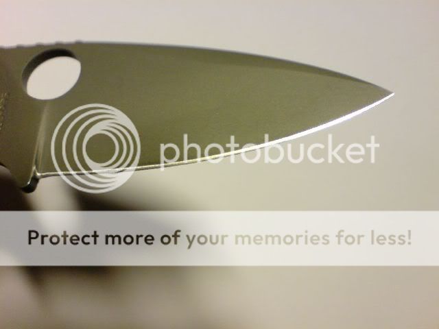

Here is mine, Tom Krein regrind ZDP Caly 3, reprofiled on my EdgePro bottomed out........ buffed up to 7000 grit, no micro bevel yet. I am going to wait and see it it chips. I think the black marks on the Apex model are 10deg. Not sure if that ten per side, or ten total (5 per side.) :confused: My wife thinks I'm nutz for even wanting a knife this sharp. I can't explain it, its like wanting the fastest drag car on the track. :D

My sharpest cutter is also a Tom Krein reground Spyderco. No it is not a beater that will take a lot of abuse but it is "stupid sharp".
Very nice! All though, the lady in the pic may not agree!

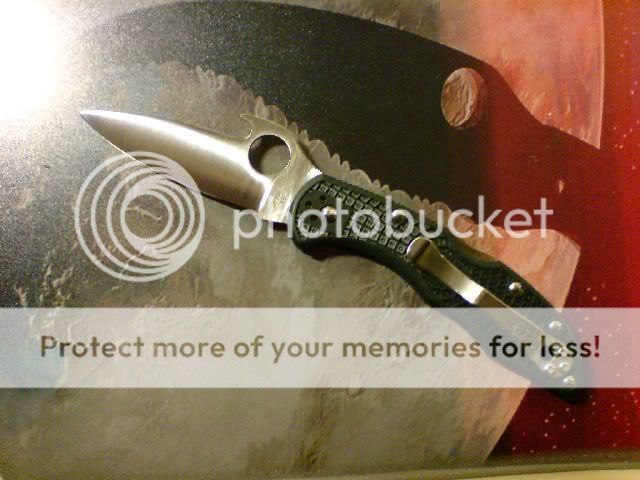

30 included ful flat grind. Done by Juergen Schanz in Germany. Although not as extremely high grind as your ones i'm very pleased with it's boosted cutting ability.
thanks Thom.
Background courtisy by Simona.
The delica is approx 25-30 included.

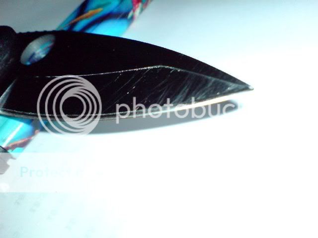

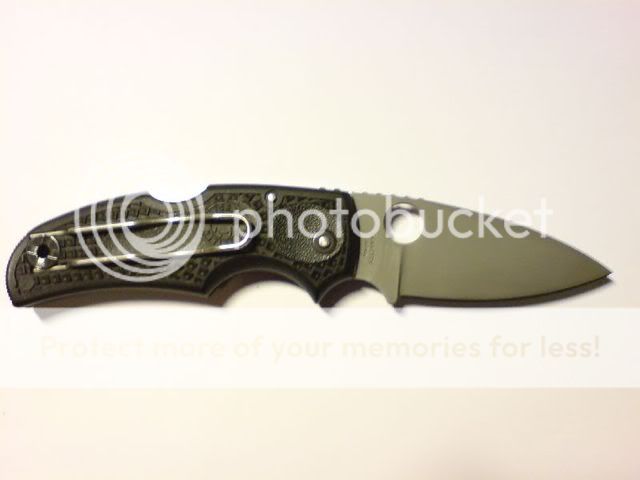

I also have this one slightly lower for work EDC:
And this is how the poor Native looked before the job;

This is an old pic, the small blade is now reprofiled to about 4degrees per side, and stropped.
