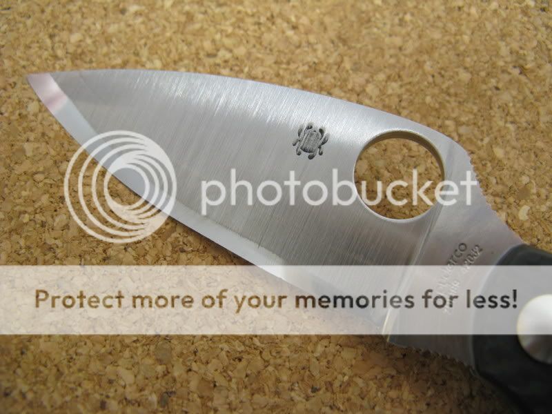

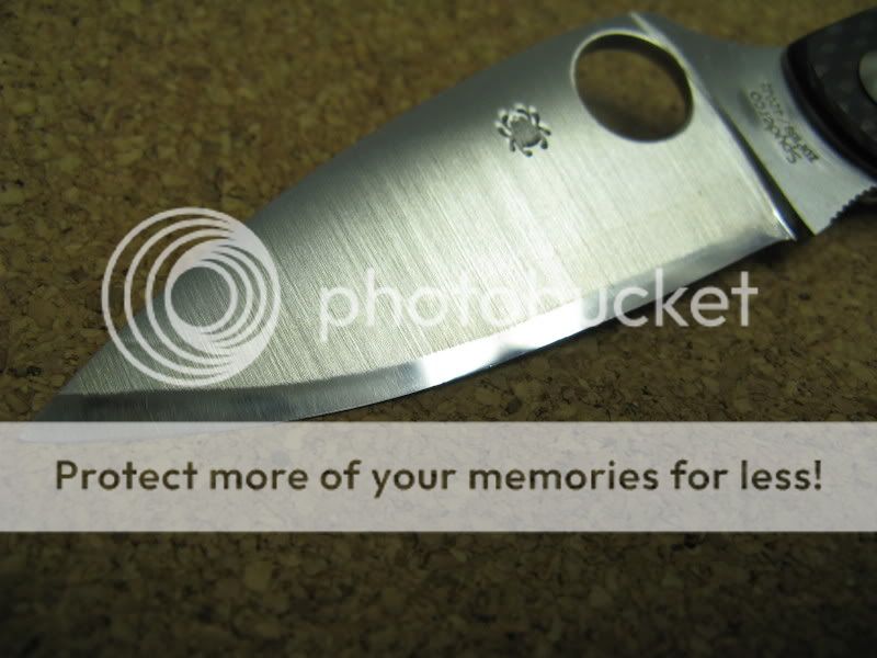

Here is mine, Tom Krein regrind ZDP Caly 3, reprofiled on my EdgePro bottomed out........ buffed up to 7000 grit, no micro bevel yet. I am going to wait and see it it chips. I think the black marks on the Apex model are 10deg. Not sure if that ten per side, or ten total (5 per side.) :confused: My wife thinks I'm nutz for even wanting a knife this sharp. I can't explain it, its like wanting the fastest drag car on the track. :D

So Lo , that looks like a heck of a slicer.
I think its 10 per side you should get a calliper (hope i spelled that correctly) to be sure.
I also spotted a little nick in the blade approx 1 inch from the back.
Could you post a picture of the blade at a higher angle so we can see the actual cutting edge better?
I guess 5 degrees per side would be to much so the edge would start to roll or chip easily while cutting.
Mine at approx 12-15 per side are zero full flat ground by a pro. I think they have more mass behind the actual cutting edge. I wonder if it could be done on benchstones but i doubt it as you would thin out the backbevel & microbevel at the same time. A beltgrinder has more flex so you can get a narrower and steeper edge compared to a benchstone. What do you think?
Now get yourself some shaving foam and start shaving with it. lol
