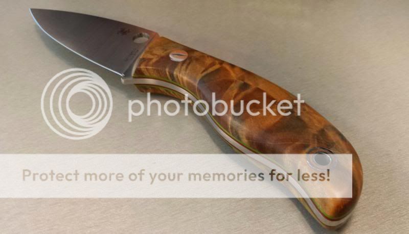

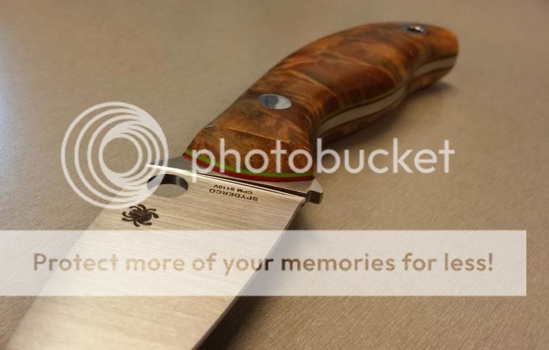

Here's my finished S110V. Brown/gold Box Elder scales with brick red and lime green liners. Hey Brian, I like the black and the tan g10 knives above. I have something like that in mind for my next project. Now if I only had the time...:p

Looks awesome. What kind of tube/pin did you use in the back? I have seen those on some knives but never came across them, so I can't try it.
-Brian-
Thanks Brian. The lanyard tube is my own making. It is a 1/4" steel tube inside a Garolite 5/16" tube which is inside a 3/8" steel tube. The Garolite was found at Usaknifemaker. I got the one with 5/16 Outside Dimension and 1/4" Inside Dimension. They all fit inside of each other and it is something different. I got the inspiration from Andy Roy with Fiddleback Forge.

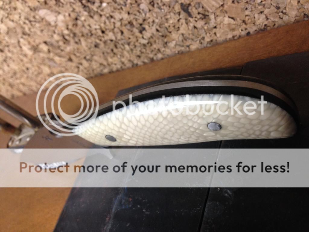

Got some major work done tonight! A surgery and some other down time got in the way, but I'm back on the road to S110V sweetness now.
Here I have my MT18 clamped, letting the epoxy cure on the scales and tang, along with the ti pins.
The scales are 1/8" black micarta epoxied to 3/16" white juma (I did this a few weeks ago). Pins are 3/16" 6AL-4V Titanium.
I was shocked at how bright the sparks from titanium are! They are a very brilliant white, very different from carbon steel. More to come in a few days!

Newb question here, actually 2.
Do you sand the handles down to final form during the final step? After they are permanently on?
Also, what do you use to cut/chop the excess titanium off with?

Yep, I use a bench grinder with a stone wheel on it to take most of the material off, then do the fine tuning with files and sandpaper after they are permanently attached. For the Ti pins, i'll use a portable grinder with a cut-off wheel to get them close to the scale (not too close - the heat will scorch the juma / micarta - thanks weatherman) and then files / sandpaper for the rest.
The only edge that I shape close to finishing size (prior to attachment) is the leading edge that is near the choil, it's really difficult to get it down to size after they're attached for life.

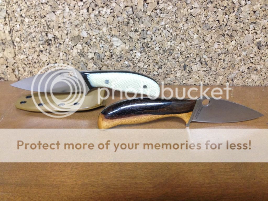

So I got my MT18 as finished as I'm going to ever get it!
1/8" Black micarta and 3/16" white juma "composite stack" Pinned with 3/16 titanium pins.
And a family photo with the MT17
