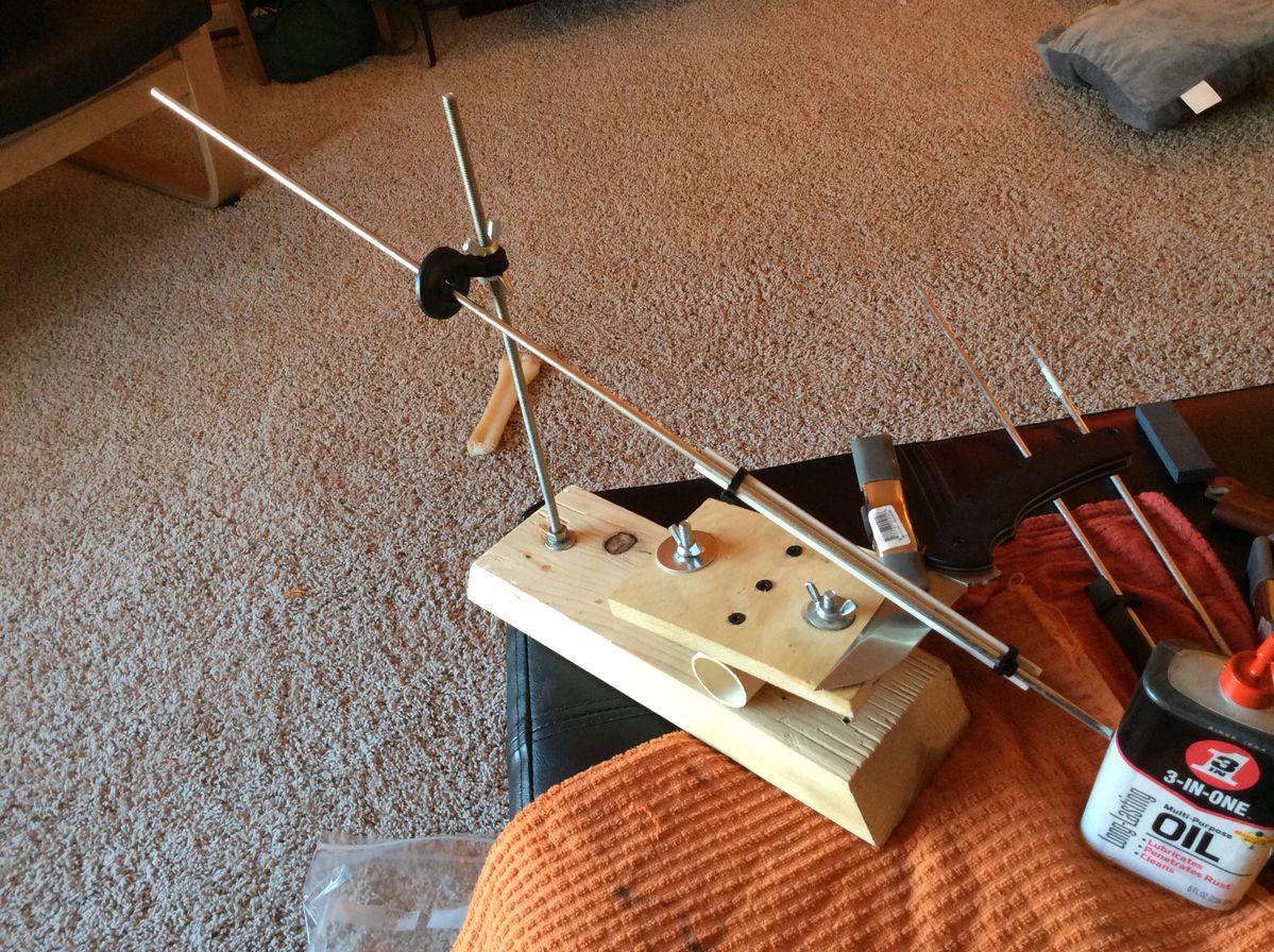

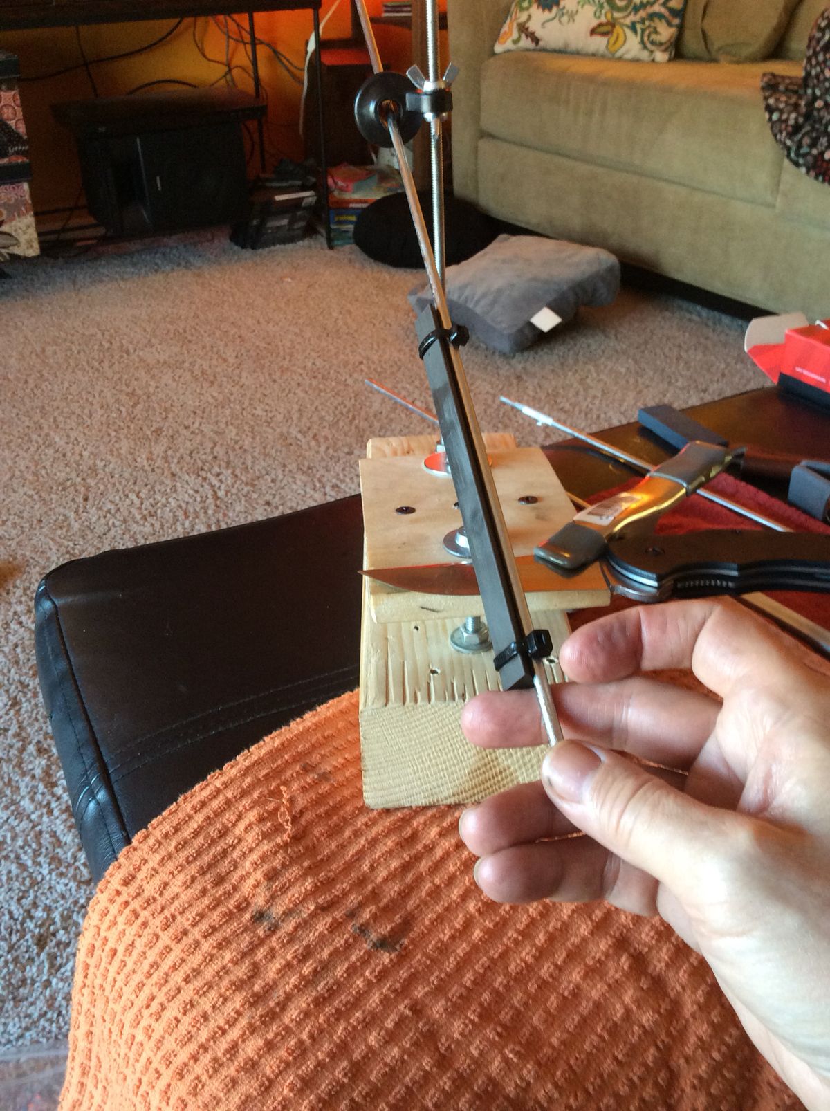

Lets see your home made knife sharpening devices
Nothing too complicated. I used plate aluminum, 1/4inch SS rods for the feet and the main hone holder.
Hones are EdgePro. SS springs to hold hones. Black plastic ball from somewhere and a good tap and dye set.
Just a small hobby basement shop and hand tools.

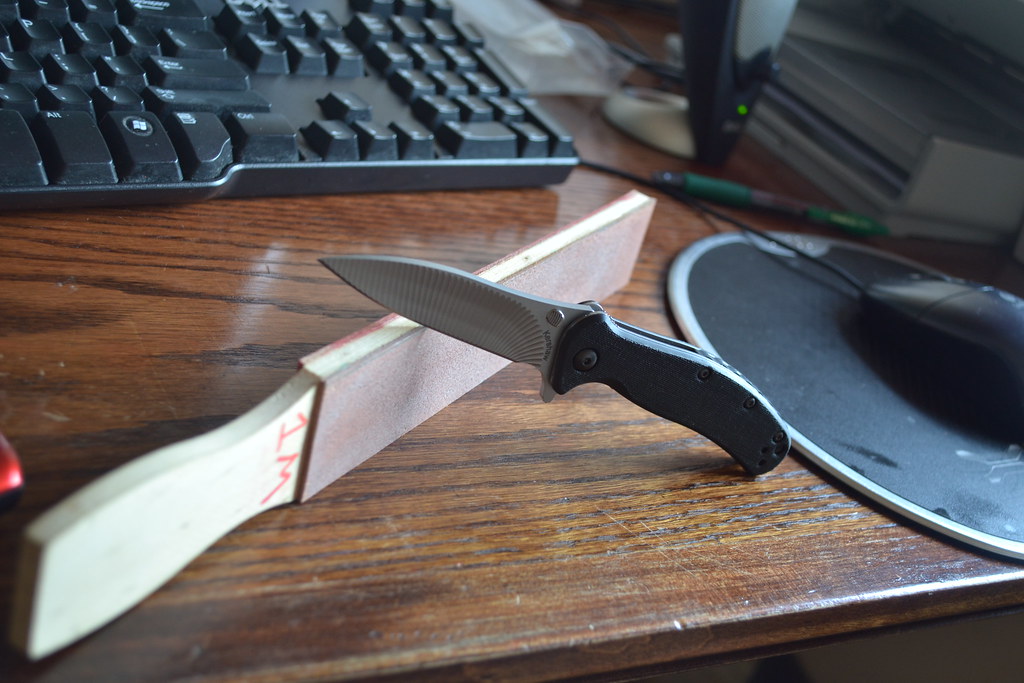

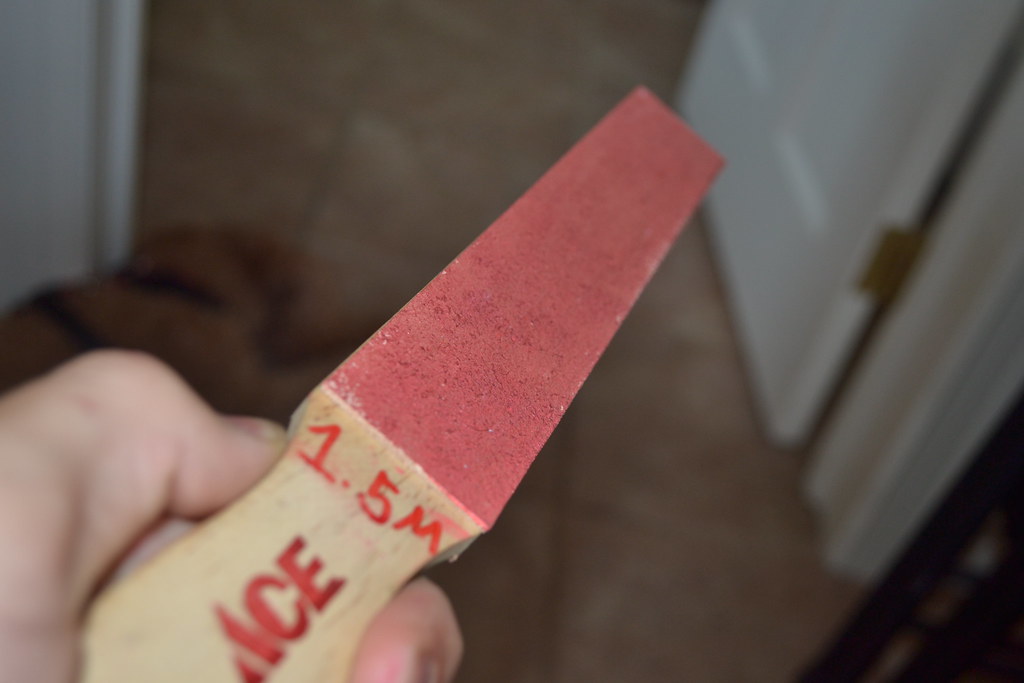

I've posted a new article called 'Hair-Popping-Sharp Knives' on Brink of Freedom. It's simple crude sandpaper system with the article designed for people that are not knife-geeks and who have been frustrated in the past with the sharpening process. Please feel free to comment away - I'd appreciate feedback from real knife people with a lot of creativity and technical knowledge on the subject as well.

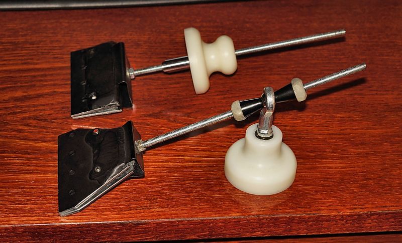

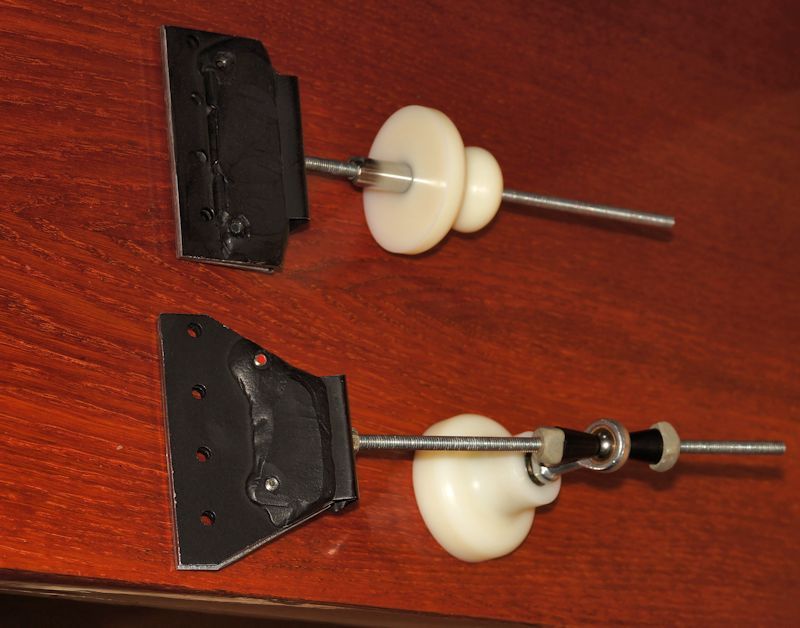

Description sharpeners:
Technical characteristics.
Height - 340 mm.
Width - 200 mm.
Depth - 750 mm.
Weight 2 kg.
The maximum thickness of the blade sharpened - 5 mm.
Sharpening angle (on one side) with a width of 25 mm Blade:
min - 10 ° C.
max - 35 °.
Changing the angle of sharpening when lifting (lowering) of the hinge assembly 1 cm - 1,4 °.
The length of the horizontal guide (without handles) - 650 mm.
Width of jaws clamp stone - 28 mm.
Sponge "Dovetail"-is.
L-shaped sponge - there.
The maximum distance between the clamps blade in their extreme position: 190 mm.
Blade clamps original design made ​​of steel 65 F, heat treated.
Horizontal and vertical guide 8mm diameter made ​​from stainless steel, have a hardness of 58-62 HRC, surface roughness 0,4 Ra.
All questions in a personal or send mail: zato4ka.zzm@gmail.com

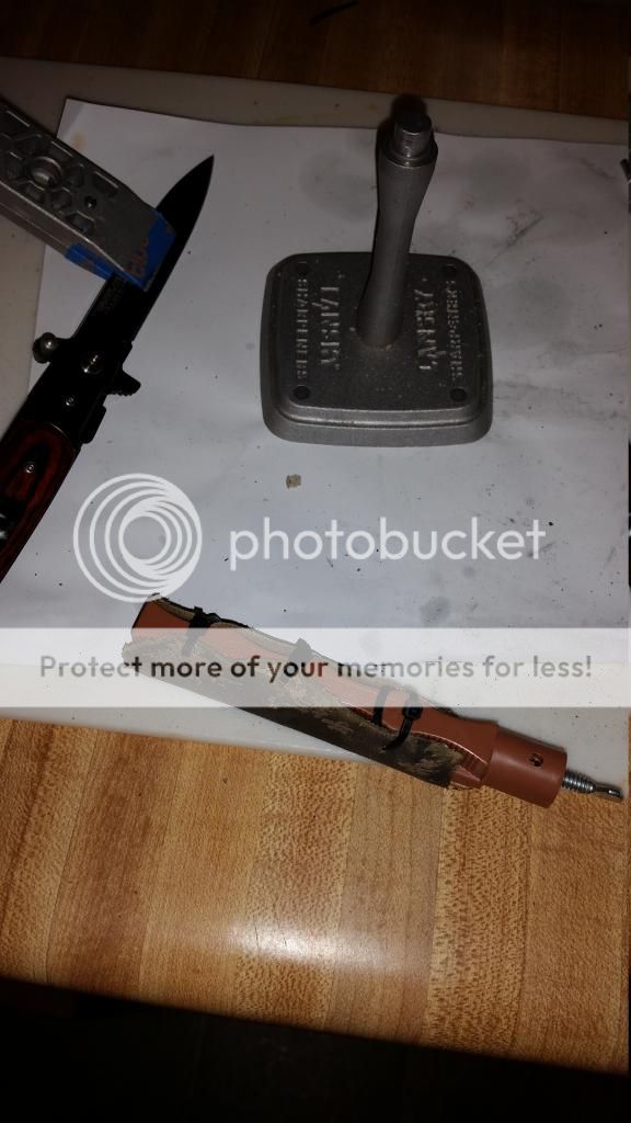

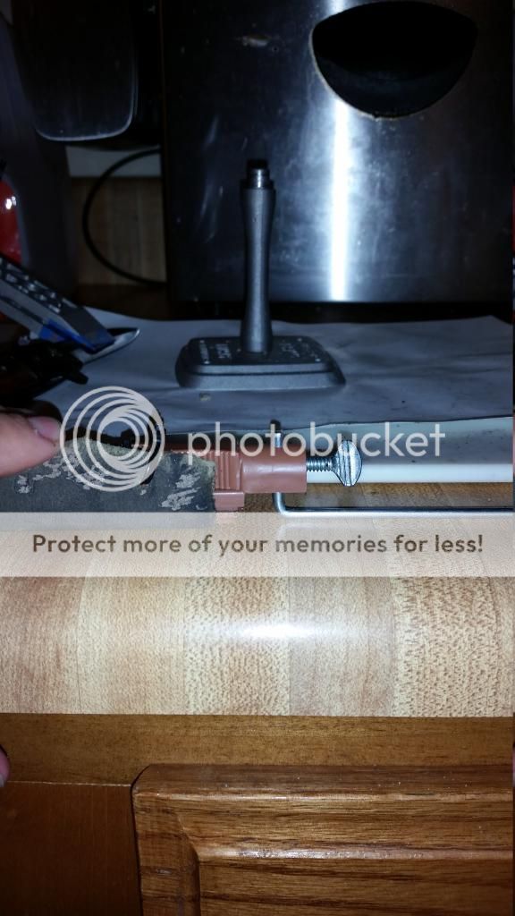

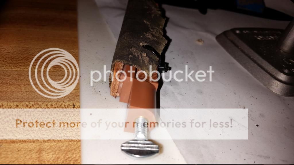

i know this isnt as intricate as some of the others, but i cut some strips of leather, since i use like 6 compounds. leather punched some holes on the top on both sides. then zip tied them down tight. this way i dont have to buy six-seven, lansky strops that cost a million dollars a piece. and i can play frankenstein and mix compounds together and make a super compound.

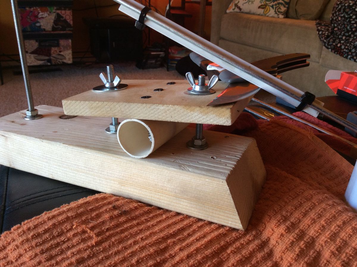

Well. I'm building a final one that is larger than this one. In this a can reach 13° each side, more than enough for me. I also insert magnetics to help hold knife in place. The magnetics are 2 pieces measure 30x10x10mm N35. I did this one because my newbie experiences with hand sharp was not so perfect. And it works, it really works. The ramp have 20 degrees and I can sharp since a Spyderco Grasshopper to a 12 inch kitchen knife. Now I'm build one that I can sharp a little machete with 24 inches blade. I also put on two clamp with leather on bottom of clamp.
The white in front of ramp is a tape to avoid contact blade/magnetic and it make cleaner easy.
As I don't have access to right tools to make it perfect but I'm very happy with results.
I know that is more of the same, nothing new and for the value I could buy a generic edge pro but in build process I learned a lot.
