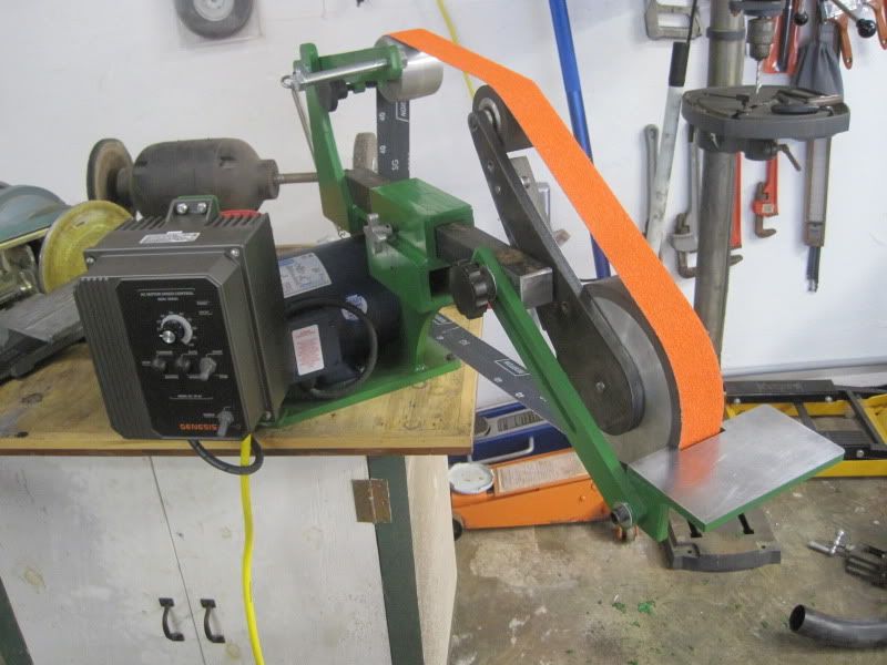

I should be done painting it this weekend...but here it is midway. It's going to be green. :)
I got the 8" wheel with platen and small wheel (3/4"). I also put a 2" contact wheel on the top of my platen.
I haven't used it much, yet. But I've noticed that it can take a while to get really dialed in. That could be the result of inexperience with it. But once you get it set where you want it, it can be extremely helpful.
I got the 1.5 hp Leeson from Beaumont as in our current place I have to stick with a 110v motor. When I can afford my next motor, perhaps I will be in a place with 220v outlets. I can get my variable speed then. ;)
Hope this helps. :D

There. Finally. Next step is to get it dirty. :)
...and put up more lights. :D
