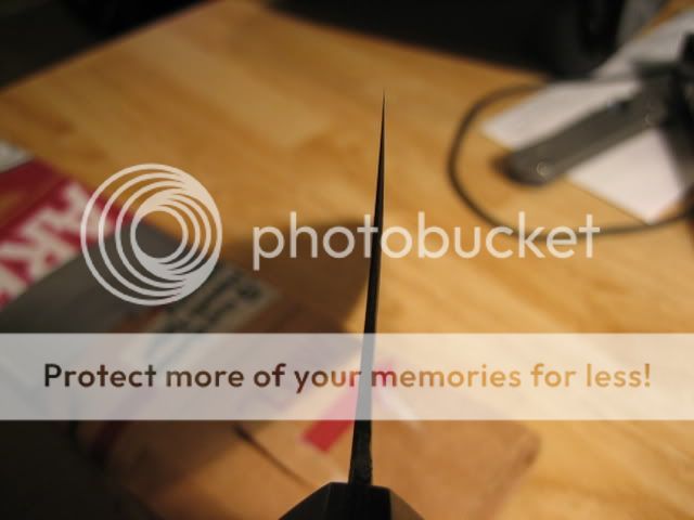

My Takeda 240mm Gyuto (or Chef's knife)
It cuts okay... :D
My Takeda 240mm Gyuto came from the factory at just over 4 degrees per side, and it cuts like a demon. As Roman Landes says, "Geometry cuts". To get rid of microchipping I went to a 10 per side microbevel polished to .05 microns, and let me tell you this thing can really do some impressive things on paper and hair, and bites through your fingerprints when you try the Murray Carter 3 finger test. Unfortunately I haven't had the luxury of cooking with it since the latest sharpening, though I predict plenty of guillotining fun on over ripe tomatos or whatever I have the pleasure of cutting with it next meal.
Mike

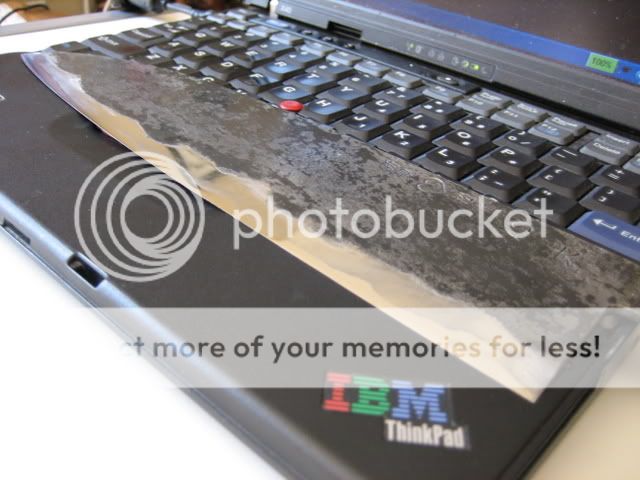

Here's the little PECK I just reground. Thinned out with a larger bevel that's very slightly convexed. Bad pic, I'll have to take a better one in daylight.
Here's what I was talking about, highlighted in red:
That was just the remnants of the marker used to write the hardness on the blade. I was too lazy to wipe it off before taking the pictures.
Mike
Edit to add: My picture taking sucks, so it is just an optical illusion. The more I look at the pic the more I see what you are saying about it looking dented, but I can assure you the only dents are the 2 dimples from the Rockwell test.
