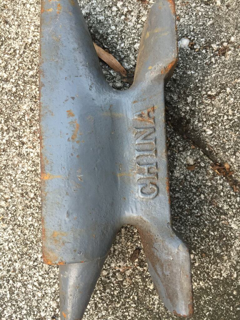

Would anyone trust this?
Lol !Prognosis is not good.
But trust for what ? Keeping your rowboat from drifting away...?
Anyway, fwiw, about 18 years ago HF was selling Russian made 50kg cast steel anvils. They were not bad considering their price.
I bought a few & made swage blocks of. I expect they turn up second hand on the usual sources.
