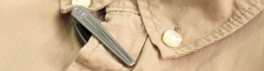

Ok, here's my most comfortable clip:
This is to show height from the handle:
(One with the matchstick inside the channel):
This shows the grip (note how the flare fits into where my middle finger rests, the slight swell at the ring finger, and there's a recess for the pinky):
This clip could only be improved by being deep carry. Even if it pushed the margin up a bit into the pinky area, it would still be better as deep carry IMO. Hope this helped.
