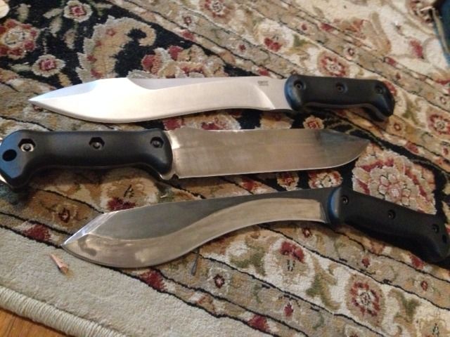

Hello everyone this my first post on bladeforms.
Ive been doing some tests with my blackjack brute and kabar bk4 and 9. I do agree with the general consensus that the the bk1 is worst of the three when it comes to chopping. However, that thing can baton just as well if not better then the bk9. Whenever you look at the bk1, you can't help but think that it's a knife that's just designed for batoning! This knife needs to be reproduced! I no Ethan has said it won't happen because he has other designs that out perform it. But still, it should happen: people would buy it. The other knives don't massively out preform it. This knife can still compete with the best.
Now I'll step off my soap box…
Bk4. I got one fairly recently and love it! I no the bk9 is the big kid around the block but I like the bk4 better. The recurve on the bk4 is awesome. I can do small tasks better on the bk4. The bk1 is too top heavy for that. Now on the big debate that the bk9 can out chop it the bk4. I don't think thats true. I think the bk9 is just more user friendly. The sweet spot for chopping is bigger on the bk9. I think they both chop equally, but the bk4 just takes more technique. I'm sad that the bk4 is being discontinued. I'm sure the odd blade shape is why it's not a popular seller.
I'm going to put down my bk9 for a while and show my bk4 some love. The 4 is going to be the new chopper I keep strapped on my pack.
Thoughts on the whole bk1, bk4, b9 thing?
Also: I've heard talk about petitioning kabar to make the new batch of bk1s. Is this going to happen? Lets get organized and make it happen!

I've done a fair amount of side by side by side comparing of these three blades. I'm on a couple acre suburban property with over a hundred trees. Lots of opportunity to experiment with wood processing blades. I bought the BK1 originally because I thought it would be a monster and make clean up chores or processing firewood easy. It does a fair job compared to the others but I can't see it ever getting packed to go anywhere with me. It'll stay right here at the house as others can do the same or better job and are a better carry. I thought for a while the BK9 would be my always go to choice. It's big, its got good reach and is manageable if you're on a ladder whacking suckers or other unwanted limb starts. It batons well and after taking down larger limbs or cleaning up fallen ones, it makes short work of delimbing for clean up. But, the BK4 has been getting a lot of love from me over the last couple of months. It does all of the above and the shape just makes it a more comfortable chopper and processor to me. I'd say the BK1 is a 'nice to have' if you're collecting Beckers (and I am) but the BK9 and the BK4 are must have's if you want to get some work done.

I've never held a BK1 and have no plans to ever go looking for one based on feedback about it. But I totally agree with your assessment of the BK4 against the BK9. I'll take the 4 just about every time, certainly as a carry-in-the-woods blade. Lighter, does several things better, and everything as well as the 9 imho.

If I could only have two bks it would be the 4 and the 15. Both slated for the ax! I much prefer the 4 to the 9. I agree with the op in that I find the 4 more versatile. I disagree with the op in that imho the 4 is more user friendly as to everything I've done with them, with the exception of sharpening. I better check my stash and make sure I'm good. These two blades are pearls.

As cool as the Brute is....I just don't think it compares to the 9 or 4.
It batons well. And it.....it can baton well. Lol
It really is unwieldy and handle heavy.
The 9 is more nimble and outperforms the Brute. It really does.
The 4 is more of a jack of all trades woods knife.
If I could choose only one of the three, it would be the Machax. Hands down. Versitility wins!
The Brute is cool, but I enjoy the rest of the BK&T lineup as far as performance is concerned.
