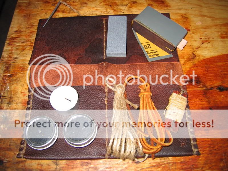

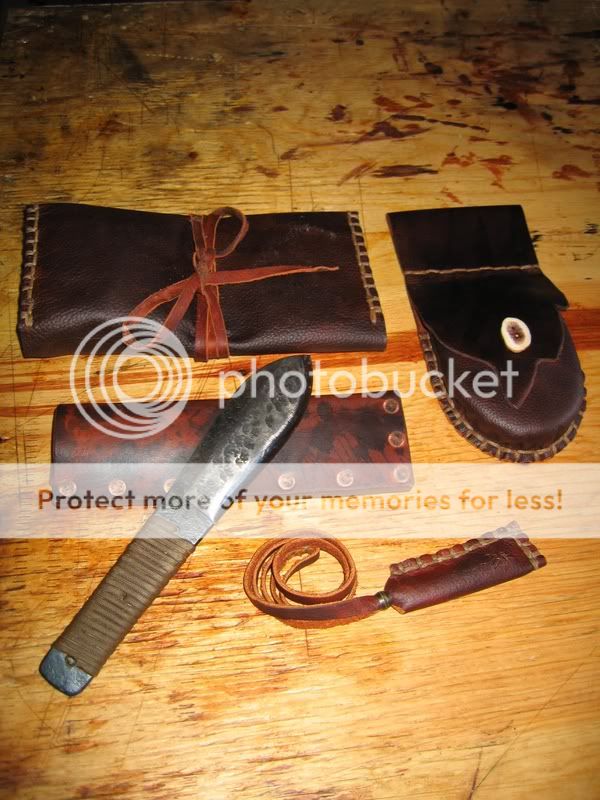

I made this little "Utilipouch" that contains a sewing kit, cordage, char making tin, beeswax/lindseed mix, 5hr candle, FAK (not pictured) and a sharpening kit . The whole kit is 4"x 9" closed.
The sharpening kit consists of a norton two sided stone to repair damaged edges, and a sanding block that uses wet/dry paper and is backed by a 1/4" thick pc of compound impregnated leather.
Rick
For size reference.... the knife is 9" OA
