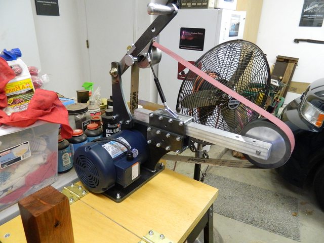

I built a second grinder to go horizontal because I thought that I needed it. I did not it turns out....but I bought a Travis Wuertz surface grinding attachment for my KMG grinder and did not like the vertical configuration one bit. I wanted the attachment to work like the one on the TW 90 grinder so I milled the last 8 inches of an aluminum tool bar to be the same dimensions as the Wuertz grinder and mounted the contact wheel to my horizontal Polar Bear Forge grinder. If it wasn't for the surface grinding attachment there was really no great reason to have the horizontal grinder. Here's a couple photos. Larry
That last photo with the rest makes me want a horizontal grinder.
