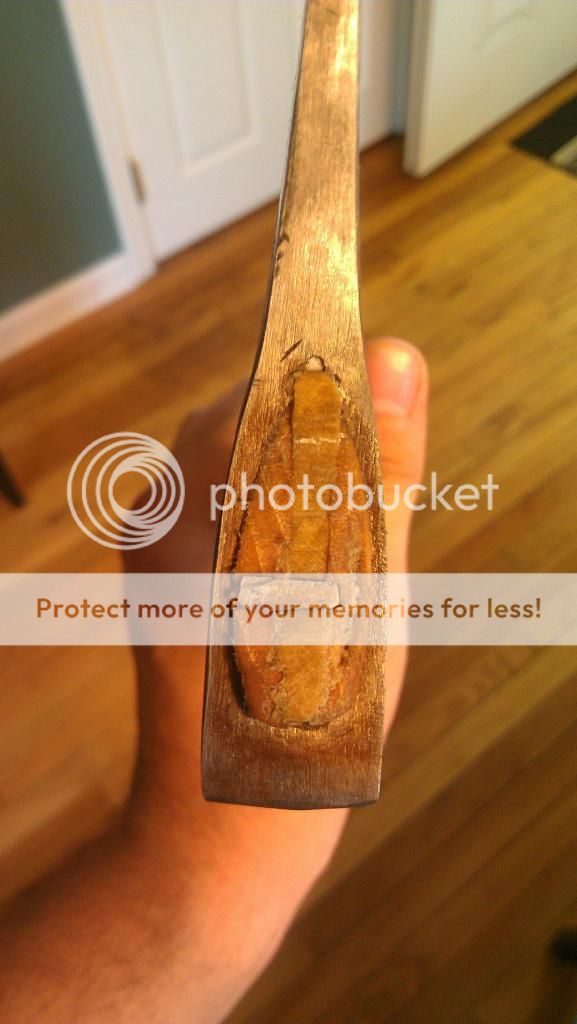

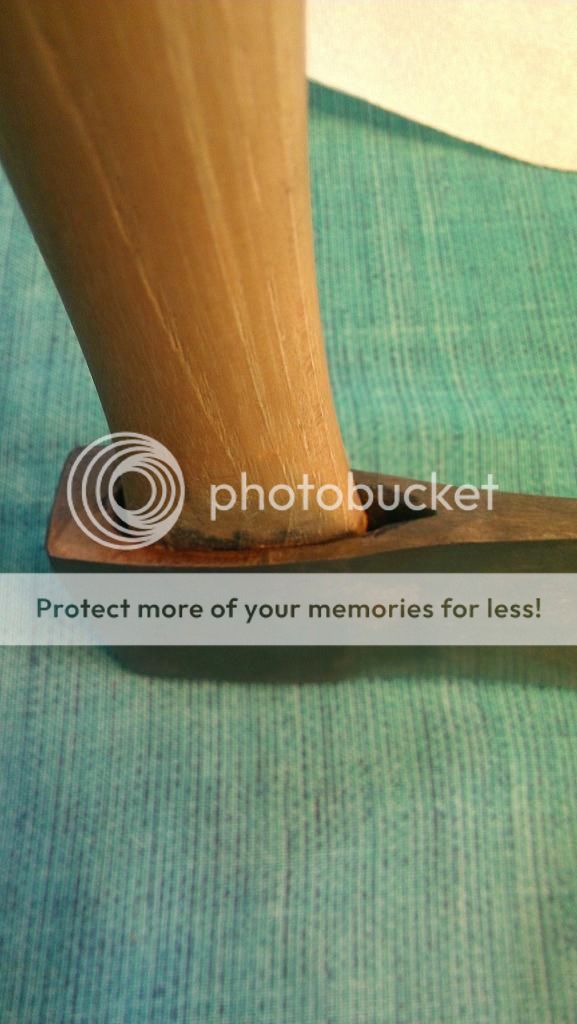

It looks like you did a great job hanging it, except I think it's upside down. Sorry to bear bad news. You may want to flip it or just use it until the handle breaks, then rehang it the other way. Otherwise the refurb looks great, and you've got a good quality hatchet that'll last a lifetime.
I thought that too but it's not. Oddly enough the beard was flipped that way when I got it and the smaller eye is definitely on the top. There is not other way to hang it. I thought it was wrong too but it would seem the dropped forged head from Germany really was done crudely
I think the tapered eye should have the larger portion above (some double bits are like that). That way when you wedge it, to spreads the top so the head can't come off. I think it was probably hung wrong when you got it.
Really? I am vary new to this but that seems like it would be vary odd to remove that much of the handle to feed it to the larger eye. But hey i'm probably wrong, after all this is my first axe restoration (if you want to call it that)
In most cases, yes. The beard is typically longer facing the bottom of the handle. And it's definitely common to have to remove a lot of wood from a given handle to get it to fit, as axe eye sizes can vary wildly. I've had to remove tons of wood off some of the link handles to fit onto some of my vintage heads. Other sometimes almost slide right on with little effort. Once you get the head seated, the material removed will leave a gap in the top of the head. Then, when it's wedged, those gaps are taken up by the wedge. That makes the head form a tight bond with the handle and it'll stay put for many years.
Ok, so then even if this is hung incorrectly (which I still find odd) will this effect the performance? Should I just get another handle and do it again?
I'm no the pro these other folk on the blade info, but as far as the handle goes, I would re haft it. I see it breaking loose over time with that much gap on the bottom. It would be completely worth the time and effort to trim and reshape a handle to fit perfectly imho. I've redone a few axes and older hammers that were just heads. There were some strange shapes that took alot of time to fit right, but they look so much better with the proper fit, and I felt they were worth the time.
Just my .02.
BTW, I know squat about the quality of the steel, forging, etc, but I think you have a hell of a nice little tool there. Most important, it has meaning to you.
I agree with jimh0220. There does seem to be a lot of gap in the bottom. Ideally you'd want the gap on top that could then be taken up by a wedge. And if you leave a little of the handle above the eye (like you did here), the wedge will force it even wider than the eye, and then that head isn't going anywhere. Small gaps here and there are sometimes unavoidable due to the shape and size of an eye versus the shape of the handle, but that seems like a pretty large gap that could come loose. If it were me, I would re-haft as well. In fact, since the eye may be an odd size, I would take it with you to a local shop that sells handles and see which fits best. I have a Link hatchet handle that is pretty large in the portion that would go in the eye, and would require a ton of work for some of my heads. On the other hand, I have a House Handle hatchet handle with a much smaller eye portion, which fit some of my other hatchets much better. If you can compare in the store, it might help decide what size is best.
Alright, I'll order another handle I guess when I get some more money and try this again. Let's see if I can screw this up a few more times lol
PS what is re haft?

The head is hung upside down. Smaller eye should be on the bottom, not to mention the bread.
