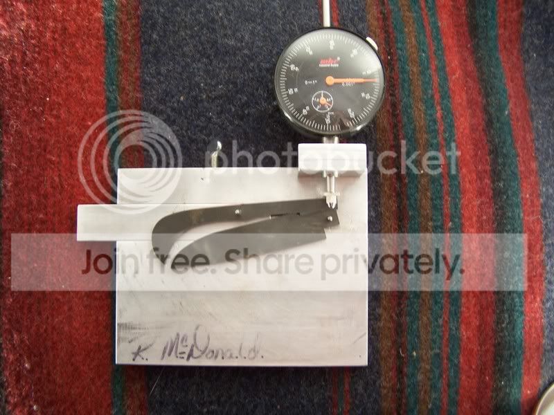

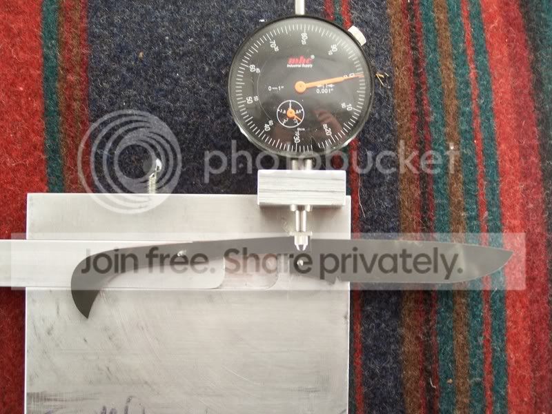

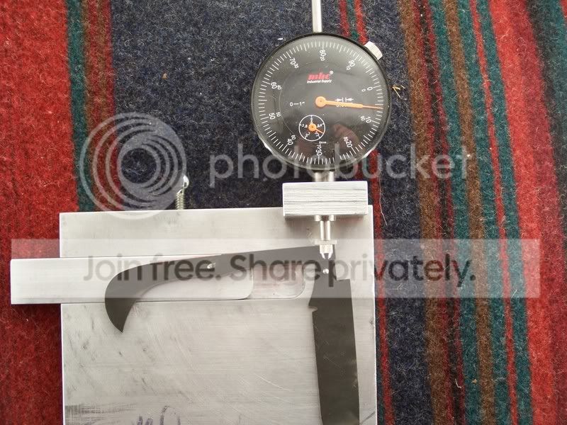

I like to start with the blade in the open position and call this zero. It's fairly easy to adjust the others to fit then. I cheat and use a guage. 0 in open, .010-.015 in half and .005 in closed works every time.
Thanks for the help guys. I knew I could adjust the bottom and half stop easily. And in fact on my test run things were even. Then I ground the kick quiet a bit to drop the blade down and that seemed to lower the spring in the closed position as well. I read in one spot that grinding the kick too much can lower the spring, but haven't seen it mentioned again.
I am saving up to snag one of those guages. I don't have the tools here to build one.
John if i'm not mistaken he leaves them like that so that he has a hair bit of fine tuning to do once the blade is ground and preload is set on the spring. I think he gets them all to 0 before it's all said and done. Of course I could be wrong, but that's my thinking.
Yep your right Ryan, when you load the spring, or put tention on the spring and blade the whole thing changes a bit. you cant load them on the dial so I compensate for it. by leaving some in places on the blade so I dont have to change the spring at all. I just remove what I need to on the kick and halfstop. just remember for every .001 you take off the blade the spring will drop .002 or more. this may not happen to everyone but it seems happen to me every time.
:confused::confused:Rusty, you are saying "0 in open, .010-.015 in half and .005 in closed works every time".
But the indicator read out is different
