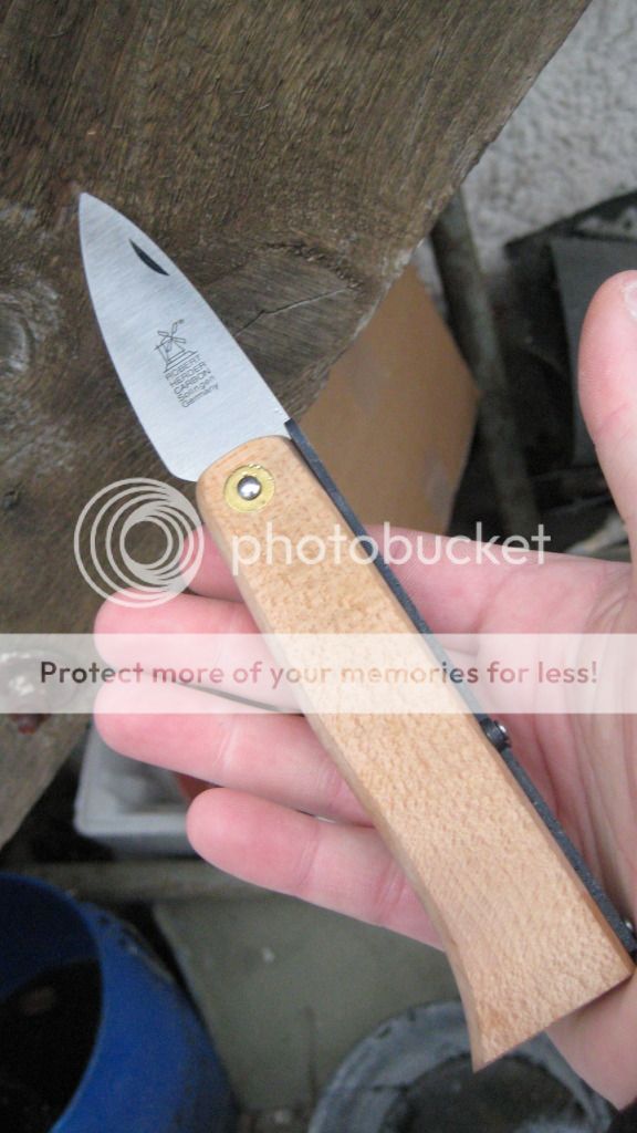

Some time ago I read on a german knife magazine, that there´s a traditional knife from the german/belgium border area. It´s called a Lierenaar. I was interessted immediatelly, as usual ;) I ordered one for a small prize on a big dealer in Germany. I must say, I´m a little impressed by it functional design and its simple construction.
A little history first (which I got out of this magazine):
This knife was first shown up in the 18th century. Propably the town of Lier (Belgium). That´s all about its history ;)
It has a centered tip blade; a little like a leafshape blade. The handles are beech and are completelly untreated with any wax or whatever.
Robert Herder, Solingen is the cutlery that makes this nice knife.
The special design is a friction-backlock-folder. Here is the knife opened

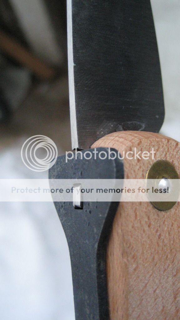

... and here closed (as you can hopefully see, there´s a little "notch" on the blade which is closing the knife on the two "wings" with the hole in it) A simple, but very very useful lock. The Lockbar is tank of spring which need two hands to get deployed.

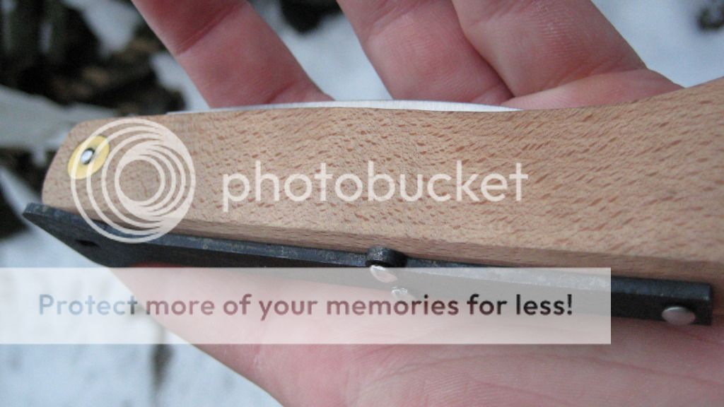

As you can see here, the "spring" is just pinned on the handle and doesn´t do anything else than let the lockbar on the notch of the blade
The F&F isn´t the best and a little coarse, but I think it´s a nice friction folder to carry around for heavy cutting tasks. The blade is of carbon steel C75. It weighs roundabout 80 grams.

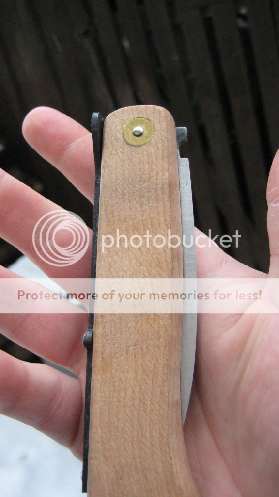

rune - I think you got me a little wrong (bad english skills - sorry). The knife doesn´t need a hand to get locked. The blade slips into the backspring easily and then it keeps the blade like a tank. To unlock you definitelly need your hand. Not just one finger, mostly three. The spring has a great tension.
