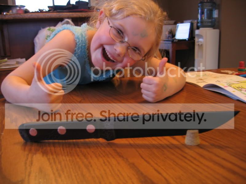

This was the last knife I sent to my wilderness skills mentor. (almost 4yrs ago, this month.) It was only meant to test the blade so the F&F are rough. He refuses to send it back or receive a new one, for fear of losing the best knife he has ever tried to break….. That means a lot to me. It didn’t even come with a sheath but he said it fits in an old BK&T one. (that is embarrassing)
Modeled by my lovely Blue Spotted House Monkey…
